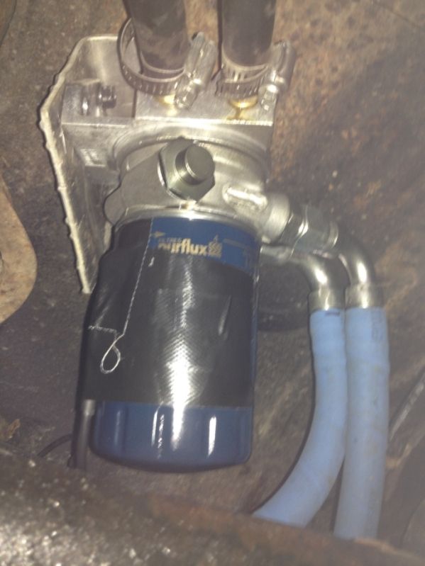

andy198712
Posts: 2433
Joined: Wed Apr 13, 2011 1:01 pm
Re: Temp sensors ect
Post by andy198712 »
just ordered something similar to ductape to my filter ;)
andy198712
Posts: 2433
ghetto but will see if it works!
andy198712
Posts: 2433
Seems to work ok, I think it gets heat soak at standstill but then so does the oil so hard to tell, but it works and responds fast
