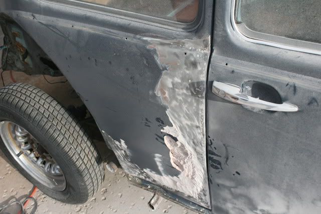

I call it Project Oddball, because I'm the only one in my family to build up a Street car, Dad and Brother both have Bajas. Now for Pics.
The trunk space, needs some work:

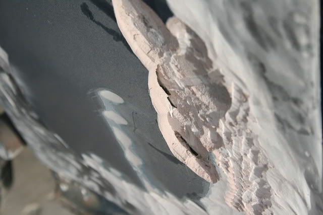

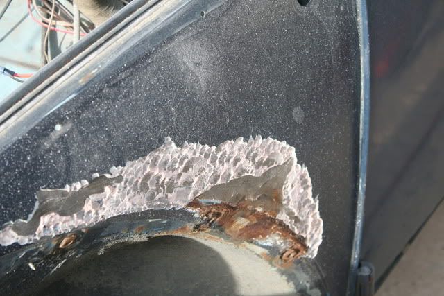

Not the full extent of the Evilness that is Bondo: (The whole front end is getting replaced)
The Bondo Infestation is over 1/2" thick in some places: (Also will be replaced)

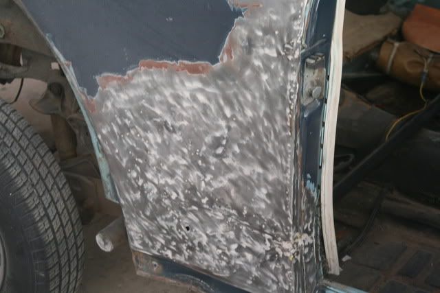

The Drivers Front:

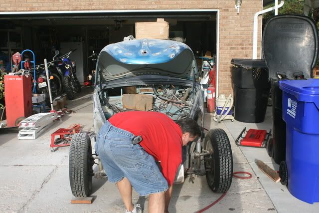

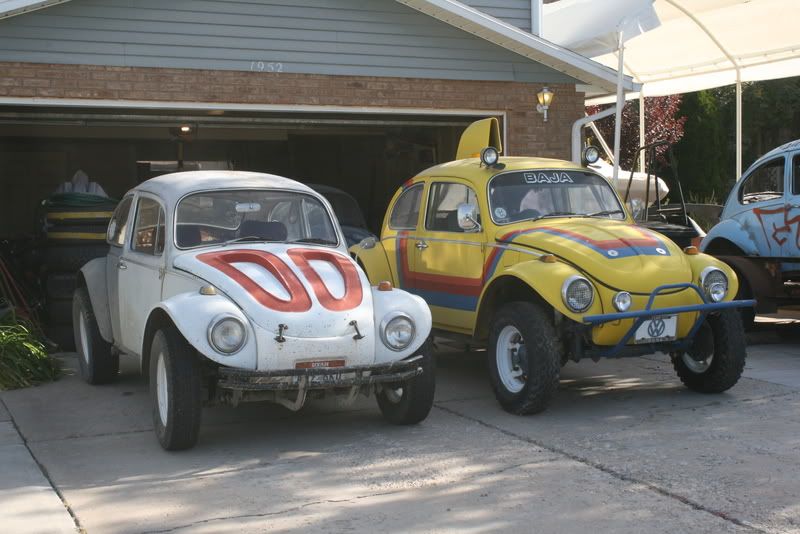

Dad's (BAJA-IT) Good side:
My Car's Good side: (Literally, the only good side)

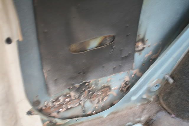

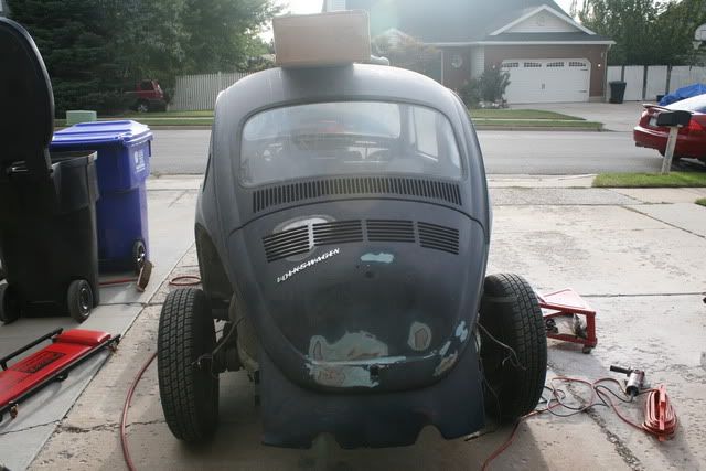

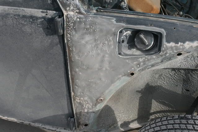

The Passenger Rear when I was finished removing the infestation:
The inside:

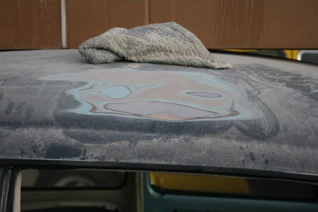

A little bit on the roof, but used correctly here:
It's a '72 Standard, and it will look similar to this when I'm done, the three white stripes probably wont be on the finished car: (Concept created by a friend)

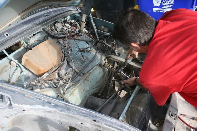

Finished removing the Bondo from the Driver's front today, Should be the last De-Bondoing I have to do (except for sanding on the roof). Hoping to take the body off on Saturday.
Going to take care of the pan (new battery panel, patch holes on the beam, CV boots, and rear shocks, then POR-15 it).
Then the body (replace Passenger Heater Channel and rear Quarter, rear apron, the whole front end).
Then Paint.
And then the fun begins :D

BAJA-IT
Posts: 2046
Joined: Tue Oct 07, 2008 5:02 pm
Post by BAJA-IT »
THANX FOR THE NICE SHOOT OF ME!!! :lol: :shock: :(
I know, that really is my best side. :roll:

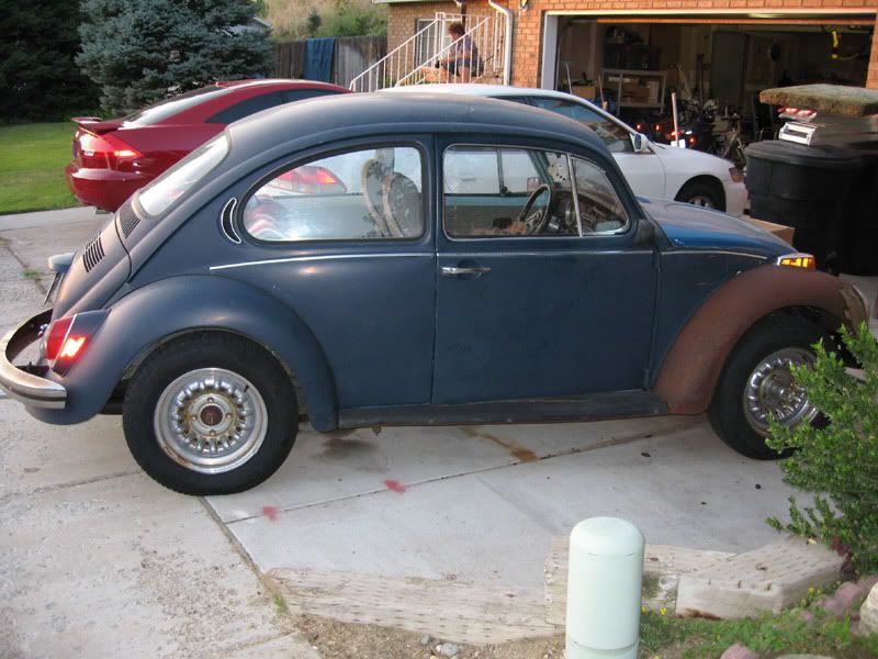

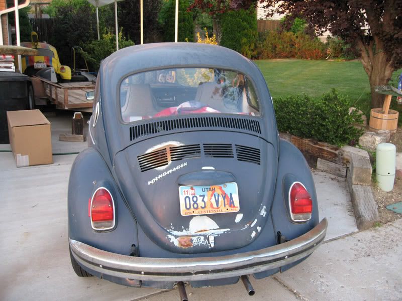

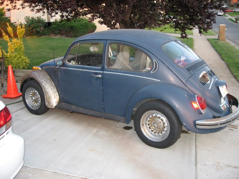

Pictures of what it looked like when I started.
The plans for it are shaving the Turn Signals, moving them to the bumper, and Trim (mostly cause it wont look right with the paint). The inside will be painted white like the Lower body. Pop-Out windows in the back. My 1641 (already done) will go in it to get it running. Then the real fun begins. :D

Better picture of the Yellow car (BAJA-IT's):
He's had that car since he was 16, in 1976. The other one is my brothers. Mine is in the Garage. Light blue one is my parts car.
