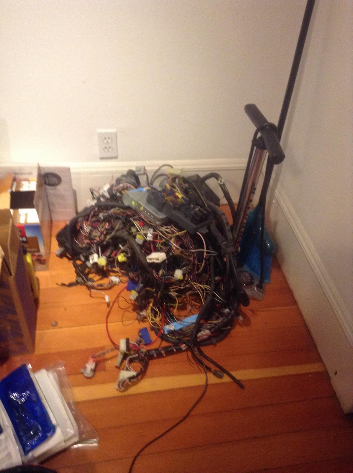

Wiring the stock ecu. The wiring harness can look like spaghetti when first opening everything up. OBD1 and OBD2 have some different requirements needed for inputs. Adaptations are also needed when running certain JDM engines on USDM wiring harnesses.
OBD1 needs the least amount of inputs. There are several guides out there to help with this. Search on shoptalkforums.com or a guy who went as busaru - website and YouTube. That covers the obd1 conversion way better than I ever could.
OBD2
Removing the harness This task can be done in a couple of hours. I have some videos on YouTube showing how to do this.

ECU. Located under the right foot area beneath a metal plate.
Those are all the relays and connections you need from within the car.
Removal.
Remove the dash. Most of the dash is held in with Phillips screws, and some 10mm sockets. Remove the OBD2 port from under the left side under dash area.
Remove the bracing and framework for the dash. Most of it is held with 10mm bolts. There are two bolts that require a special socket. It might be easier to cut the metal off the area than to find this socket.
Locate the connections mentioned above.
Remove the heater, AC, and fusebox. If you can't get the large metal dash bracing out of the way, pull it forward enough to start cutting and bashing the AC and heater boxes to pull it forward.
Cut the wires you don't need. This is tricky without pictures. The ECU wires head into the engine compartment via two rubber boots. Keep everything that goes into those boots and sort it out later. The loom will branch off to the right just before the ECU wires exit to the engine compartment, cut those wires off. The dash and heater control wires are not needed, cut them. Anything to the left of the green connectors, OBD2 port, and fuel and main relays is cut, these mainly go to the fusebox. By doing this cutting, ⅓ of the wires will be removed already.
Remove all connections from the engine compartment (see what you need and what you don't need). Push the two rubber boots inward towards the cabin.
With the AC condensor and housing pulled forward, feed the wires toward the ECU and pull out the harness.
Loosen the left fender and pull out the plastic wheel well
Remove the fan relays (4 relays next to main engine relay) or just grab the whole fusebox. Grab the battery cables too if they look good.
Cut and pull as much of the alternator wiring (white wires) as possible from under the wheel well. The wires go back to the fusebox near the left side of the footwell in the cabin.
ECU wires you need from in the car (check pin out for exact wires):
Vehicle speed sensor
Power on (Pin 1 and 2 wired from main relay)
Backup power supply (wired always hot)
Fuel pump relay control
Engine speed output (for tach)
Radiator fan 1 and 2
Neutral position switch (some need to be grounded, some open, rev limit will be 4.4k if wrong)
OBD2 pins (should be 3 of them, two others are power, one other is green test connector)
Test mode connector (to green plug)
Starter switch (to starter on)
Ignition switch (ignition on)
ECU wires you do not need
Fuel tank pressure (any of them)
Fuel temp
Fuel level
Rear O2 sensor
AC relay control (unless you plan to run AC)
Vent control solenoid valve
Rear O2 sensor heater signal
AC switch
AT diagnostic signal (if equipped with auto tranny)
Malfunction indicator lamp
AT/MT identification (cut and the ECU will read manual)
Some wires diverge off into the areas where you don’t need them (right side of car), but still have other paths that end in the engine bay. Clip off the direction you don’t need them, and keep the ones going to the engine.
Engine plugs you need
3 Main pugs to engine harness
Atmospheric pressure sensor (not included in some manual cars, debatable if needed with non turbo MAS)
Starter wire (back to ecu for sensor, can tie in with old system)
Ignitor
Front O2 sensor (make sure you know which one is which)
Mass airflow sensor
Alternator wires (plug and top post wires)
Fan relay assembly (if you want to use it, it is skinny and has 4 inline relays)
Engine plugs you don’t need
Rear O2 sensor
Air conditioner control
AC sensor? On right side of engine bay near the firewall.
ABS sensors (keep a sensor to use as a VSS)
Transmission wires and plugs
Brake fluid/pressure
Wiper fluid reservoir
The atmospheric pressure sensor tells the ecu exactly that. It is a must for turbo engines, and needed for MAP cars as well. On cars equipped with a MAF sensor, it may not even be included if a manual. Most people say it is not needed, and only helps when you have large changes in altitude.
The OBD2 port has one wire that branches off into many other connections. Cut this wire and find its connection from the pin out. The wire may be a different color from the ECU, but the other two will be the same color and can easily be found with a pin out.
The main relay shares its power wires (2) with the fuel pump relay, OBD2 port, ignition on, and main ECU power. They should be wired together with a 15a fuse.
The output power wires on the main relay split off and goes to the engine bay and ECU.
The vehicle speed sensor requires an input of around 5 volts, it can run the ABS sensor since the voltage is the same.
The fuel pump relay may have power coming from the ECU for the switch. If that is the case, ground the other wire that controls the relay. Or run the wire straight to the “power on” wire and ground the other.
For some reason, sometimes the fuel pump relay ground wire from the ecu wants to see ground. It may need to be grounded.
The neutral safety switch may vary per ECU. An automatic ECU and a manual ECU may run the same as each other with no changes. If it is wired incorrectly, it will limit revs to around 4400 RPM.
An alternator dash wire is needed to be run to the alternator from a small power supply before starting the vehicle. If the alternator does not receive a charge from the battery, it will not function and act like a dead alternator. The wire to be charged is the small black wire in the 2 prong connector on the alternator.
Late model Japanese domestic market wiring harnesses are the same as the U.S. WRX wiring harness in most cases. The earlier ej20g and I believe the ej20k engines are a 4 plug ecu and are not compatible. Active valve control system (AVCS) can be wired into a non AVCS system with an adapter kit for around $200
Fan relay wiring Use the two wires from the ECU to control the fan relay. The stock relay system is more complex than it needs to be. Rewire the system so you have one fan with one relay. The relays in their box are already fused and get their power directly from the alternator wire. The two copper tabs are the power wires, the two silver color tabs are for relay control. They are easily configured with one fused power in, one power to fan, one ground, one from the ECU wire (power on). You will be left with two extra relays.
