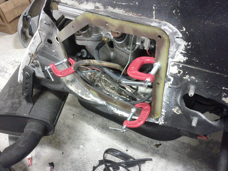

So, over the last few weeks I only was able to get my side access hole fully cut, cleaned up, mocked up and ready to weld. I'll get the other side done, then weld them both at the same time... (I hope.)
So for the fuel rail hitting I plan to also cut my fender in the same place that it overlaps with the current cut out. Then I am going to put some rubber between the fender bolts and the bolts/access panel.
I've denoted that in one of the images below with where the rubber will go.
extra cuts and mocked up access panel
This image shows what I plan to do with the extra hole that is outside of the frame.
green = rubber
lightbrown/yellow = contact area of fender and body
red trapazoid = area of fender I will cut out.
panel

What's the metal template from?

panel wrote:What's the metal template from?
Its actually an access panel kit built specifically for the bug its from
http://www.hookyspanelshop.com/
click the How to:
The panels are called HiPacs, Shipped here to California, I think the cost was about 128$, He is in the UK.
I can't rant enough about them they are really an excellent product!. If anyone has dual carbs / throttle bodies, or you just want to change spark plugs easier
Get this! well worth it. :P
so some details on the panels...
The panel itself (not shown) is a nice gauge stainless steel,
The frame is about 1/8th thick with holes drilled and tapped. It also
came with some nice SS screws
