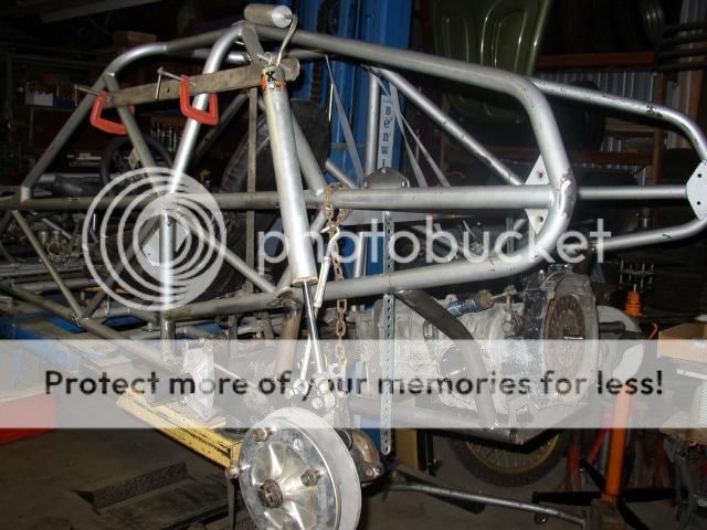

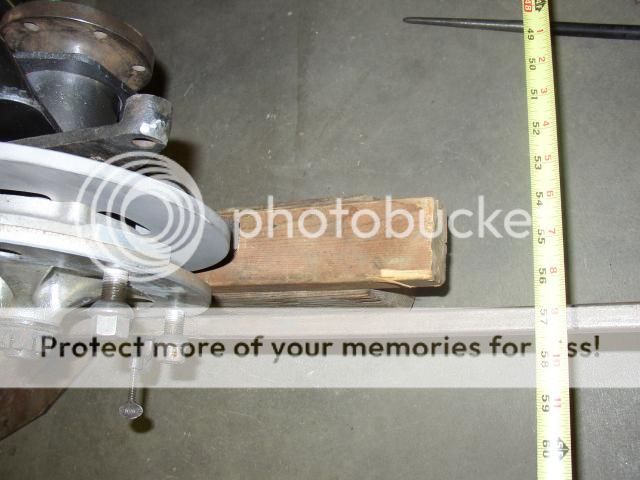

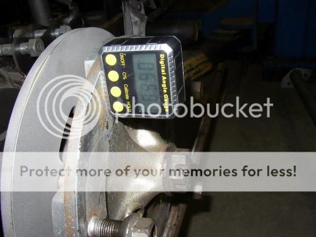

more rear alignment before final welding of trans mounts. Camber and toe set at projected ride height.
I set toe at 3/8 inch toe in. What are you settiing yours at?

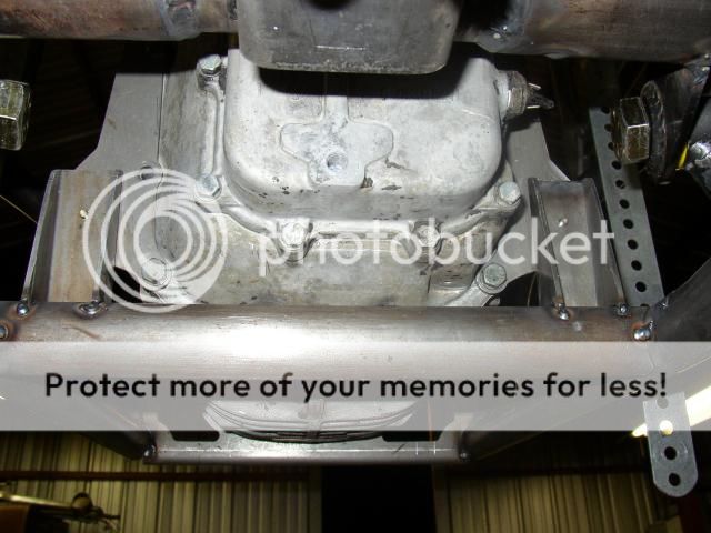

Trans mid mount fabbed in
Mounted a 14 " fox shock mid travel to see where top mount will wind up being located.

madmitch wrote:Image[/url]
I think this question got lost?
That seems to be a lot based on what I have read? Most of what I read is 1/16-1/8" toe in, some even say a smidge of toe out at ride.
That amount of toe will get exaggerated a bunch as the wheel travels through its arch especially if you are using stock geometry pivots. Cycle your hubs up to full bump and measure it again, then do it down a full droop, you will see what I am talking about. Then think about what will be happening at speed. You will have what is basically "Bumpsteer" happening on the rear. The thing will be trying to steer itself all over the place with the back tires.

You are correct in the toe change during rear suspension travel Darrin. If my memory serves me right it toes out on compression and in on droop. Keeping in mind this is a short course setup I believe a little more toe out will help on corner exit then rear suspension is slightly loaded during acceleration. I may be wrong too but may be a good topic for discussion.

Been a while since I had my head wrapped around this entire concept on my car. I went back in my thread and through my notes but cant find where I measured and recorded that stuff with my old arms. I just know that when it was explained to me and I cycled mine is when I decided to make the changes I did. You can probably verify your theory pretty easily by cycling things on yours and measuring what it is actually doing where in the cycle. And then Yes definitely set it up for the short course style stuff you will be doing with it. Probably make yourself go crazy thinking about all of it too :lol: lets see..... does it toe in under breaking or or toe out? In or out under acceleration ect?
