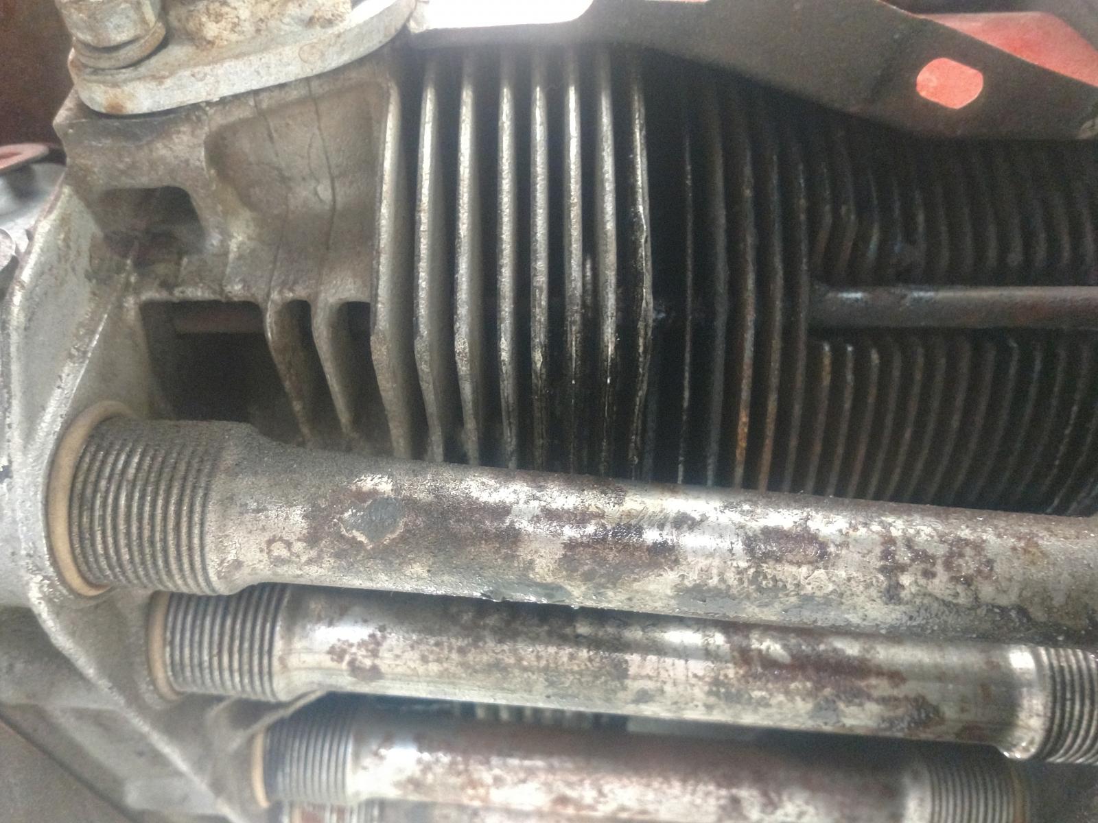

I had it on the lift still so I put it back in the air for a better look at the leak. Can't tell much from the pic but it looks like it's running down and around the cylinder near the head. Can't really leak oil from between the cylinder and the head so it almost had to be coming from above. Only thing that's weird is the last pic I posted you can see the oil is black as night and I had JUST changed the oil minutes before that. So that's kind of throwing me a curve ball. Unless it's picking up soot that is on the cylinder before dropping on the ground.

Didn't split a cylinder did you?

I don't think so. I just did a compression check recently and everything looked good.

Chip Birks wrote:Didn't split a cylinder did you?
Cylinder failliur was my frist guess too

I will do a compression test again and see what I get.

:( :cry: didn't u just re-torque them heads?

Yeah. But I did the compression test after that.

just looks like 'seeping' to me? push rod tubes are dry looking.
Is it leaving big puddles? Mine leaks on the sump plate and a tablespoon of oil on concrete spreads out to look like a 'Gallion' :lol: :lol:

Well it's not a ton, but it's too much for me to take.
