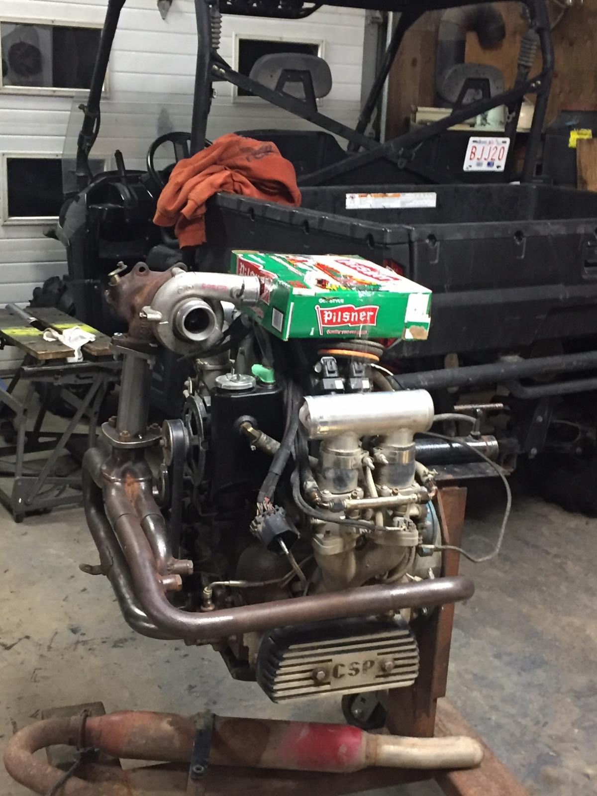

I will jump in on this thread . Probably the right place for it any ways. Apologies for shamelessly coping it from another site :oops: But man this typing WELL HERE GOES
Doing my annual clean,inspect,fix and upgrade this year. I was messing around with mocking up a turbo to my already built 2180. Picked up a td04 turbo and made some flanges and got a good idea of air water inter-cooler and plumbing. I will now have 2 different exhaust configurations from the collector flange back 1 N/a and 1 turbo. I should be able to swap my existing intake filter plumbing set up to the turbo plumbing quickly and easily.
Also Part of this years upgrades is to replace the mag case with an aluminum case. For my application I thought this would be better. I do beat on this car pretty hard.
In looking for a new case the local VW supplier did not carry one with a sand seal in stock and I would have to order another or cut a new one. Meanwhile I happend to find a new never used 92 x 86 Autolinea aluminum case that has the sand seal. Turns out it got piston squirters installed but never built or cleaned up. I picked this case up for about the same $ as a new case from bug shop win/win I hope.
Previously I was running a Engle W110 and 1.25 :1 rockers with swivel balls. And the car worked real good for its purpose What I am thinking of is trying a newer style cam With a good quality ratio rocker like CBs 1.4 and perhaps some behive springs ??
What I would really like is options for a real good bottom end torque cam that might stretch the upper rpm out a little. I would run this naturally aspirated this coming season while collecting the remaining water/air intercooler plumbing and water/meth injection parts
So what do you think any thoughts on a cam choice ?

And now for some pics of what I am tinkering with
rear of car and naturally aspirated air filter and plumbing
fuel injection mod
Pruposed Turbo exaust and air to water intercooler plumbing planning
mounted up the turbo
reclocked it and turned it around
Mocked up to same size cardboard air/water intercooler and inventoried connections needed also made the T connection out of 2 1/2 exhaust pipe sorry no pic
I use the car both on and off road. Alot of the times OK more often than not it takes pretty aggressive launches turning 32x11.5 tires so I am sure its not easy on tranny's or cases Embarassed It also does have very good low speed manners since fuel injection and I really need to preserve that with the new cam.... for up hill starts, technical driving like around trees or objects , hanging off some mountain trail and muddy starts where a lot of wheel spin might not be wanted
So yea lets hear it cam choices

W120 with 1:25's or a FK 8 and 1:4's :wink:

If the cam you have works good now why change it???
With the W-100 cam I have and stock heads my power falls off at about 5000-5200 rpm.
I would think with a Baja you would be better off keeping the cam on the smaller side for more low to mid range torque instead of revving to get your power.

^ In the case of a street/offroad car, I agree with CB's comments. I'd also say I reckon you want to keep those revs down for the sake of your engine case too. It's all very well if the car is mostly built for short blats and quarter mile sessions, but if you want many reliable offroad miles, your better to keep your revs down. It will also save your valve train.

Stay small. Keep that power down low. If it ain't broke, don't fix it. The turbo alone will give you more rpm.
