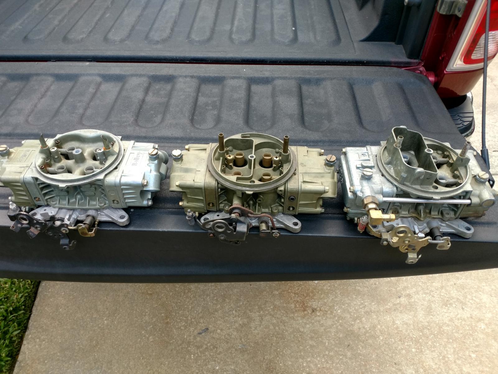

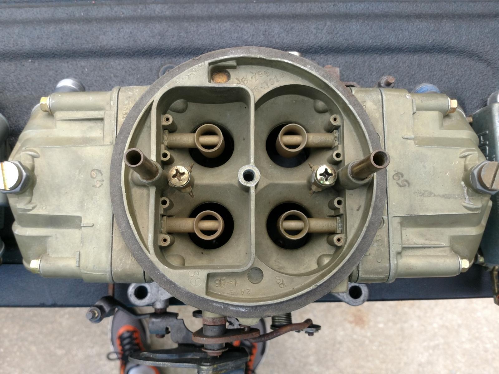

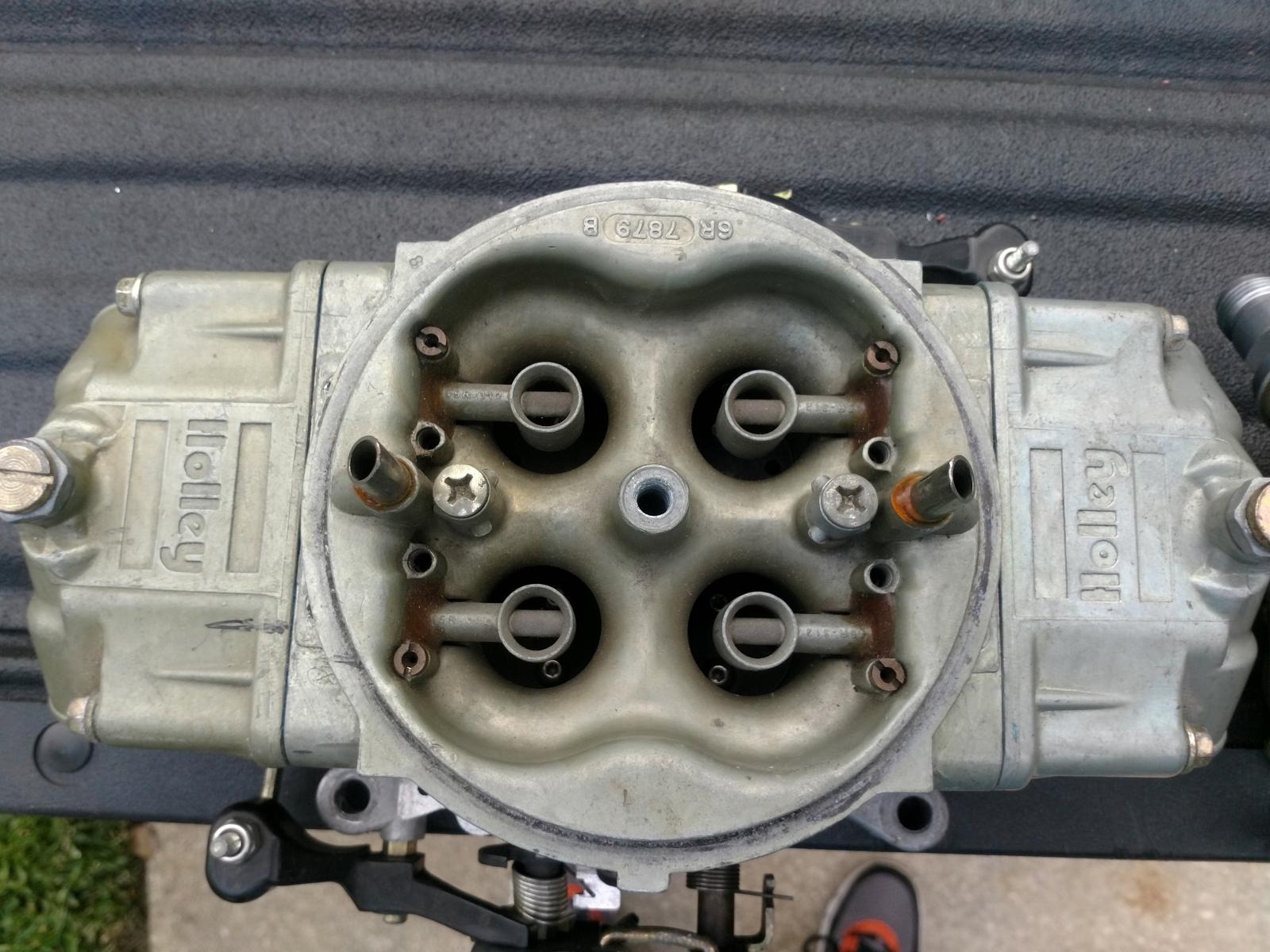

I was out just looking over the carbs. I have 2- 390 cfm mechanical secondary and one 450 cfm mechanical secondary carbs. One of the 390's has screw in air bleeds and one doesn't. The one that doesn't looks to be a bit older design. 4 corner idle will be new for me. As well as screw in air bleeds. I think thats the one I'm going to run. It is furthest left. 450 is on the right and it is the only one that isn't a double pumper. It's what I have been using.

I guess the good thing is that the TD04L-13T is capable of 394 CFM so it will match the carb.......
I researched the 390 Holley many years ago when I first wanted to go turbo. MOLooker had a thread on how great his setup was.
I think he got up to either 150 or 180 hp with it on a 1600 single port.
Those are a highly tuneable carb so you should be able to get it to work.
I'll follow your progress to see what I missed.....
