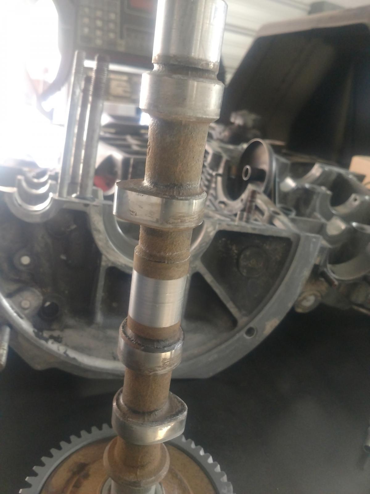

Post by buguy » Sat Jun 09, 2018 6:24 pm
I pulled the short block apart today and threw it in the parts washer. I was amazed how light the block is on these once you get the crank, cam, and fly wheel off.

Post by buguy » Sat Jun 09, 2018 6:26 pm
