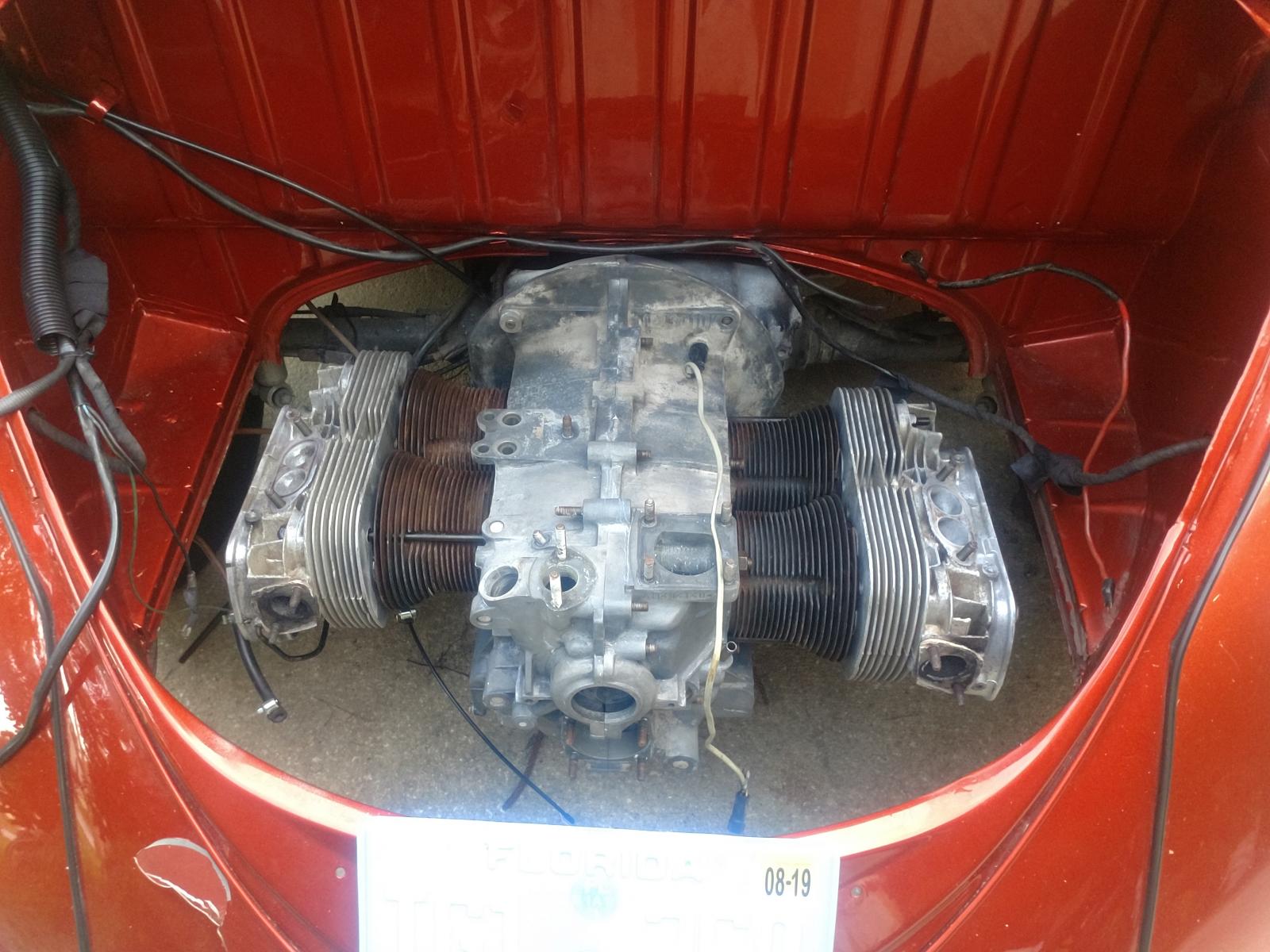

Now that's the way to put an engine in! Just grab it and plunk it in from the top!

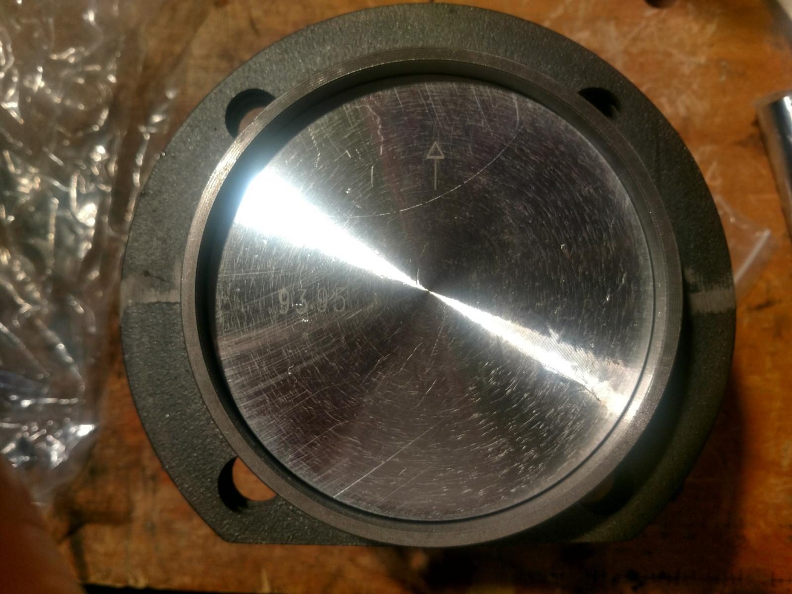

Damn. Ordered my p&c Saturday night and they made it to my house before I did today! From Canada! Cip1

Brought the new p&c to work so the guy can measure them. Or even better show me how to measure then correctly. Hoping they don't need work. Going to check the rings too. I've been reading some of the AA rings don't spring back when spread.
buguy
Posts: 1585
Location: Port Orange, FL
Re: 1600 turbo build thread
Post by buguy » Fri Jun 22, 2018 11:17 am
Well the piston gap looks ok.
.0027 on top
.0030 on bottom
Ring gap on the other hand is tight.
.0012"
Not sure what minimum is yet for a turbo but certainly not that tight.

Post by Chip Birks » Fri Jun 22, 2018 12:15 pm
Ring gap is .0012? Holy cow! I just opened mine to .023! A little on the big side, but I also plan to run a ton of boost.

Post by buguy » Fri Jun 22, 2018 2:15 pm
Yeah and they actually tighten up toward the top of the cylinder. I saw more like 0009 at the tops of the cylinders. I'm taking the ring gapper home with me for the weekend. Not sure how far I want to open them up yet. I was thinking somewhere around 0014-0016
My guy said he usually multiplies 5 times the bore size to get the ring gap. So I'm at 3.704" so times 5 is 18.5. Seems a bit wide to me.
