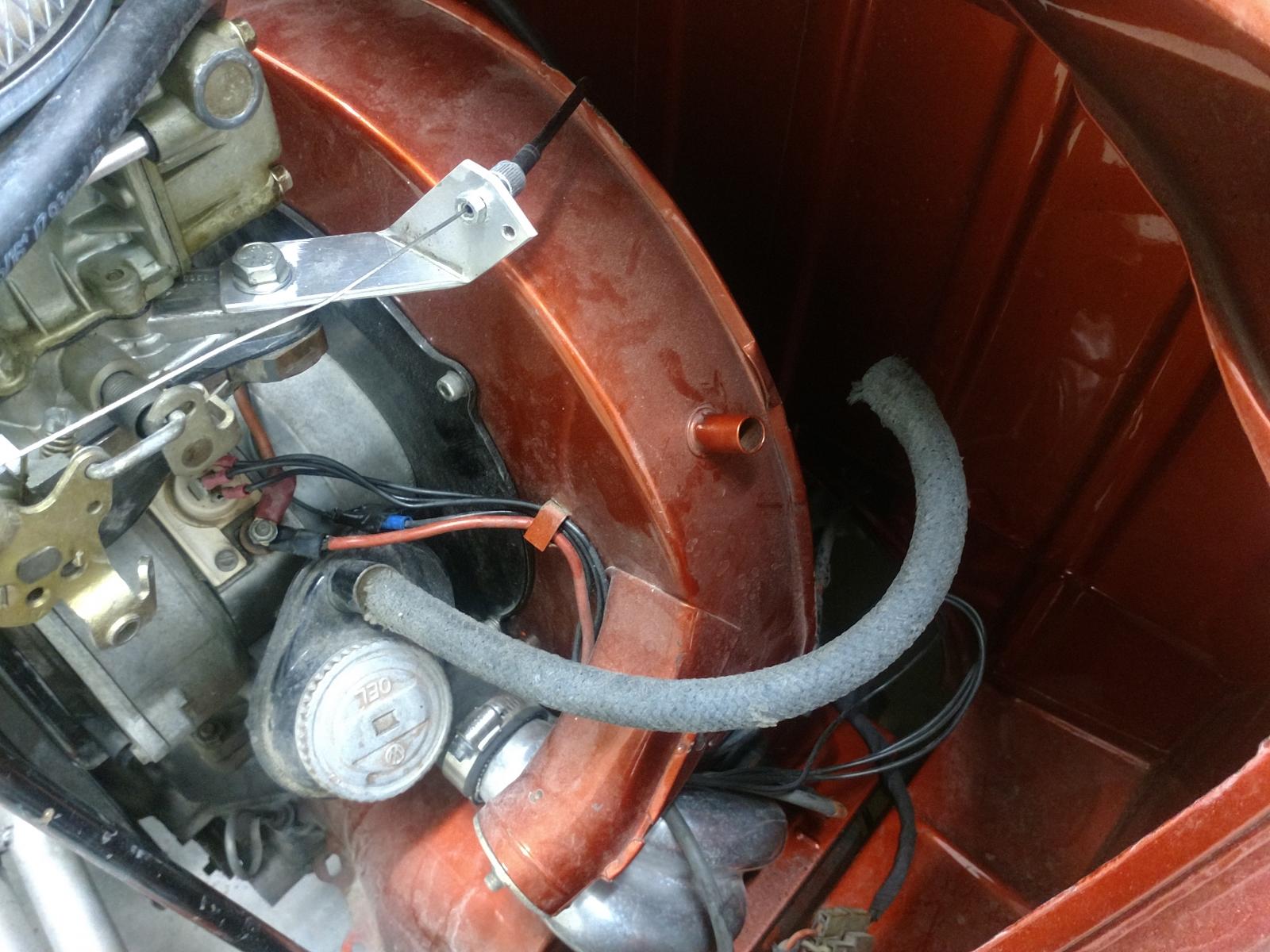

Thanks for starting this thread. It reminded me to examine my own leak. Mine seemed to be just fine at idle but once you spin it up it leaked real bad. My valve cover gaskets are old and I just had the valve covers off to check lash. I didn't really think much about it before but when I put this engine in there was this hole in the fan shroud and an opening in the oil fill. They were about the same size so I simply connected them. Pulled it off the other night and was shocked at how much air that nipple in the fan shroud put out at rpms. It was really filling the valve cover with air and pushing it out the top.

What the heck is that!?! That's nuts! Geez. Block that off and get a catch can and breather.

I found what looks like a carb vacuum line block off and put it on the fan. And we recently got a spool gun at work for welding aluminum so I'm going to try to make a breather box. From the pictures I found it looks like when it was stock it went to the carb. I didn't get a carb with this engine so I didn't know that at the time.
