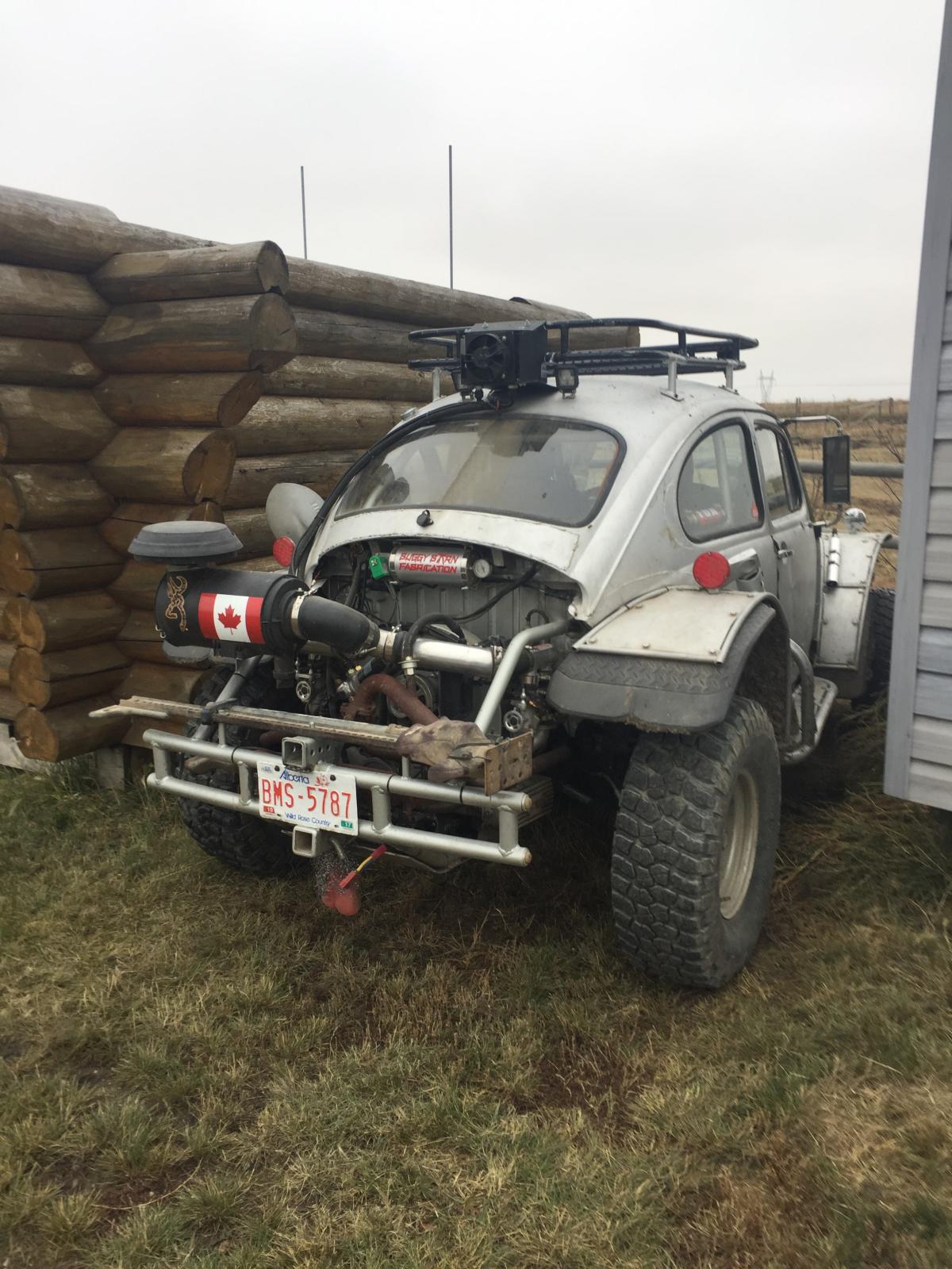

UPDATE
Ok Guys picking this one back up after sitting on the shelf for a while.The delay was I changed my suspension set up to a full coil over shock set up and went to a 4' longer front arm after I broke my 2 1/2" over arms. Picked up a new alum case installed Porsche piston squirters and went to a Scatt external oil pressure relief valve. As well as a Mocal temperature relief valve and a Morroso 1 1/2 quart oil accumulator. Also changed the cam to a Webcam 86a and Scatt 1.4 ratio rockers {so quiet} i also changed my throttle linkage from a CSP push pull to a Synclink throttle cable system and seems to be working very well Put a couple thousand kilometers on this new motor configuration. Seems to be rock steady with good oil pressure and temperature control and no longer suffers from heat soak on the highway. I can now go on extended highway trips to and from the trail head. I also went to a 091-1 side shift trans out of a water boxer van from the 002 type 2 trans I was using. Had to do a little chopping cutting and modifying to get it all to work with my new Cableshift shifter has proven to work very well.Here is a link to that and more on trans later https://www.shoptalkforums.com/viewtopi ... 6#p1259886
Found some change in my couch and now have a little turbo slush fund and about to pull the trigger on some turbo plumbing ,Air to water inter cooler a coolant pump
Changed my plans a little on the turbo plumbing scheme. I will come from the turbo to a 2.5" ducted Air to water intercooler over my shroud to a 2.5"x 2.5" "T" splitter which will then go into two 2.5" x 2"x 2" "Y" splitters. This is my new shopping list.
https://www.frozenboost.com/shopping_cart.php
I found that if I mention https://www.frozenboost.com/ and post a link and /or post a picture of their sticker they will give you a permanent 10% off discount. happy Happy . Might come in handy to some one else who is shopping for parts
first I will get the https://www.frozenboost.com/ Air to water intercooler, pump and plumbing and plumbing bits here and mocked up. Then i will decide on a coolant heat exchanger and start to figure out what i need for the meth injection and how I will tie it into the MS3pro stand alone ecu. Need to do a little research on Electronic boost controllers wastegates and blow off valves.
I have also been following a face book page on watermeth injection lots of info opinions and suppliers
https://www.facebook.com/groups/366718120329010/
Was also very interested in this product has any one used one of these or looked into it ? seems very interesting
http://tunernerd.com/
And some pictures
And a video if it works
There you have now been updated HaHa
That's all till I get some bits and bobs orderd and bolted on
later

MarioVoletta...Thanks for the compliments and encouragement. Motor seems to run real strong I have put a couple thousand hard kilometers on it last summer and the previous fall and winter. I will probably need to call you. I seem to have a cam fault last time I looked at my logs. But first I need to make sure I have continuity from the MiniCam Sync up through the wiring harness and bulkhead connector to the ECU. After that I will have to figure how to test the MiniCam Sync
Okay so last week I placed my order with Frozenboost for an intercooler ,a bosch pump and hopefully most of the reducers, bends ,joiners and injection couplers that I will need. I left out the radiator and fans and will have a look at that later when I get every thing in place.
Now I will have to try and figure if I will need new injectors. Right now I am running 30# injectors
Also need to figure what I need for a blowoff valve for the set up. Any words of wisdom or insight ??
And an electronic Boost controller what would be good for a MS3PRO ??
Also look at a MAP sensor I don't know if the GM one I have in there now will read positive boost pressures{just looked and it is a GM 1 bar sensor}
I am also going to measure before and after intercooler temps then IAT temps just before the throttle bodies or perhaps I could sample them in the intake manifold. I would wonder about heat soak there though. just wanting to know the difference after the water meth injection from post turbo temps
And thenthere is the meth injection "canoworms" I think I will go with the Devils Own pump. A low level switch and maybe a flow sensor ? Much research and poking around the interweb any words of wisdom here would be appreciated.
so that is where we are at now
Pictures to follow when I get it mocked up
thanks for looking

Terry , what's your budget for the BOV? We love spending other peoples money
- Posts: 4719
Re: Turbo this baja discusion
The Saab 9-3 turbo BOV is cheap and on Ebay. I've got many miles up to 25 lbs on mine.
I paid $12.00 for mine if I remember correctly back in 2011.
Here's a cheap one......grab it before it's gone.
https://www.ebay.com/itm/94-05-00-98-97 ... SwXk9carPg

Well it seems I will be the new owner of a Saab blow off valve !!! Thanks Clonebug

Ok so got a package from https://www.frozenboost.com/ The air/water Intercooler looks real nice got a Bosch water pump looks good and the inline water fill seems like it will do the trick. Tried to mock up my Turbo plumbing how I had Imagined it........and it was a bust. So now sending back a couple Y conectors and some 45* angles back and exchanging them for a 180* bend and another 90* bend. Now I am back to my original plan haha Ordered up the Saab blow off valve that Clonebug linked me to.
Clonebug or anyone else know the size of the Saab Blow off valve that goes into the charge pipe seems I can get those in 1" or 1-1/4" . No worries if not should have it in my hands in the next week or two. Just wanting to get another order in for the radiator ,replacement 180* and 90* bends. Then I will need to figure the best boost control strategy for ms3. Thoughts on that would be greatly appreciated. Well that is all for now. Happy boosting hope to join you before not to long haha

Should be a 1 inch hose.
Boost goes into the side......outlet is the bottom.
Doesn't seem right but that is the way they work.
I used a cheap V-8 Valve cover breather filter on my outlet because these valves are technically a bypass valve and will be open at idle and higher vacuum conditions.
