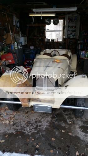

Well V dub engine engine been way mistreated who ever did that engine not only pinched a main he backed it off and pinched a second one! poor thing.
So ran across a 91 subaru on cl for 600 got it for 450, has 142K on it. Has front end damage did mangle rad but just barely got to engine, runs and drives.
Figured would go that route ordered adapter.
Now need to start cleaning and cutting the subaru get the engine out and mounted so can started laying out the wiring harness, and clean up the poor old ss100 stuff.
The good thing is that it is there just needs to be cleaned up re fitted was never put together right to start with had lots of air flow all the seams were never sealed just assembled. Nothing between the body and floor pan so just need to do it right.
The bad no, idea who built this kit, can't find any information on it. Used to that though if there is something that there was only one of I am known to get it. :D
If you have any information on it lay it on me would be most appreciated.
