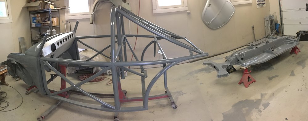

It's time to get it together

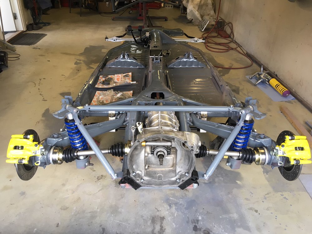

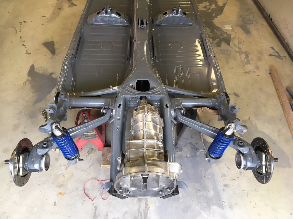

Rear end has got some progress

Going on. Unfortunately some ordered parts were wrong and delayed, so just matching parts together. Handbrake, brake pipes and engine to finish this end.

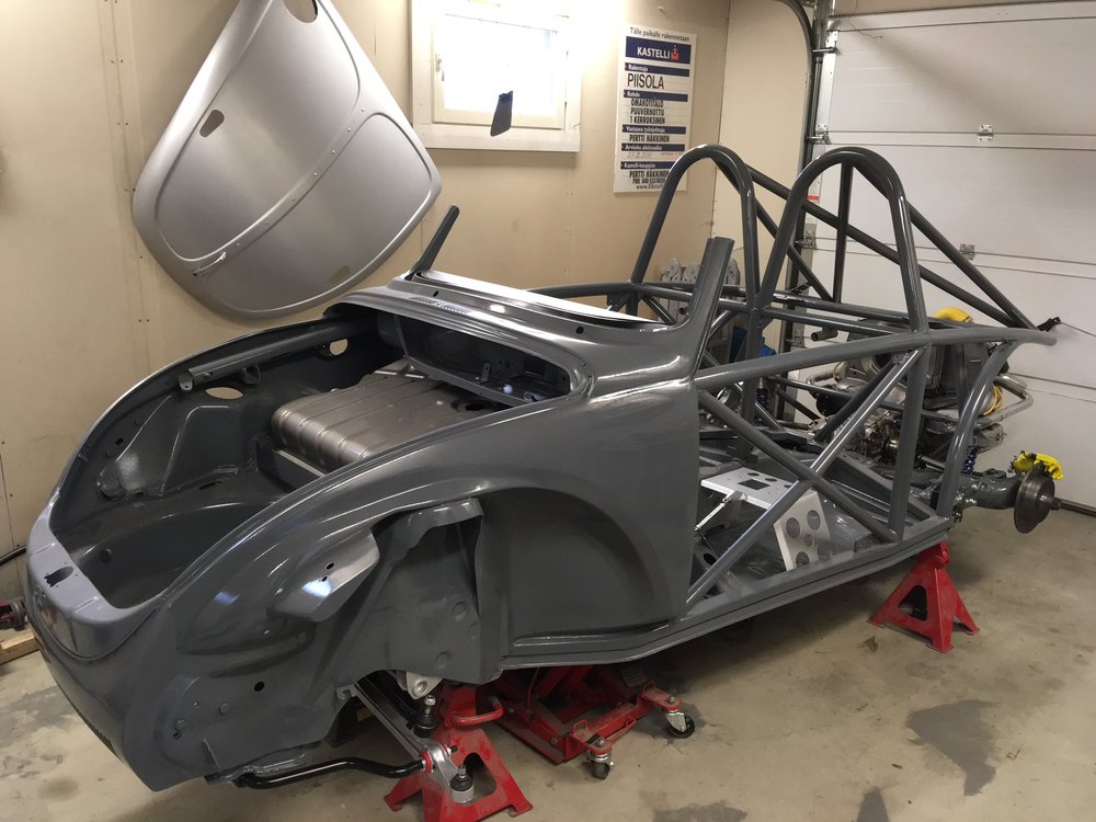

Tomorrow we have "weddings" and the body will be laid on the chassis.

Pete, That engine is balanced blueprinted 1835 and now for the registration it is fitted with a Solex 34 (chinese copy)
Heads are 92 CB:s, but cam is mild for this carb. The first summer is to drive out all problems and the next season is for fun.
Some pics now after we had "weddings" and next week I'll have many days for this project to get steering, brakes and electricts ready.
