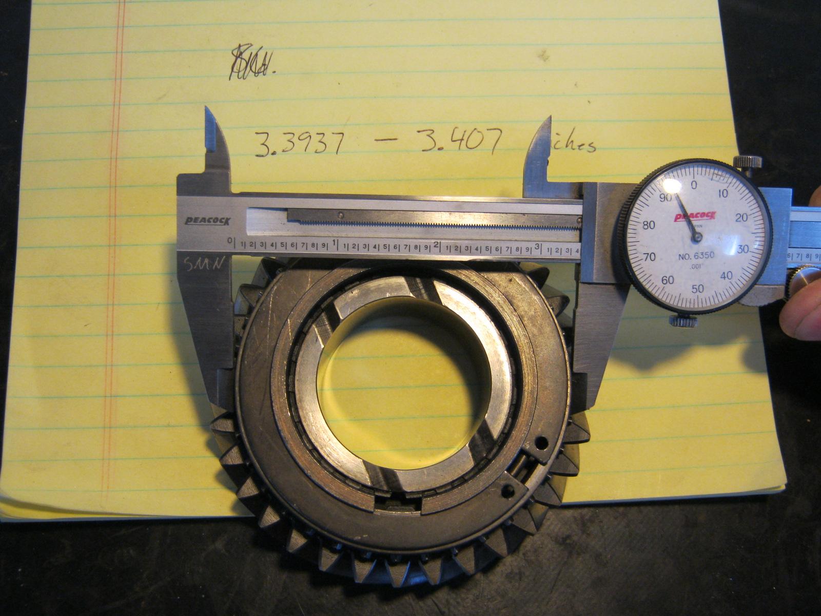

I started trying to wrap my head around this.. Started looking at 1-2.
The synchro ring supposedly has a super-hard sprayed-on coating that shows rough on the OD of the ring.
Any shiny spots, where the roughness has worn away, means that the ring needs replaced.
This doesn't seem to be my case here - right?

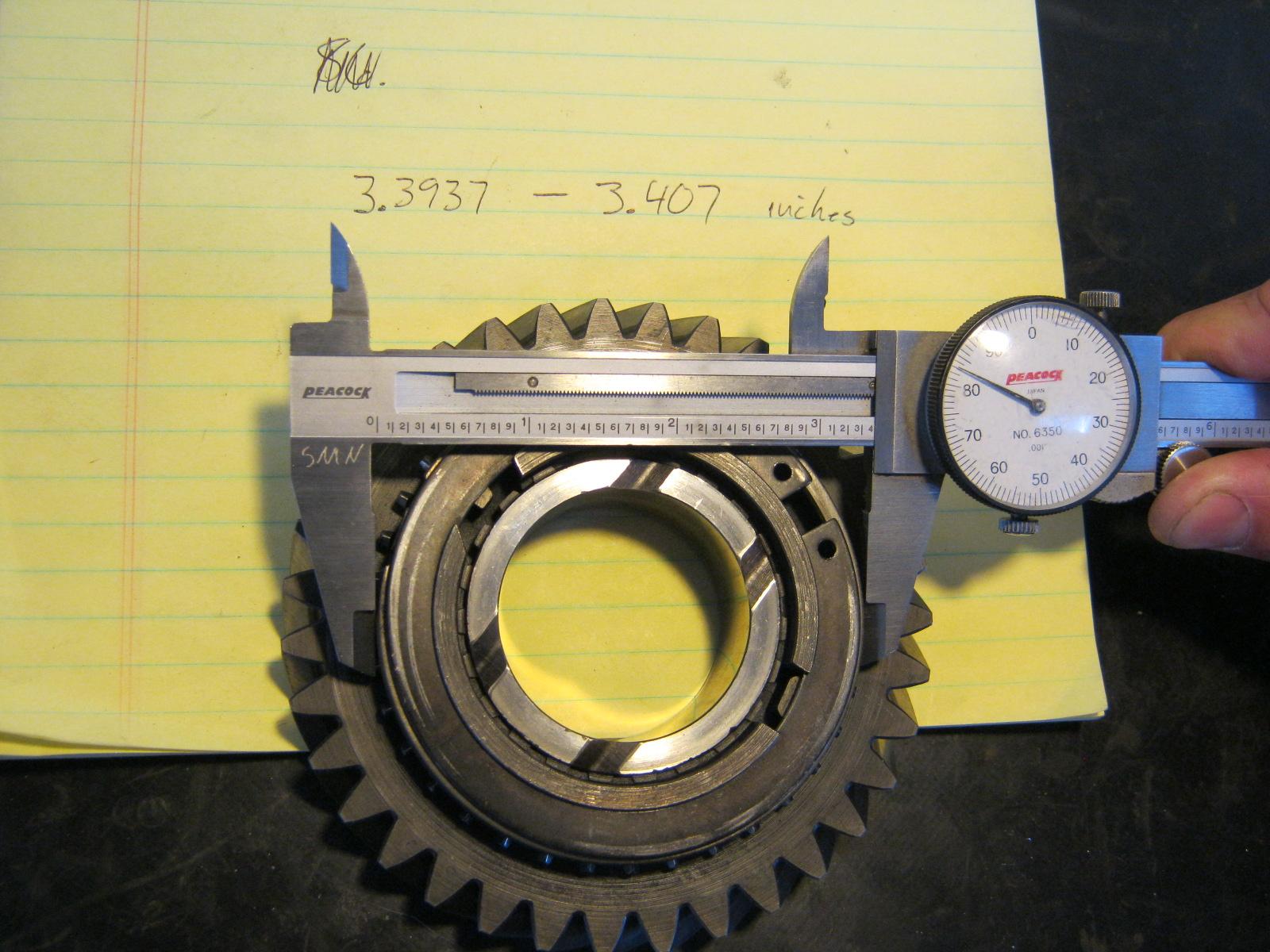

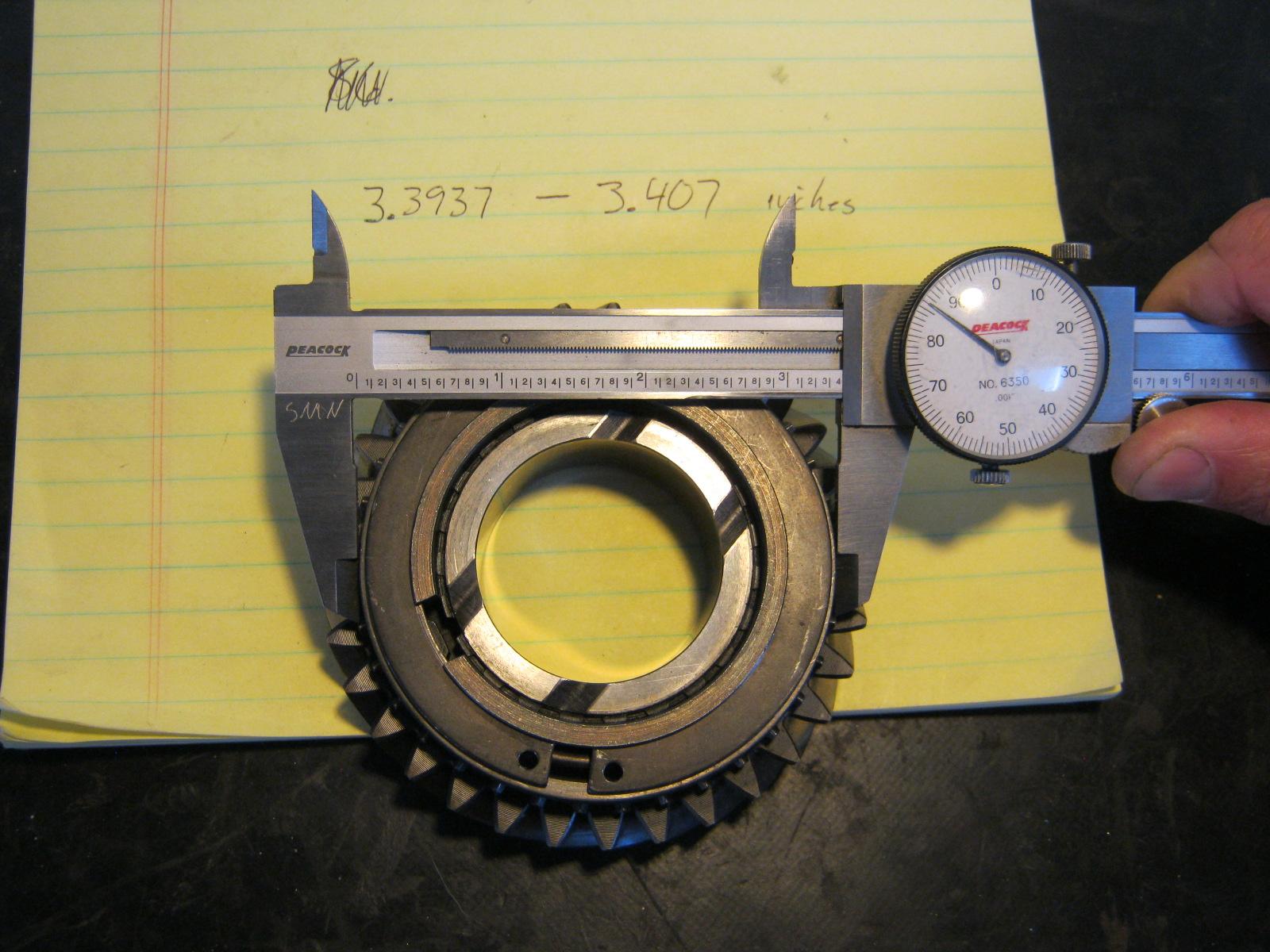

Measuring the OD of the ring assembled into the gear/teeth is showing some odd numbers.
One of these gears was pulled apart and inspected, the other was not.
Here are 1 and 2 showing the different measurements I'm getting at different points.
Note that many of those measurements are oddly under spec.
The measurement gets bigger with wear, right?
Wonder what is up with some of these measurements being so small??
I can read a caliper - And I promise I'm holding my mouth right..
If i'm getting this, the ID of those teeth gets bigger as they wear against the OD of the ring.
That's the 9 degree angle, that you spoke of, that wears, correct?
There is also wear at the ID of the synchro ring, inside the gear, that we are not measuring or checking for.
So this is why it's good to replace synchro rings while we have it all apart...
Also want to double-check that the synchro ring only is OK to replace..
Don't have to buy a new slider sleeve if we dress the corners of the slider teeth down - provided it's in decent shape.
Someone somewhere said you had to replace sliders with rings..

Even though my measurements are all under spec,
And the visuals are good on them,
It's still worth the $176 each to replace the rings?
Just want to be sure...
It somehow comforts me to use parts that are already worn-in together.

It's probable that those synchro rings were replaced once before. However, you can see some wear where they have been slightly rotating back & forth within the dog teeth.
Until I get back to my manual in 10 days, I couldn't comment on your measurements.
The interconnectivity of wear between the various parts in the Porsche-patented synchronizing system is why it is generally recommended that all parts be replaced together. Wear points are difficult to properly assess (totally unlike the Borg Warner parts that most of us are familiar with, which are simple to assess). A shop doing this job can't afford a come-back, so trying to save the customer a buck is "penny wise / pound foolish". For instance, your Op Sleeve, with its displaced material, would be replaced without a second glance by a shop, despite how great it looks otherwise.
Again, I am NOT an expert with these earlier transaxles, but rather I'm just sharing info I've received from a number of shops who ARE experts. You can often get away with massaging used parts, but once in a while this will bite you in the butt.

Your installed synchro rings appear to be right on the money: 86.37 +/- 0.17mm

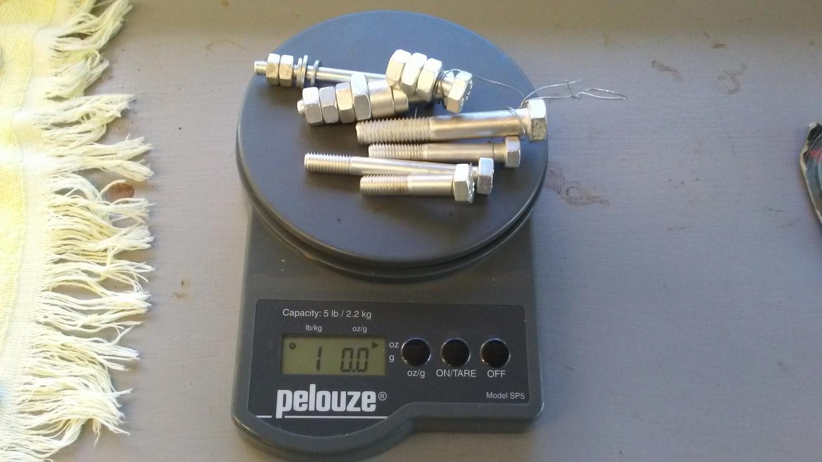

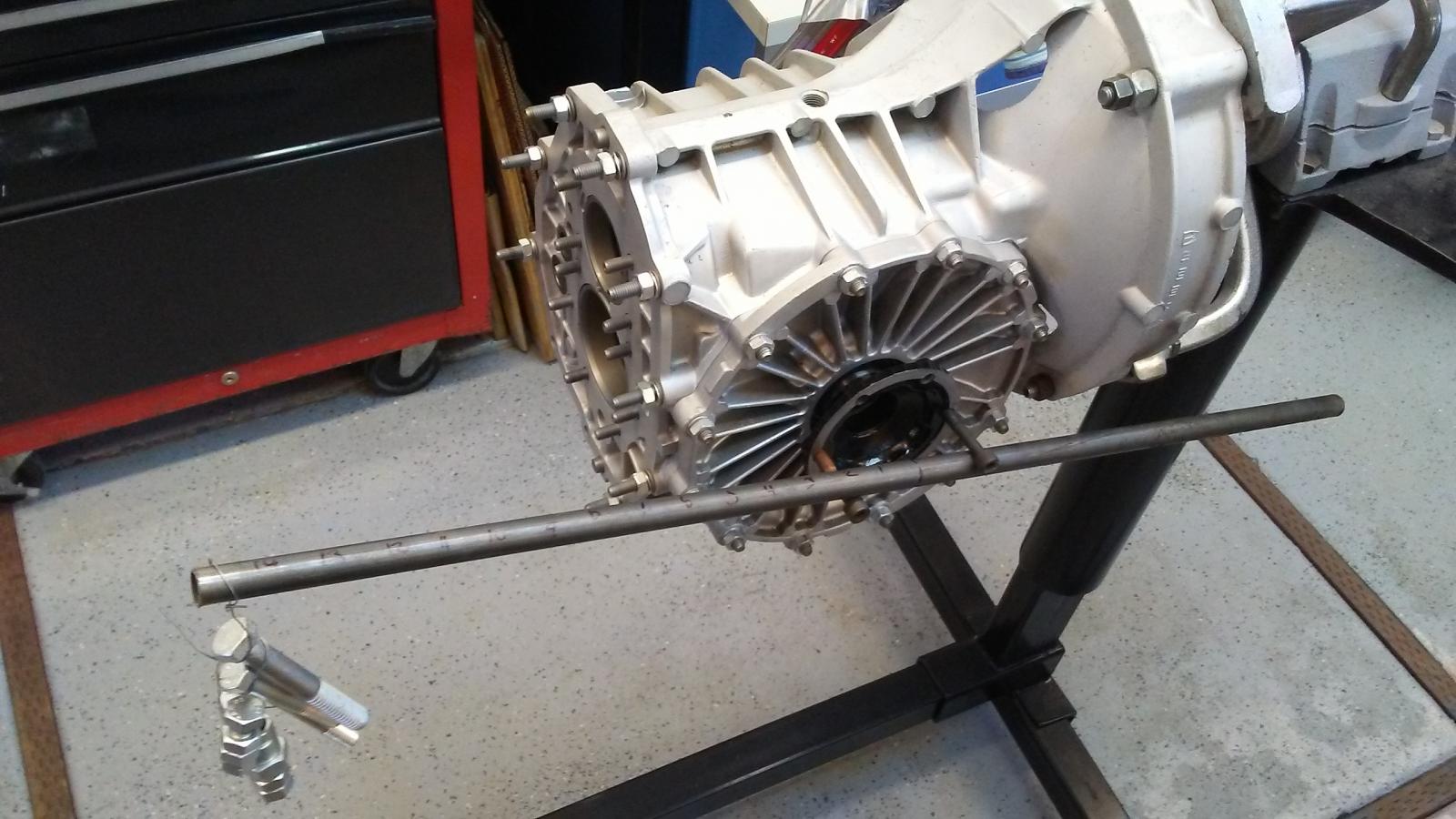

Because I don't have a proper inch-pound wrench, I rigged up a substitute:
14 inch-pounds will hang, but break-away if nudged.
11 or 10 seems to be the continuous turning torque.

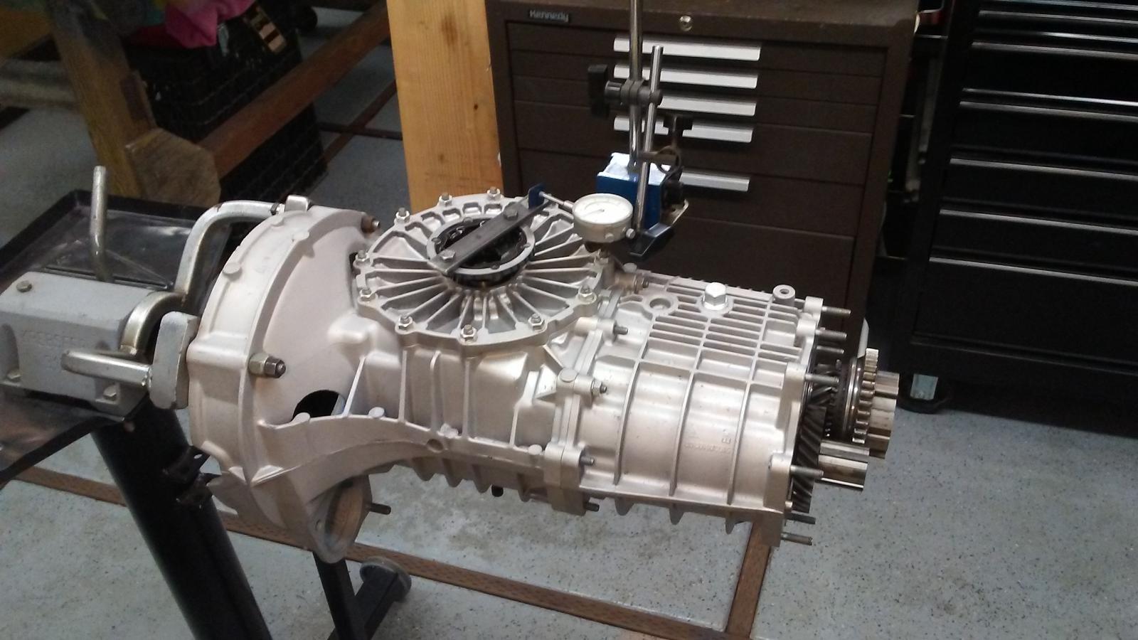

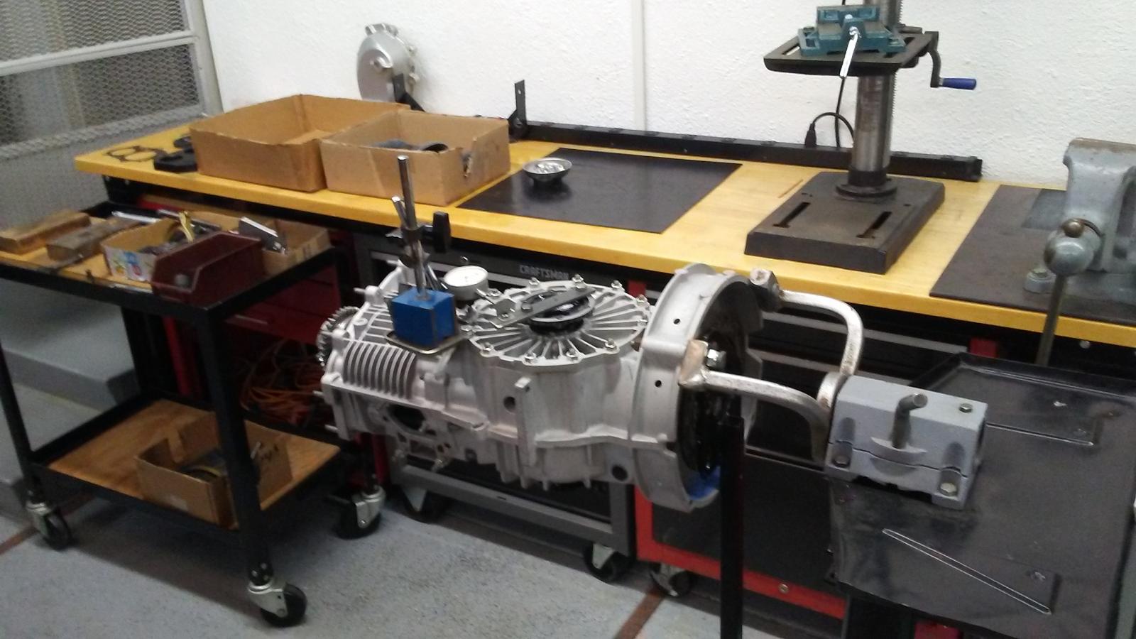

That brings up to backlash.. Need to know that before messing about with shims, right?
Managed to rig up a bracket to measure.

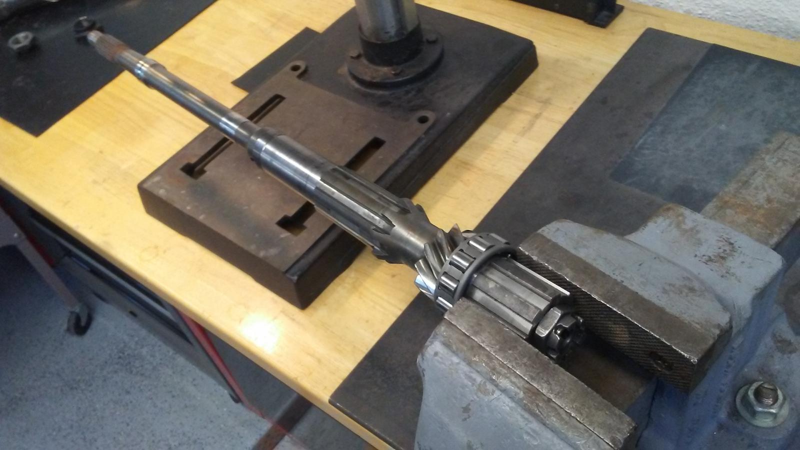

Also used my 'buddy bar' and old pressure plate to lock the mainshaft,
Plus started making up my pinion shaft 'holder tool' from an old R hub from a 915 4-speed.

Normal MO is to lock the measurement side flange against the diff with a specific-sized ring/shim, which gets pinched between flange and diff when the flange bolt is torqued. You may be able to use something like a piece of 12-gauge copper house wire as a substitute.
Regarding your method of diff bearing preload measurement, I honestly think a FAR better DIY method would be a combination of "by feel" and by observing side cover lift-off.
Keep in mind that when new, these bearings should receive about .006" preload each. But when setting up used bearings, "by feel" is the best method you can employ, IMO.
Oil your diff bearings.
After bolting the side cover down tight, loosen each nut and then retighten them all at "finger tight". Observe if there is at least a bit of cover lift-off. You can use a feeler gauge to confirm this if you wish. Now grasp both flanges, turning them in the same direction (obviously), and take a mental note of the "zero preload" feel. Retighten the side cover nuts, and now turn the diff. Confirm that there is now some preload.
Next, increase the shim size on the ring gear side (since you said you wished to eventually reduce R&P backlash) and recheck the turning torque. You'll know when you've increased the preload too much, because there will be a slightly "notchy" feel.
Welcome to the world of trial & error. The accuracy of your results will have a direct correlation with how much time you invest in determining precisely how much increased shimming is too much, and how much feels just right. "Correct" is usually no more than .002" increase in total shim size over original, but it could be .004" (one shim size increase). Half-sizes (.002" increments) are arrived at by using a combination of thick and thin shims.
It's worth noting that Porsche finally now offers shims that come in .05mm (.002") increments (GT3 are the same as 915), which eliminate those silly .25mm shims. GT3 shims are the only ones I'll now use.
