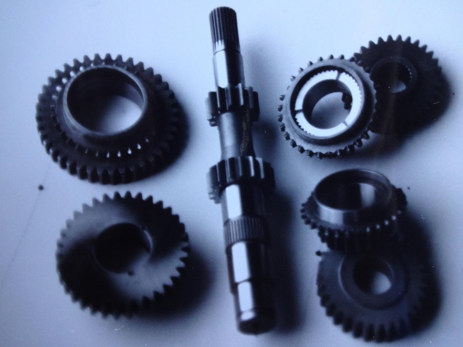

I recall Ivan Albins telling me over 25 years ago that they'd use 091 sliders on 002 keys with no issues. That was when they were grinding stock 091 cones down to 002 size, in order to true up (center) the cone, when reclaiming used VW 091 engagement teeth to use on their (Holinger made) straight-cut gears.
https://www.thesamba.com/vw/gallery/pix/1129657.jpg
I never made the substitution myself, as I didn't care for the sloppy feel .. but it obviously can be done.
