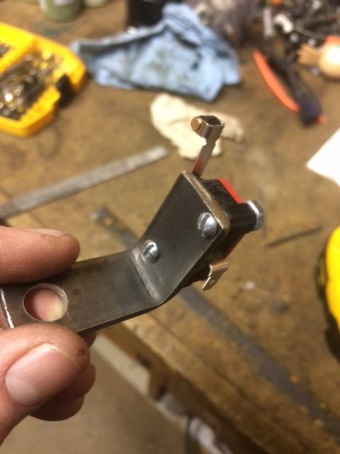

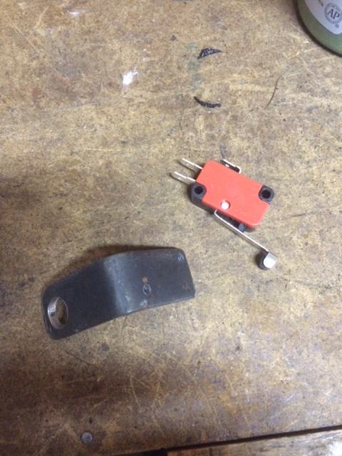

Hi All...spring time is here, almost time to start daily-ing the beetle...and wouldn't you know it...I didn't do any of the upgrades that I had in my head.
I did get one completed, and that was to add a mechanical brake light switch. I just order a couple of the little micro switches off Ebay, wired it inline with the current brake lights (so if the micro switch dies, I'll still have brake lights), and installed some LED brake lights so it wouldn't put too much current through the micro switch...hopefully making it last longer.

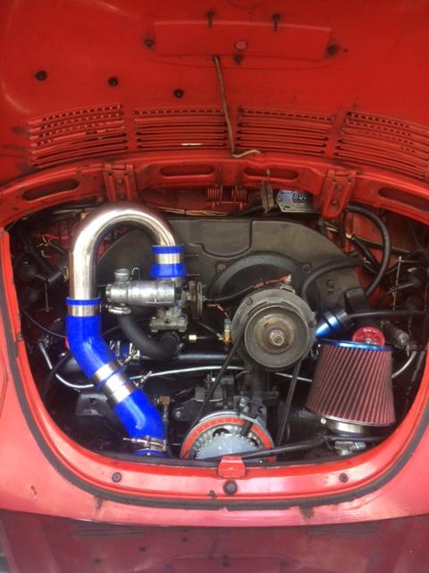

Now on to the To-Do list of 2018, and it entails two upgrades right off the bat. The first is lowering the front end. As I was typing this about to ask for instructions, I found some on TOS, so I wont have to bring that up. I have the AVIS ones that you just have to cut the slot into the beam I guess. Hopefully a weekend project...that I have put off for the last 5 or so years.
Anyway, next is boost. I spoke with Chip awhile ago and he gave me some insight on the Air to Water Intercooler. The more I look at my set up and manifolds, the more trouble I have seeing a setup like his work for me. I have no problem cutting a couple holes through the doghouse and the package tray, its just that I have the stock Mexican looking endcastings that bring my manifold to the rear of the car...and trying to plumb the charge pipe from the turbo, up and over/through the doghouse, through the package tray to the intercooler, back out through the packaging tray and doghouse, onto the throttle body, and into the manifold...its just a lot going on. I'm going to do it, just need to look at it a few more times.
In the mean time, I need to take my intake off to install a port for the IAC that I recently got to hopefully help cold/hot starts. I was thinking since I'm going to have the manifold off, may as well install some ports for water/meth. I want the intercooler, but may as well get a little spray kit going in the mean time.
What kind of port/s should I be putting in the manifold. I was thinking two (one near each endcasting), or just one in the middle after the throttle body but before the T.
Someone point me in the right direction for a kit...I wanna get this going. I need double digit boost :D

I'm thinking you will get better cooling of the charge with the water/meth port farther away from the end castings. My vote would be near the throttle body above the tee. The kits usually come with a bulkhead style fitting so no welding is necessary.

This makes more sense now that I think about it. My IAT sensor is on the 1-2 side of the manifold, after the T. If I didn't have the water/meth port in front of the IAT sensor, there would be no way to tell intake temps.
EDIT: Should the nozzle be installed before the throttle body? The instructions say that it needs to have a solenoid or check valve installed if its after the TB due to the vacuum

Got the manifold off today to instal a port for my new idle valve. That manifold is pretty busy now in that area. Hopping I have a spot to put my water meth port still. Figure that out later.
Also ordered a flex fuel sensor and pigtail from Amazon for $50. Looking forward to giving E85 a shot in the near future.
Two questions. If I don't have a good area to put the water/meth port below the TB, how bad off would I be putting it above?
Second question, how the heck am I supposed to know how much boost I can run with E85, because I won't have a change in IATs up in the manifold. EGT? Knock sensor? Is there a calculation? I don't have a knock sensor or EGT sensor at the moment.

Got my 3 wire idle valve installed today. Feel pretty good about that one. When I reverted my tune back to get rid of the hiccups that I had a few months ago, I messed up the warm up and idle settings and it takes damn near 5 minutes for it to fire back up after being warm. But now that I have the idle valve, figured I would wait till now to get it properly tuned for startups.
Just going to put a clamp on filter on the idle valve. Figured that would be easier than routing it to my intake piping.
