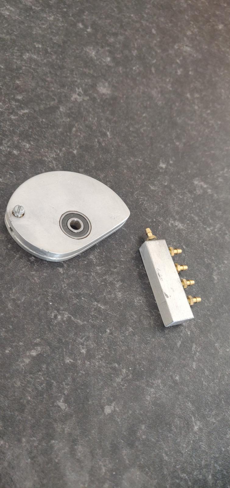

The motorcycle my throttle bodies came off of was a MAP set up.
The bodies all have a small restricted port. They were all Tee together down to a single hose and plugged into a MAP.
I do have the motorcycle MAP but research says it is the same range as the MS unit on the board.
So I made a vacuum accumulator can today.
The one pair together and to the can.
And the other pair the same.
MS to the can.
Sounds like a reasonable plan.
But I also have an fk10 cam.
Of course these bodies at 44mm came off a 1200cc engine with 150hp. Had to be big cam and high strung.
So.....
Whatcha think?
Will I have enough vacuum span to actually use the MAP.

In ITB mode yes, but IIRC you still have a MS1, so ~the best I can do is wish you luck and suggest a can.
Best you can do is feed it into a central "can" and read from that, about 3-400CC "can" PVC works to try.Some folks have used a cheap fuel filter as a "can" with success.
ITB mode is a blend---uses alpha-N at low RPM and MAP at higher RPMs where you have more usable signal.
Supported by MS2E & MS3.

That can is about 175cc.
I have always planned on being alpha n.
No itb mode.
I wonder how the motorcycle did it with half the cc and with a map.

Very likely it also has a TPS... So it probably ran something like MS2E/MS3s "ITB mode".
The only other alternative would be very fast synchronous sampling with variable delay.
Simpler/cheaper/easier usually wins so I'd bet the former.
There i also a few multi-sensor and capacitor setups with diodes to best capture the minimum values, might work with MS1, but I'd strongly steer you at a MS3 daughterboard before I'd recommend trying that.
