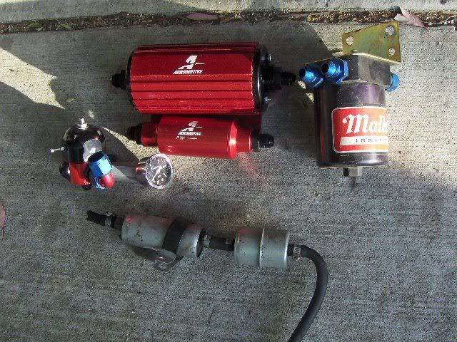

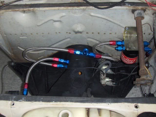

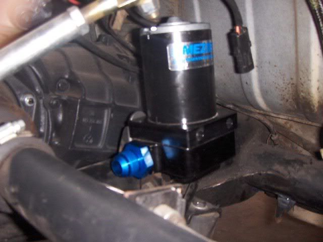

big boy fuel system on top, old stuff on bottom

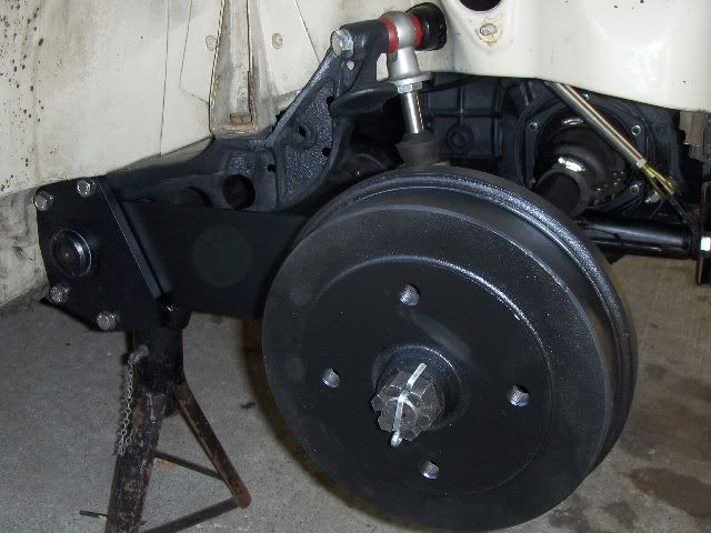

jcl springplate retainers, saw springplates, RLR adj shocks

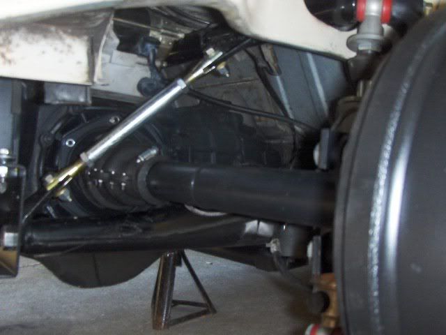

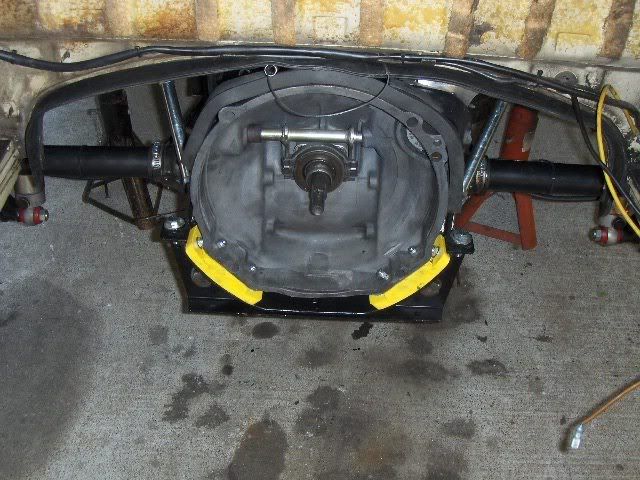

trans has all billet weddle parts/gears, alum spool, saw axles, berg rubber midmount, rhino trans mounts, eyeball kafer brace
new stance from 3" beam, drop spindles, ghia disks, M&H front runners and M&H 235/60 dot slicks.

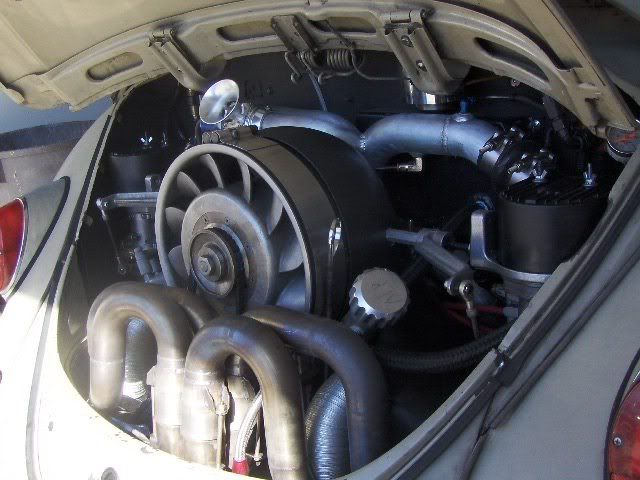

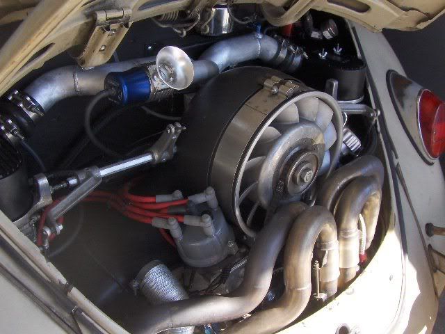

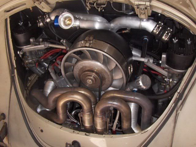

and the new 2442 powerplant Smile

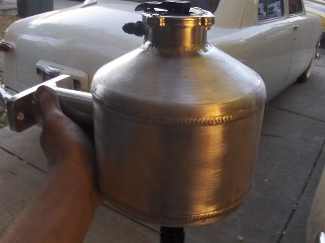

water pump, radiator (THATS RIGHT)
watercooled CB CNC comp eliminator heads 48x38 valves
water reservoir (mounted in package tray)

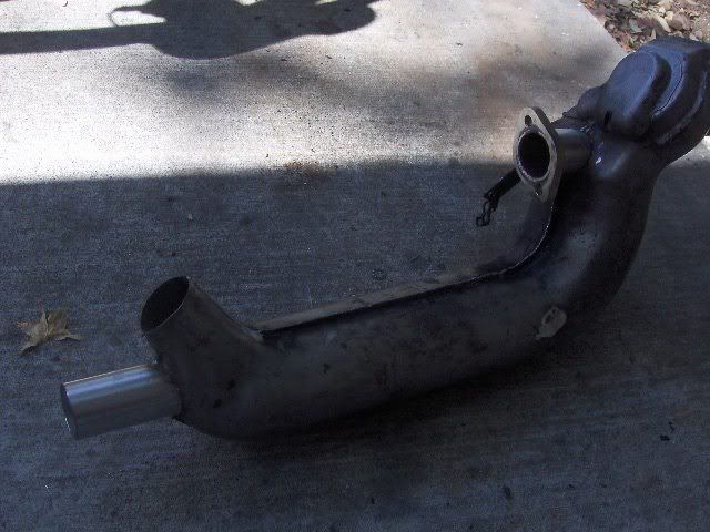

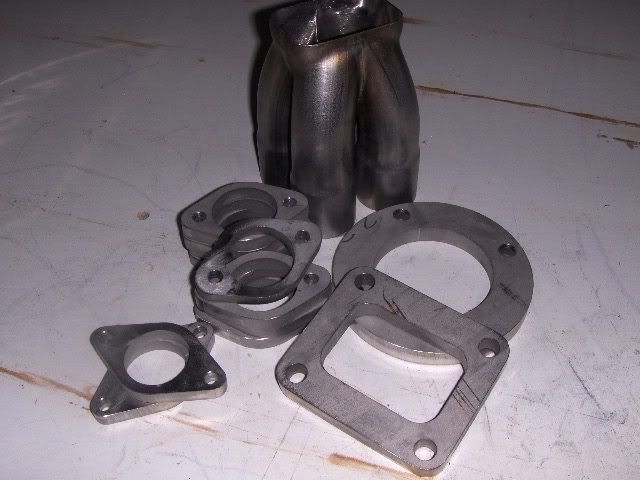

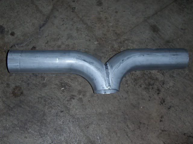

parts to fab stainless steel header

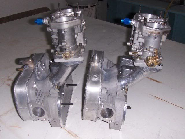

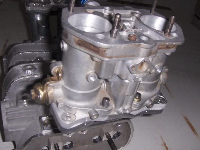

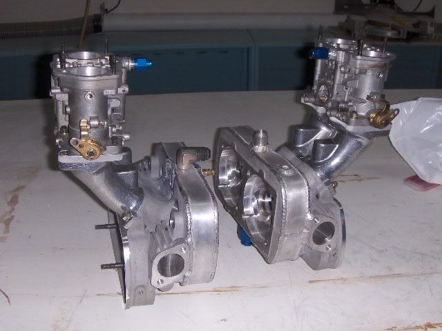

custom reverse bolt pattern plates to mount 48 dellortos.

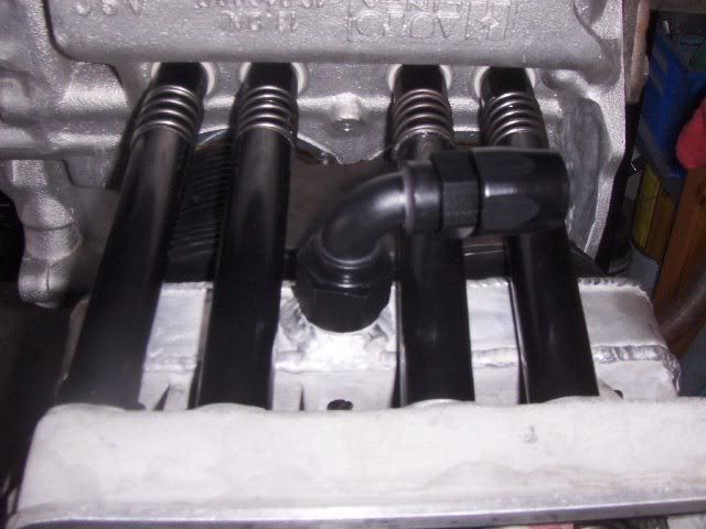

1 5/8" stainless steel heater boxes (using gutted stock units)

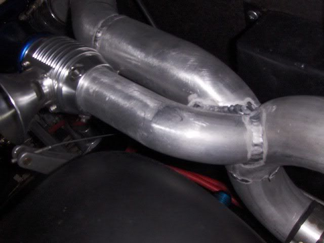

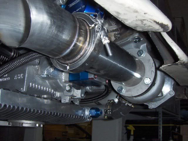

finished header, autocraft stage and a half pump to scavange oil from low mounted turbo

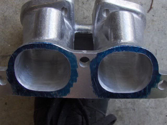

alum intake fab
Decklid closes completely, runs cool, and hauls ass!! :D

A bit ! ? :shock: :D
no problem with the 911 fan sucking through the header?

I'm a little concerned about the lifespan of your fan belt. Looks like that header (whick looks totally badazz, by the way) might get that belt a little toasty. I could be looking from the wrong angle, though.

Coyote wrote:A bit ! ? :shock: :D
nope, even with the decklid closed, it runs cool, im sure with the bottom propped it would only get cooler.
Nice ride man Twisted Evil
luckily belts are cheap, no dyno time yet, not sure I will, I'm going to convert the clutch to a dual disk setup then ill get some timeslips on it.

Such a nice and uniquely design engine! Placement of the turbo is very cleverly done. Me like! Very nice indeed.

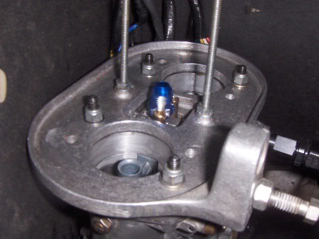

But why still running carbs?? The modulator rings surely cost you a lot of flow and hence power (not to mention fuel..)
Next update EFI?

Are you still using the boost referenced float bowls? Sounds like it was working pretty good before with high boost levels.

What's the story with the v-band clamp holding on 6 inches of pipe? Do you have a muffler setup to swap on?

Wally wrote:Such a nice and uniquely design engine! Placement of the turbo is very cleverly done. Me like! Very nice indeed.

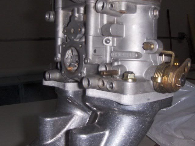

Next update EFI?
Using carbs because i have them, No mod rings, look at the picture of my carbs that turbobaja posted, from that an fitting a 3/8" hardline goes into my boost stream to catch a good flow of pressurized air.
If/when I go efi, I will ditch the dual setup and do a single aftermarket 5.0 throttle body.
I am monitoring head temp via a water temp gauge (something you dont see often in a bug)
yes the Vband setup is so i can change from straight pipe to a muffler setup.

Nice work. It's cool to see something so unique.. How hot does your water jacket run?
[email protected]
2stroke
Posts: 1018
Joined: Sun Jul 29, 2001 12:01 am
Post by 2stroke »
MarioVelotta wrote:Nice work. It's cool to see something so unique.. How hot does your water jacket run?
250
