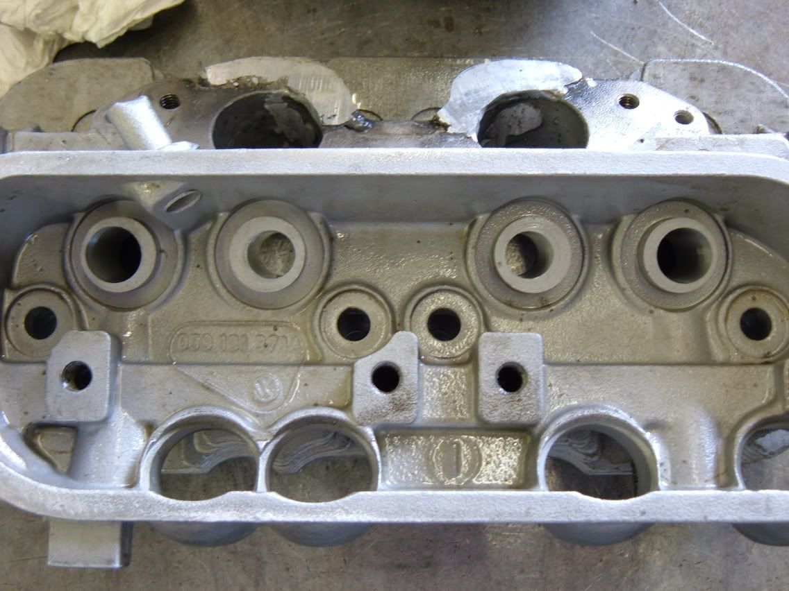

And here it has been done by using the new guides as the pilots to cut the heads for the new seats & to install the new seats, and thats after they have been re-located.
And this is to show you it can be done. And these aren't the only heads I have had over sized seats put in, but these are the first with re-located guides.
Here the center was found from the existing guide holes, then they were relocated wider, but still in line for the pivot length of the rockers. The 2.0 ltr exh guides, the head
was machined to fit those, and the bronze stock was machined to fit the new exh hole in the head. I only installed the new guides just before they came into the ports, so I was able to port
with them out of the way, and in this partially installed location, they were used as the pilots to machine the heads for the seats and the pilots to install the seats. After the seats were
installed & the ports ported I drove the guides the rest of the way in. Then the seats were cut. I was very happy with the out come to say the least.
The valve guides were relocated wider to make room for the larger valves, the 914 2.0 ltr Exh guide was used for the Int and the Bronze material was
used to make even a larger Exh guide.
And when you do the welding on your heads weld up that little area between the ports over from the center manifold stud. And watch how much you weld in
between the ports, remember you have to get an extension with a socket by the ports to tighten up the head studs, bottom pic.

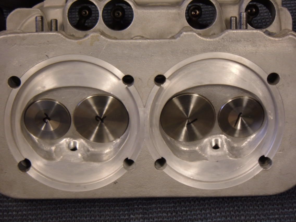

Had a little time to work on my heads today, so got the chambers shaped the way I wanted.
Getbackontrack
Posts: 241
Joined: Thu Oct 27, 2005 2:08 am
Re: 2838 type 4 buildup
Post by Getbackontrack »
Couldnt resist the fact that it actually was possible to install a 50 mm inlet valve, so cut new holes for the seat to the 50 mm valve also :shock:
Regards, Jakob

Getbackontrack wrote:Couldnt resist the fact that it actually was possible to install a 50 mm inlet valve, so cut new holes for the seat to the 50 mm valve also :shock:
Regards, Jakob
Hi Jakob
You made the same mistake I did, I should have drilled & tapped the holes for the spark plugs before any contouring was done around the plug boss.
Mine is not that bad, I was relocating the plugs anyways, and going to 10mm spark plugs.
But you may have to go smaller plugs if you hadn't already decided too.
And next time I will have these areas welded up also, then drill the plug holes.

If you don't know where the hole is, then how can you shape the boss around the hole that isn't there ? Well I did and wish I would of drilled the hole first, would of made it much easier.
For mine I will be changing the angle of the plugs and contoured the bosses to reflect that, stock location their currently angled toward the Int valve's, hopefully mine will end up more toward the Exh valve's when drilled, and I am going 10mm plugs which why I contoured the boss much smaller than it was originally.
