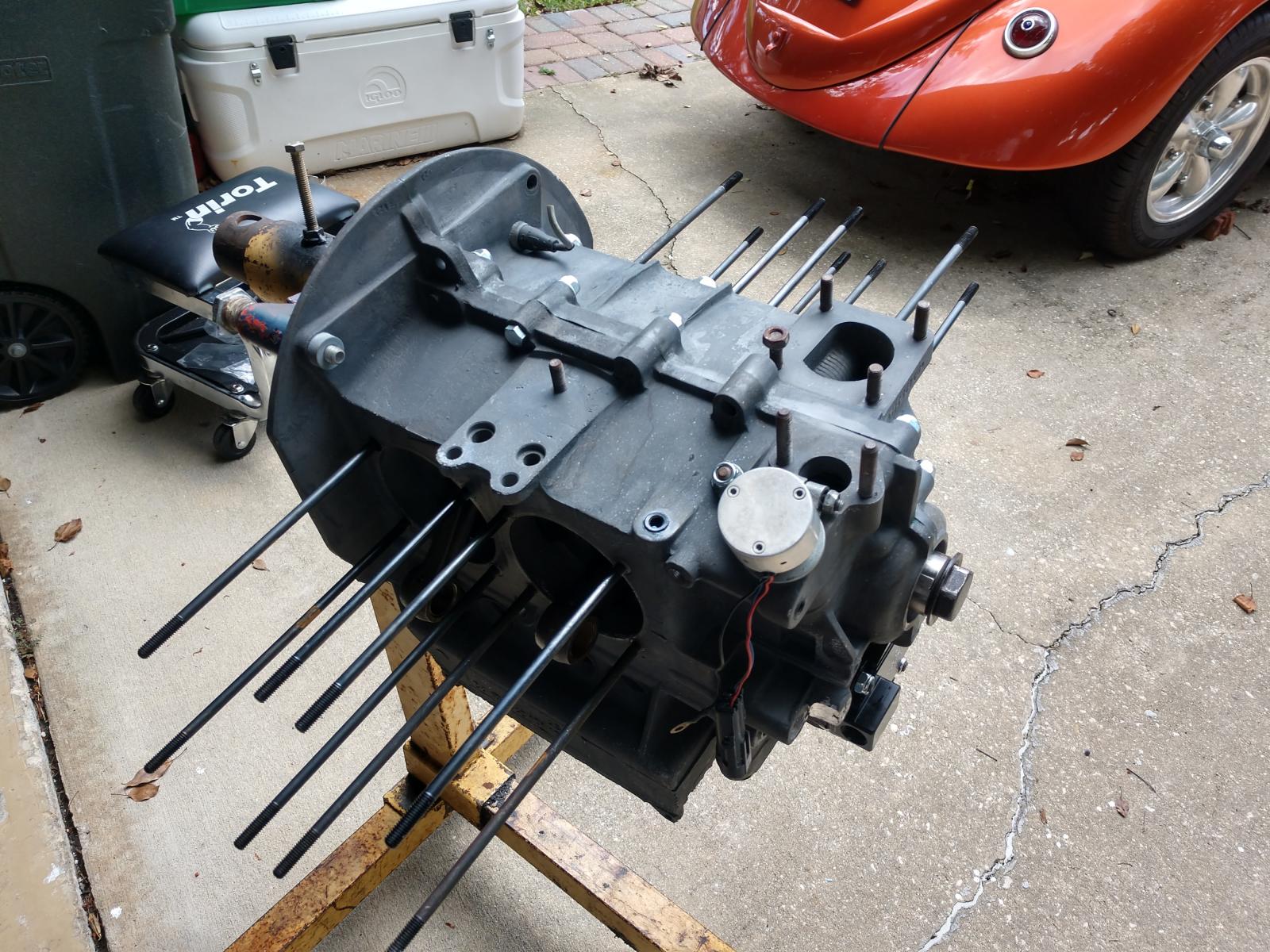

All sealed up. I put in a 17.5 hour day yesterday so I took today off. We have a hurricane coming tomorrow, so a good part of my day will be spent prepping for that. If I have time I will bolt more stuff on er!

They are saying it's going to come closer now than they did earlier. Still a category 1 so far, so not too bad. I got some grub, and fired up the generator just to be sure. I also put the pistons and cylinders on the engine, so it's inching further forward. I will at least get the long block finished up tonight.
I also put the zero washers on the cam, so I will be running it straight up instead of 2 degrees advanced.

Got the long block finished. I'm not happy with the tin so I will have to do some work with that. The heads I got must be weird because the engine is a little wider now than it was but the cylinder tins don't even come close to meeting the case. I will still probably throw the long block in the car and make sure nothing is weird there. I guess I still need to put the flywheel on too and check the break away.

don't sweat the gaps, did ya lap the heads with some valve grinding compound? make'em seal better :wink:
