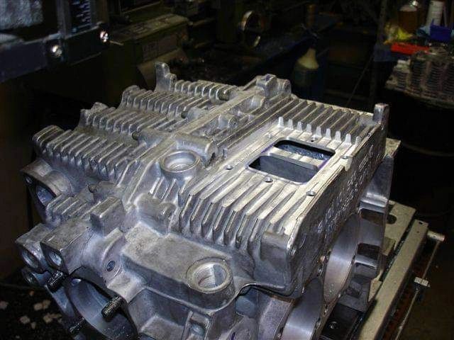

Machined the bottom of the case for the sump adapter...
Sump adapter to allow the Autocraft sump to bolt on...
