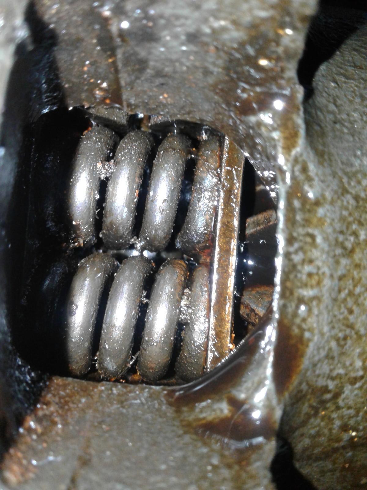

ngobet i think we have stumbled upon the positraction diff. If this is the case and i think it is we have struck gold here. I am going to look at mine in detail on the Christmas break. I have a bore scope camera so i will be taking internal pics.
- Posts: 1033
- Joined: Mon Apr 08, 2002 1:01 am
Re: 091 gearbox lsd diff
Unfortunately i couldn't get the borescope camera pass the opening in the diff but this is what i got.

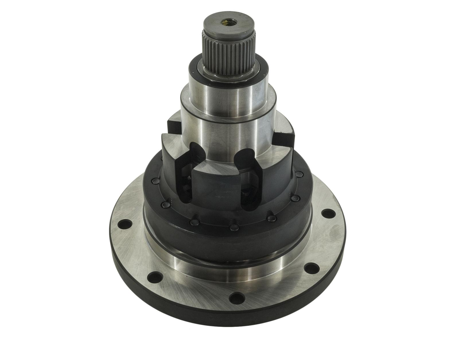

interesting, it is possible that it has the same internals as the Peloquin positraction type. Like on that page: https://www.gowesty.com/product/automat ... ferential-
There is no way that there is space for the spider gear / side gear assembly with the disc clutch type LSD in that housing, it looks the same as our diff.
Mine came from a workshop where they used to rebuild swiss army vehicles in the 80s-90s, it has to be a factory part.
I bought a bunch of LSD together and the rest is all factory ZF. Will have to research which LSD option was available for 091 back then

Yes i want to think that this is indeed a posi-traction diff from a military vehicle. I now need a 5speed 091 kit to build around this unit.
