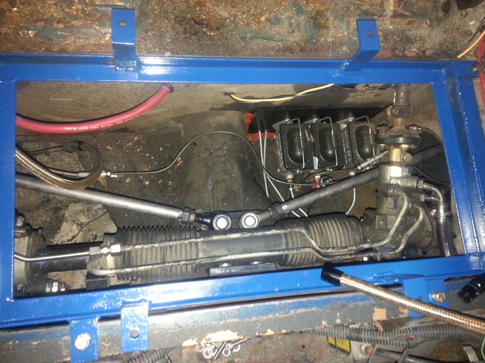

Finally got her back on the ground. I haven't done a road test yet but steering is in the one finger realm at a stop. My steering was a problem due to added caster, wide sticky tires, new ball joints/tie rods and a smaller steering wheel. I'm using a the stock Subaru power steering pump with some custom lines.

Hi, Have you measured the bump steer and ackerman angle.
dlamyle
Posts: 153
Joined: Tue Jul 09, 2013 11:27 am
Re: Power Rack and Pinion
Post by dlamyle »
I didn't change the spindles so Ackerman should be unaffected. Bump steer can't get any worse than stock. I haven't aligned it yet but I will check for this when done just to put it out there.

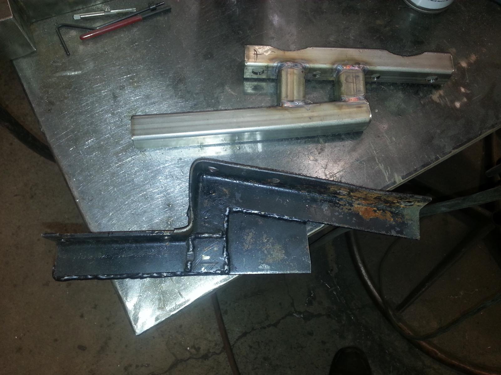

There is no kit.this is all home made the rack is from a 2000 saab 9-3.I have been running it for over three years and it works good. Here's a picture of mine from a couple years ago.

With the saab R&P, what happens if you don't have a power steering pump installed? Would it be detrimental to the the R&P? How is it being held in place?

I never hooked up a pump so it's been running with a hose from one side to the other. 3yrs no problems. I made an adapter out of one inch square tubing to mount it.when I get a chance I will take a picture of it and post it.

Old angle iron prototype on bottom permanent square tubing on top. X2
