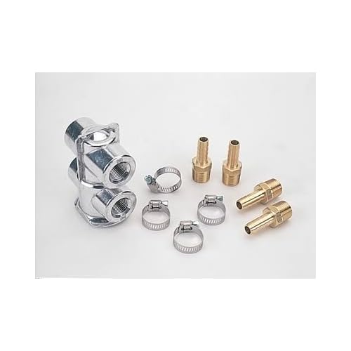

I'm using one of these.
and one of these.
and one of these.
