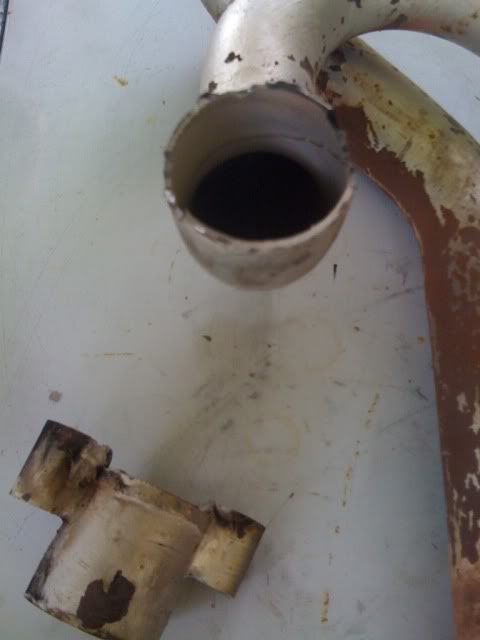

My exhaust hates me....
I swapped in my old heat delete pipe (remember the muriatic acid experiment) so I can keep the notch on the road...it's nice and quite again. I suspect this has been an issue for a while and finally completely failed last week. If my boy can't fix it then I'll have to buy another one

Should be easy if you have a shell motor you can throw together for a jig.

I got plenty of heads laying around.

This would be a great opportunity to make some flanged SS stubs...

I agree with Pile; this is a great time to make some stub tubes and be done with this problem once and for all. What size are your primaries 1.5", 1.62"?? I made mandrels to make the oval and swuare stub tubes about 5 years ago. They are a piece of cake if you need help.

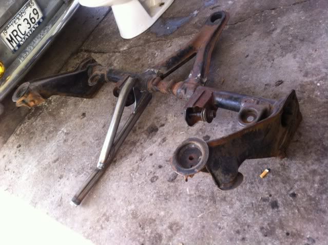

Well crap, it's been too long since I posted anything on here, unacceptable. So the ninja notch has be running awesome, about a month ago I went through the tune and got the cold start stuff sorted out and quick retune, apparently I had an exhaust leak. Regardless, this thing pulls like a boss in the cold and just runs awesome. I'm still busy with the bus then I'll shift my focus back to the notch, i'm really itching to do the IRS swap and 914 5 speed install with a side of 944T brakes
so here is the IRS subframe with one of the Berrin framehorns for reference:

Bump for some updates. Also, I've got 2 924 Turbo cars I'm parting out, if you wanted the complete rear susp with alum trailing arms and brakes and stuff. Just sayin...

GHG- I'm going to pass on the alloy arms, going to keep them steel for the friendlier offset.
