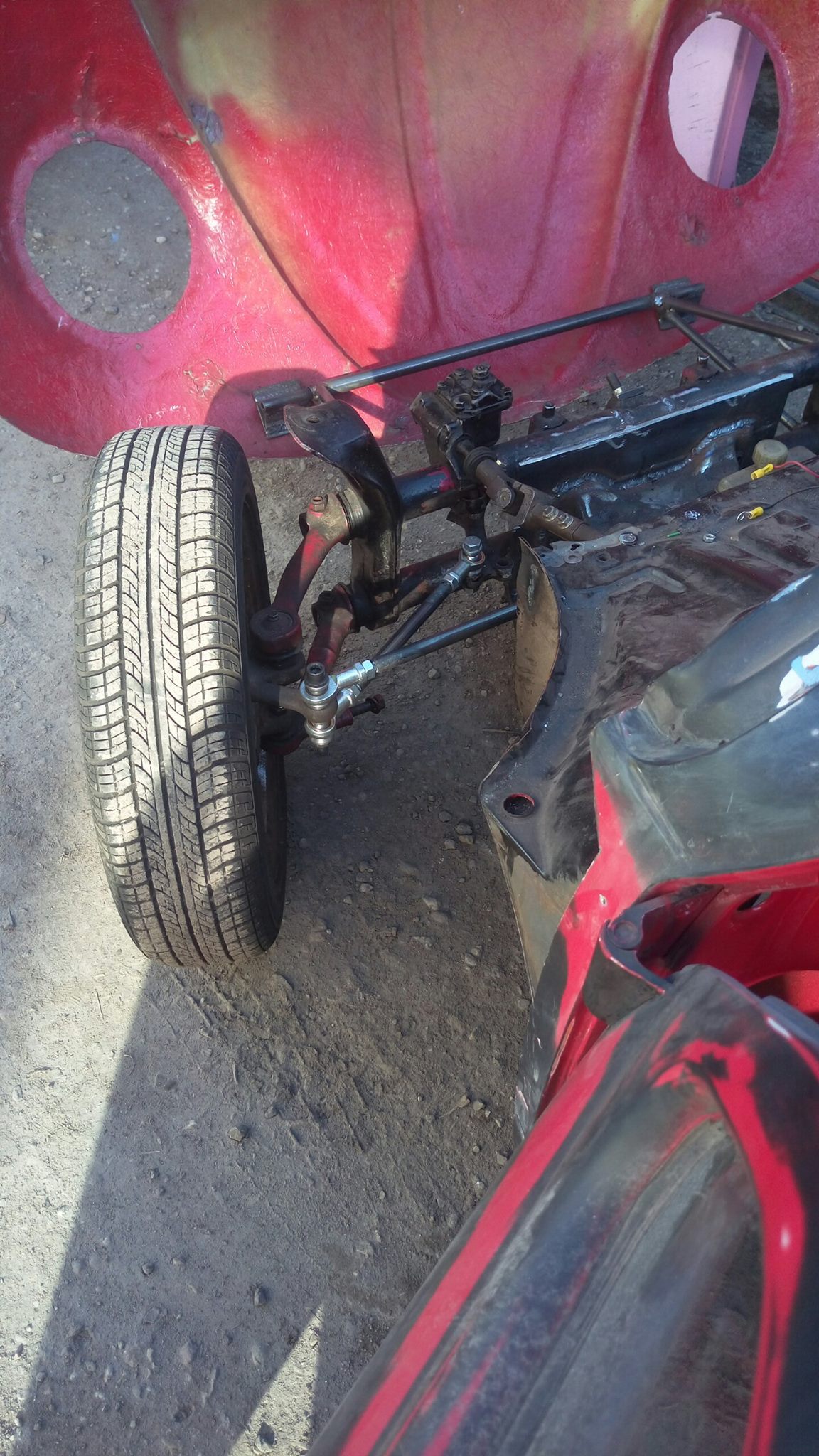

How's the bump steer with that kart setup and the draglink going to the left spindle? The few folks who used kart steering on their VW-beam circletrack cars long ago chose to run the draglink to the RH side, so it didn't undergo as much angle (and therefore effective-length) change as the suspension traveled.
- joosep
- Posts: 446
- Joined: Mon Aug 15, 2011 12:10 pm
Re: 350 hp V8 conversion
It will be connected to the right side in few weeks when I get some more material for that
It´s not as awful as I expected.

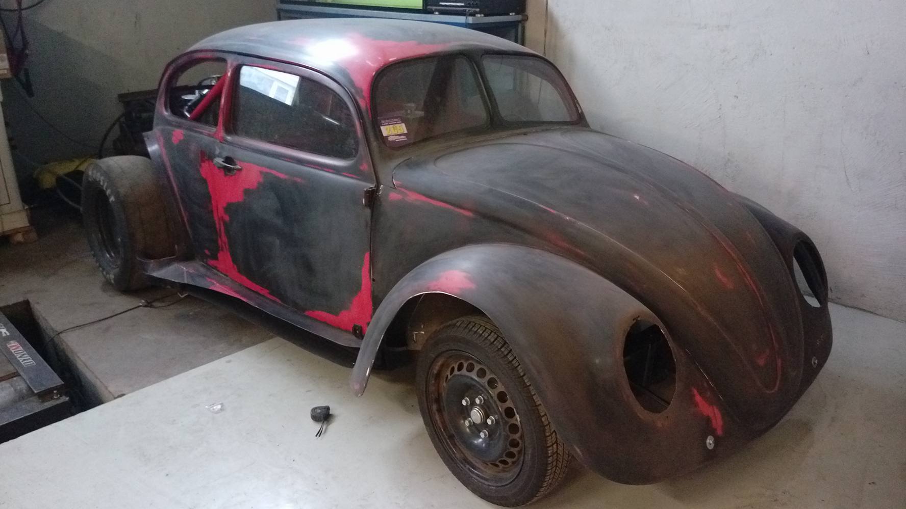

New fenders with hood...self made. 4 layers.
new dront brakes from opel vectra.
4,5 hours in dyno and found a lot of power near 5k
few weeks ago 11,7@ quarter (with 7,58 200m)
and today 7,39 in 200m race with wheels up

Could anybody help me with front axle.
What Camber and toe-in should I try to get it stable over 200km/h ?
Last year there were no problems but now with 5cm narrowed beam its awful eaven with 180-190km/h :S
It had zero camber when I tried and zerow toe in now it should be 2 degrees negative camber and minimal toe in but haven´t tried it yet with higher speeds. On 1/8th mile it seemed to be a bit better but next event is 1/4th
I have to add that I have bouth wheels conneckted with bar and from steering box comes only 1 bar to left wheel.
- Posts: 22879
Much more caster needed for high speed, positive camber helps a little. needs a little toe in.
They sell caster shims for the beam for that purpose, but I'm sure you can fabricate quickly.
