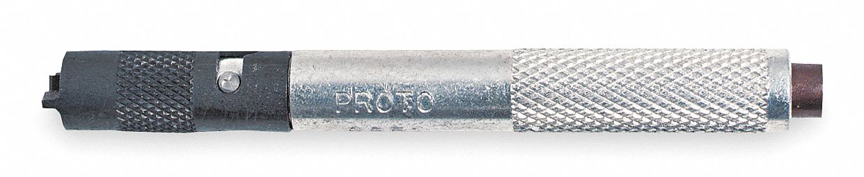

The small screws which hold the brush pigtail on can be tricky to get started (especially the bottom one since you don't have a clear view of it - some folks do well using a mirror but personally I'm better off going by Braille). I have a little screw-holding driver I use for the job, but you can do nearly as well with a small strip of masking tape. Poke a hole in it and insert the screw through it from the sticky side, engage a screwdriver in the slot and pull the ends of the tape up and stick them to the shaft. Once the screw is started, but before running it in all the way, rip the tape out.

sideshow
Posts: 3428
Re: Red light intermittent - 73 Super
Post by sideshow »
My observation is that in this country the generators nearly all had a dust cover over the upper brush and the lower hole was left open. I assume this was for both debris falling into it and to allow air flow through.
That screw holding tool looks great, but I have only seen really long ones and not all can hold the head well...so I use tape.
