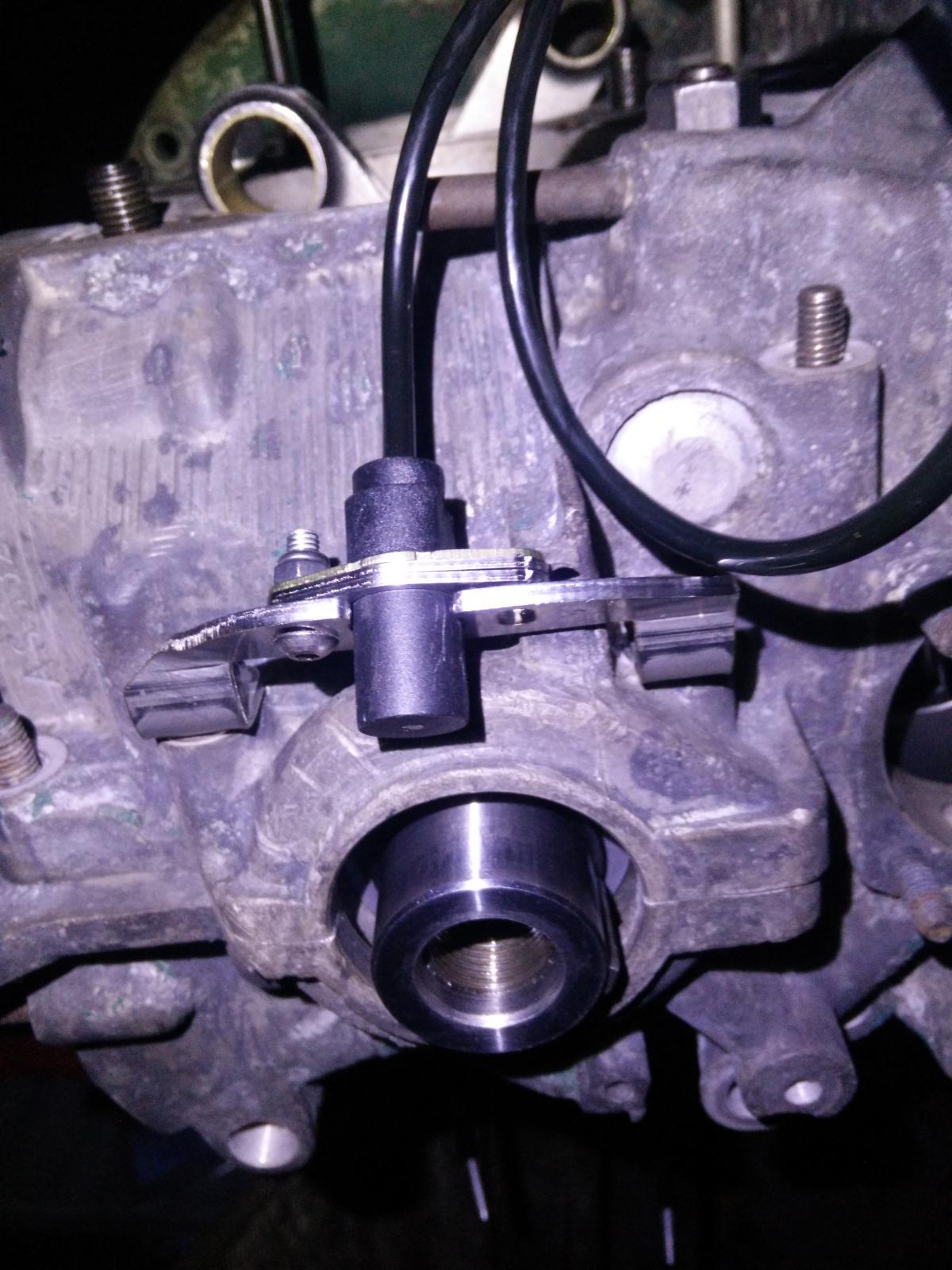

I'm gonna mod the board for VR, I have a sensor that I KNOW works with this trigger wheel where as the 1GT101DC states it needs bigger gaps. If this doesn't work out I can obviously try the hall sensor...

Yeah v3.0, I just linked out the following for VR use
I'd go and install it in the car but I can't for the life of me remember what I did with the keys... Only had them at the weekend
