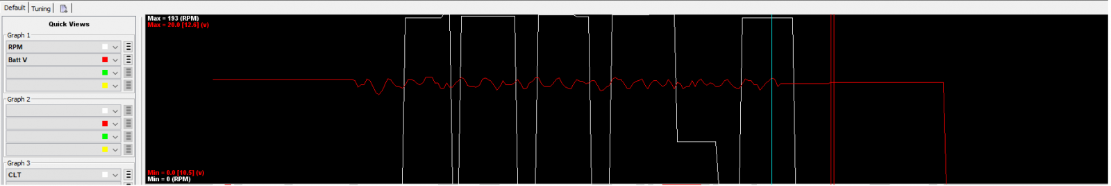

Certainly found an issue.

UKLuke72 wrote: Sun Feb 23, 2020 1:41 pm Certainly found an issue.
try and run a trigger log, then also check your sensor gap and that your sensor isn't covered in shavings and metal (these were my issue)

It runs!
I got a trigger log, messy as hell.
Changed the starter motor, cranks far better now.
Replaced the crank pickup and setup the position/gap.
Refitted the plugs. Fires up after just a couple of turns.

UKLuke72 wrote: Thu Feb 27, 2020 2:24 pm It runs!

ace, so it trigger gap your thinking? thats what mine was too i reckon
