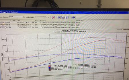

In my experience....130* F. is the critical point in IAT's and high boost. I ran 18-20 degrees advance when I saw those temps using only W/I. The intercooler.......while not super efficient.....does keep my intake temps down low, especially in the fall thru spring months. Summer is the time to keep an eye on IAT's and as long as you keep them below 100-110* F you can run some advance........of course...this is with my engine and yours could be different.
When I did my Dyno run in 2017 the ambient temps were around 38-40* F. and I was seeing a max of 73* F. on the 20.5 lb. boost pulls. We did 18 pulls and never had IAT's above 80* F. and the fan wasn't even hooked up. I think the low ambient temps and the temperature of the water/alcohol contributed to the low boosted IAT's.
If you are going to build a W/I system I strongly suggest using a dual nozzle setup in order to keep the W/I reasonable when in the mid boost numbers.
Here is my dyno run if you want to compare to yours. I think you can gain 5-15 hp with some tuning. Red is 20.5 lbs boost and blue is 6.0 lbs boost.
