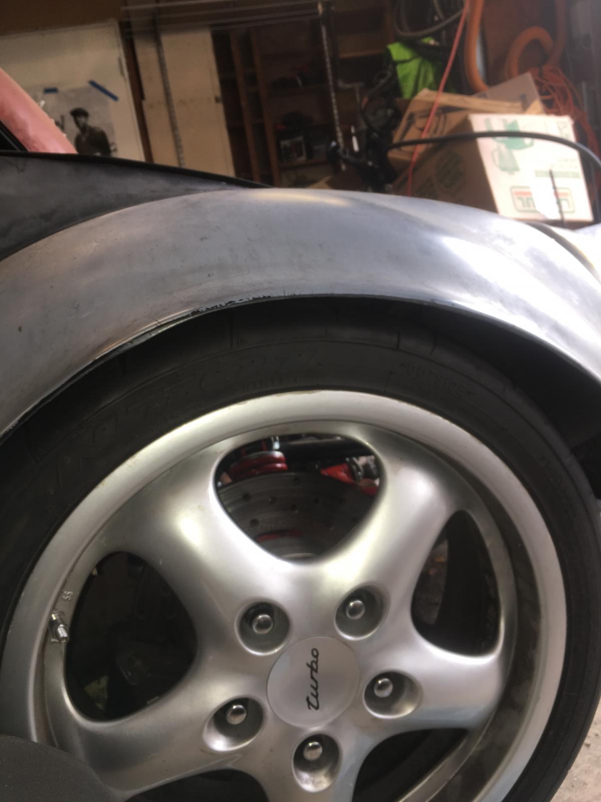

Working on the hubs now for the 996 rotors and callipers

I have Global Dimensions from Bangkok coming to my house this morning to scan the rotor, calliper, and spindle, so that they can 3D model the brake set up. This produces a CAD drawing for the CNC machining process. Wayyyyyyyyyyy better than doing it the traditional way, fits the first time and everything will line up perfectly.
