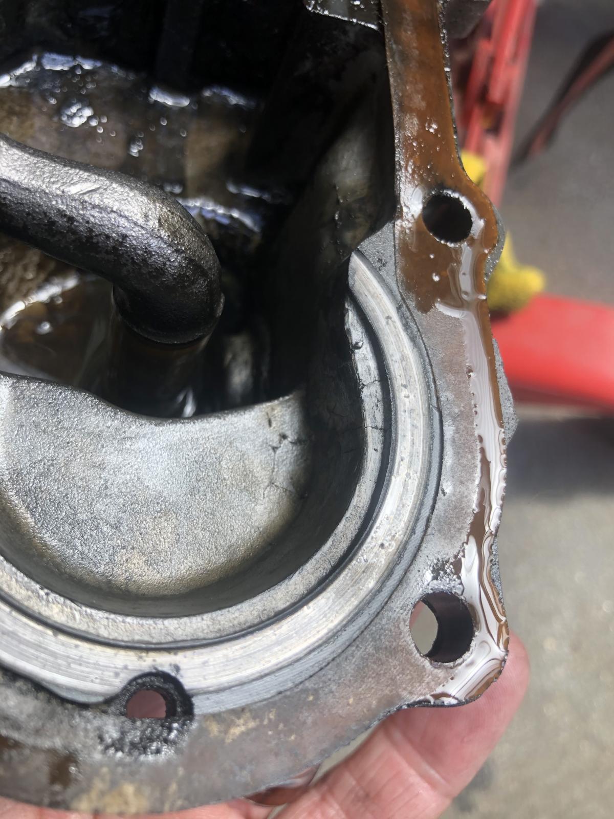

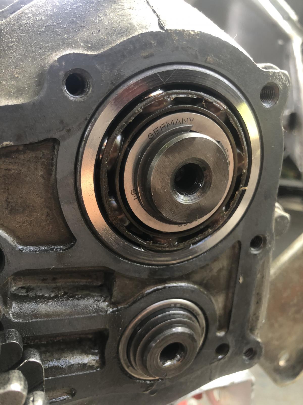

Couple of years later...
Got a chance to open this one up.
Didn't drive it much.
A late shift-rib SSC with an early nose cone just slapped on.
Indeed the plastic cage was chewed up,
But it looks like i caught it in time?
This trans shifted perfectly and was super quiet.
Think it's OK to run?
The main-shaft race moves about .020 in the gear carrier..
Would the plate dealie give me a shot at running the thing?
It says you have to machine the nose cone?
Is this also the case when running an early cone on a later trans?
Seems like you'd get your clearance by just gluing it on,
The bearing would be supported,
And Bob's your uncle, right?
Nose cone is pre-clearanced!
Anyhow,
Wondering how the trans masters would approach this situation..
Thanks for your time and wisdom,
Steve

Is the nose cone in your last pic a two bolt or 3? If it is a 2 bolt, it is the relatively rare Type 181 nose cone. This nose cone is designed to work with the late bearings but still uses the early 2 bolt rubber mount.
Clean up that nose cone then you need to reface it. Just outboard of where it is clearanced for the cage, is where it is normally in contact with the outer race of the top ball bearing. If you look at it, the bearing has pounded a groove in the nose cone. Even though you're going to install the steel plate, if there's nothing on the nose cone side of the plate to support it, it will bend. You should sand the gasket surface of the nose cone down until the groove is gone. Start with 60 grit on a flat plate or piece of glass.
Beware, in step 6 of the instructions with the plate, use 11 ftlbs, not 14. That is a big mistake.
The noise you reported may be partly due to your engine's hp. Since you have more than stock, the axial force that occurs on the top main shaft is more than stock. The clutch gear (aka shift hub) is a press fit on it's splines. When you're applying full power in 3rd gear, the 3rd idler gear on the main shaft pushes against the clutch gear. The extra axial thrust of your bigger engine will actually move the clutch gear on the shaft, pushing it towards 4th gear. When this happens, you no longer have any axial play for 4th gear. There is a thrust washer between 4th gear and the top bearing that gets chewed up in this situation. The cure is to machine a slight spot face on the 4th gear side of the clutch gear, then use the thicker 091 circlip. The 091 clip is 2.5mm thick instead of 1.5mm, so it doesn't bend.
