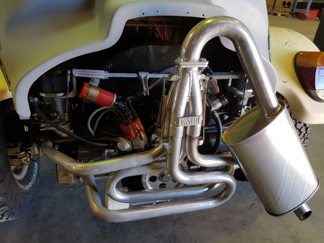

Well, I had trouble with pict34 getting it to idle. I don't think it's big enough for the motor. Understandable, as the intake manifold runners are very small. So I swapped it for some twin 40 dellorto's that I had to rebuild first. I also had to change to the aftermarket fan shroud as the original one was too wide for the dellorto's.
I've only taken it for a short drive as I haven't got a timing light or carb balancers with me.
But the straight cut gears sound great and it does go a LOT better than before already!
I'm finding out all sorts of things with this car. I thought I'd fit a new shifter bush. I bought 3 of them because I'd read that they wear quickly. Well my car didn't have one at all! Further reading I discovered the '59 doesn't have one, it's just metal on metal in there.
My new cheap sand seal pulley is warped, and the belt doesn't line up with the alternator any longer.
I've also fitted a camber compensator in the rear.
And I can see I have one small leak from the case halves right near the sump plate 🙁
