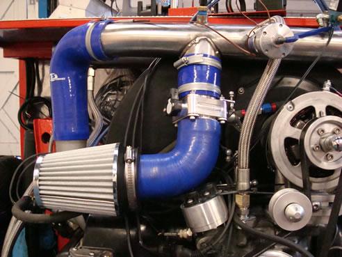

This was a mock up of a single throttle intake built with 2.5 inch tubing. Throttle response was bad and took a while to settle down to idle.
It was so bad I didn't even bother putting it on the dyno and switched to dual throttles.
A good rule is put whatever you want above the throttle but be careful what you do below the throttle
