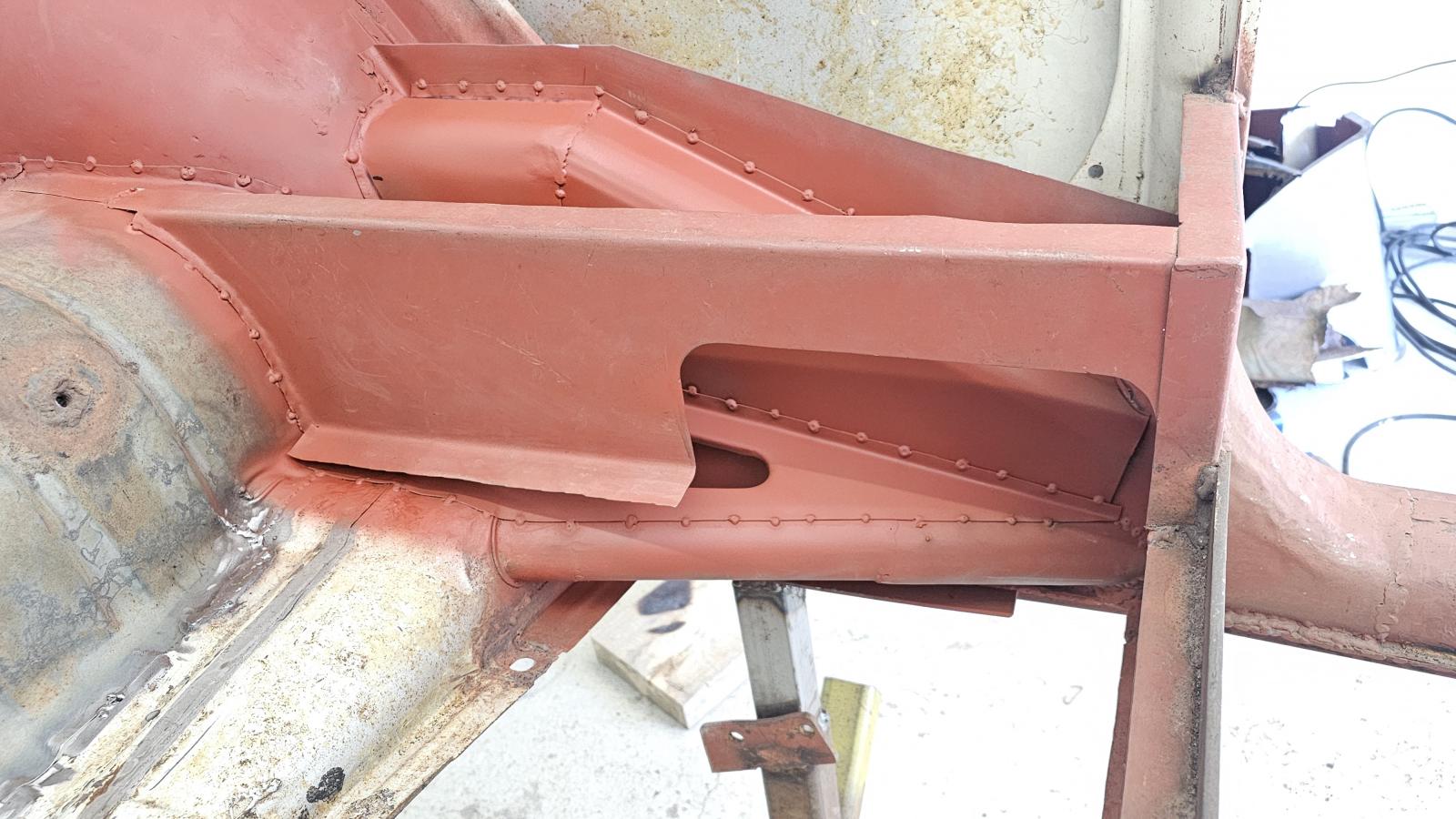

When the body finally was back in the garage after 15 years in storage in had to continue rustrepairing that....

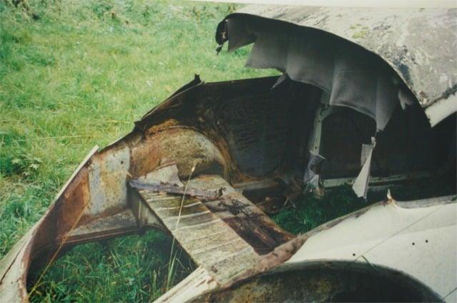

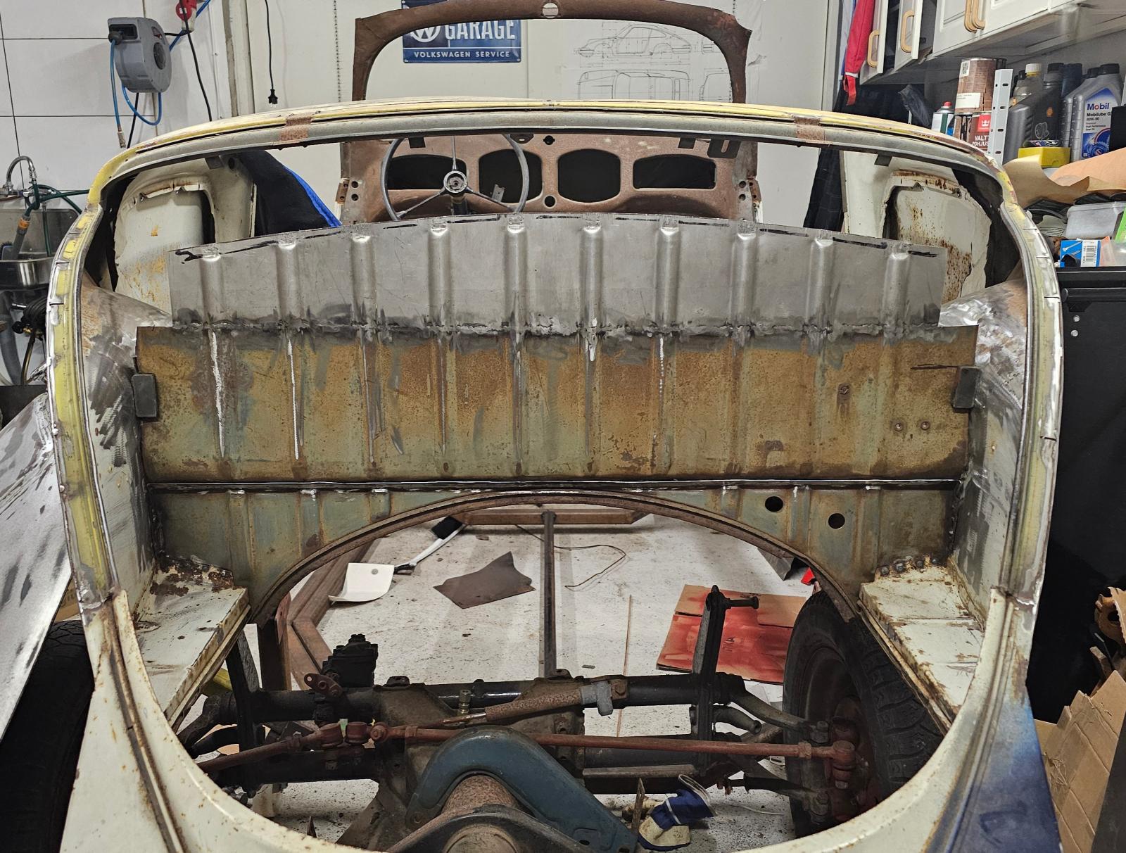

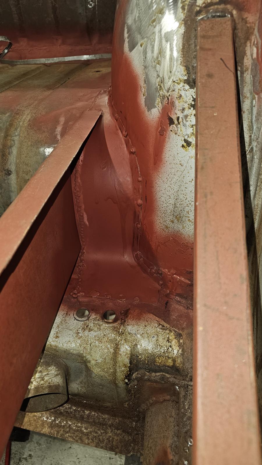

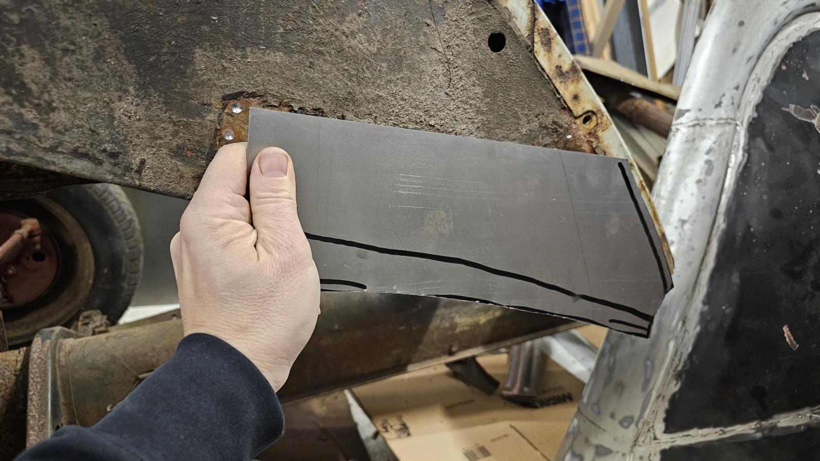

Also thought that the original firewall was salvageable...
This as it was when I saved the molested split body back in 1996...
But had to fabricate a repairpanel from scratch as it was cut too short by previous owner...

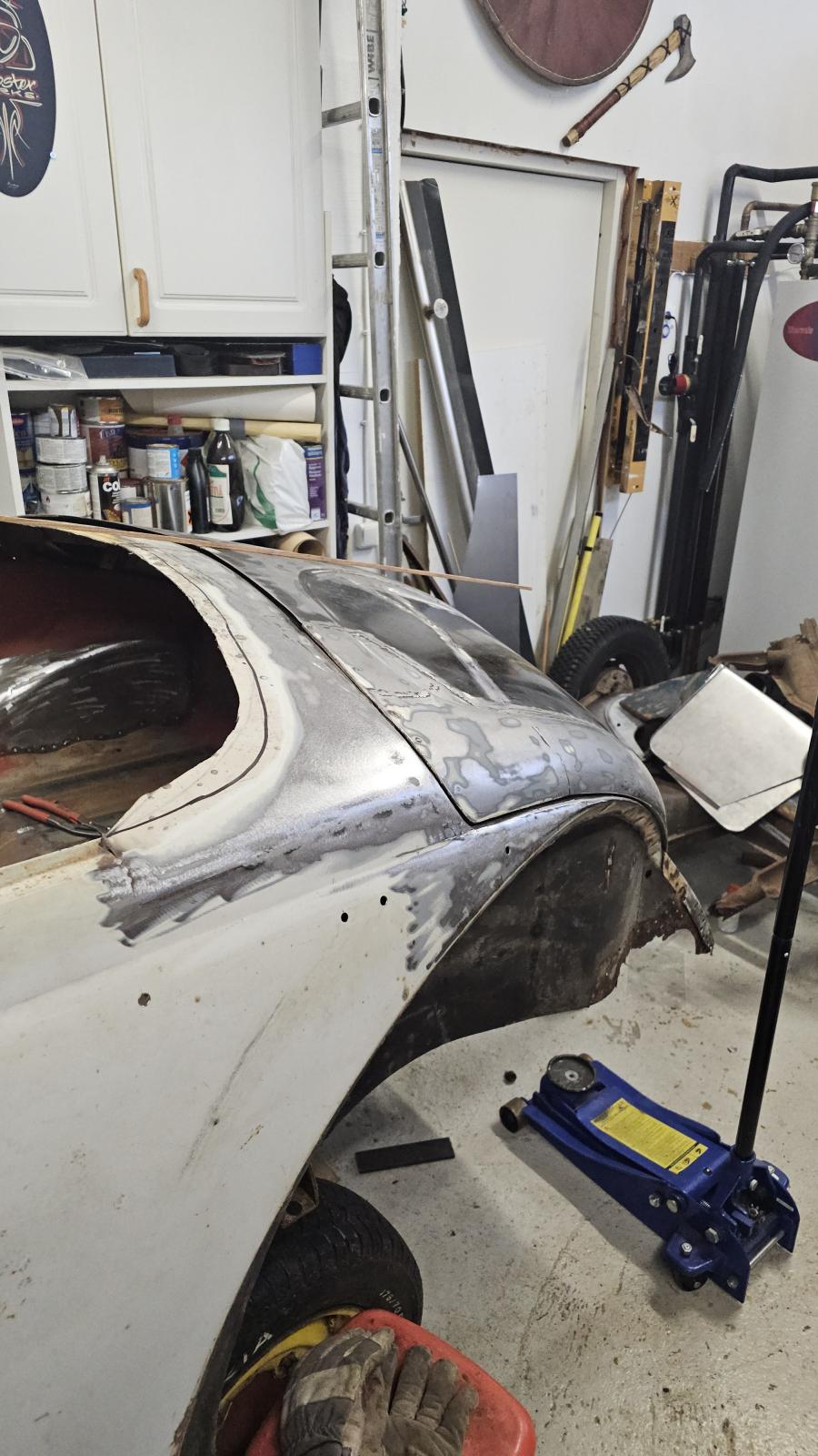

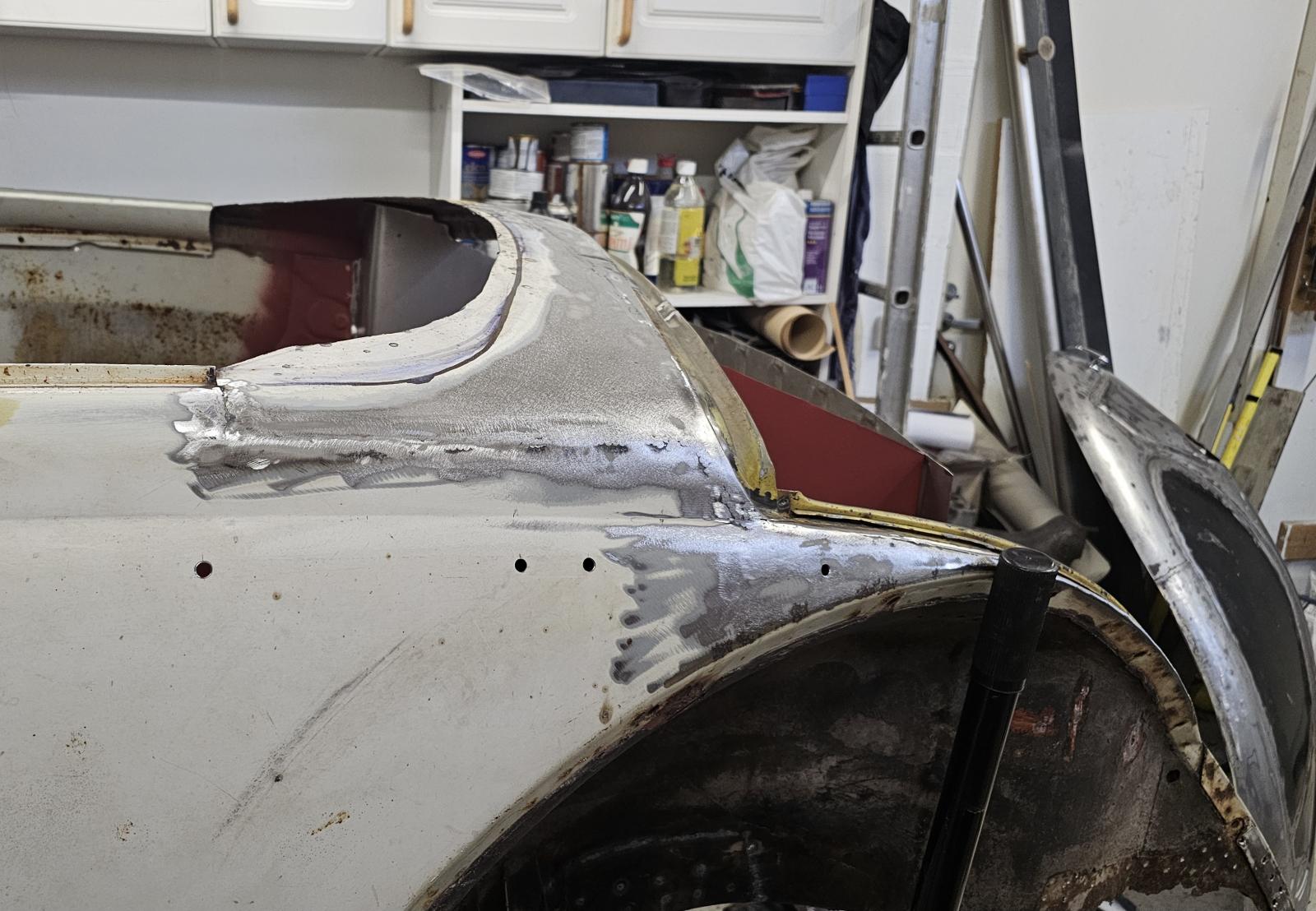

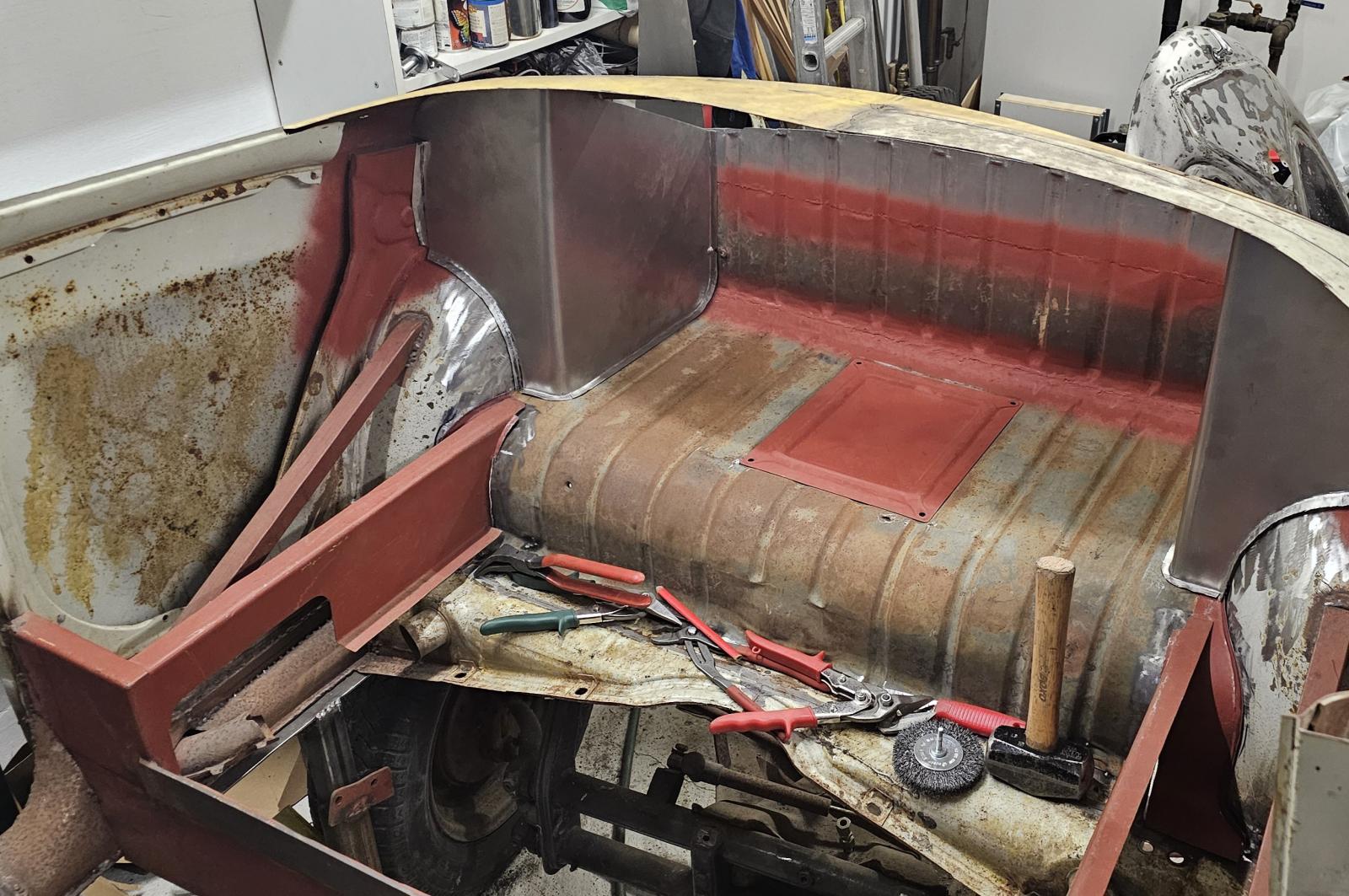

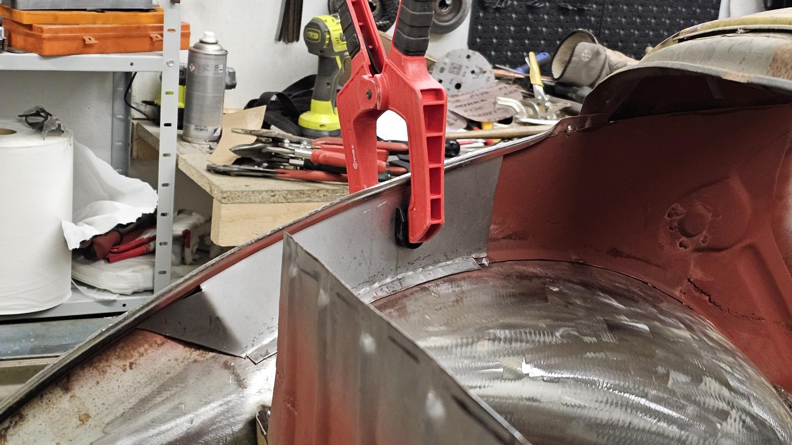

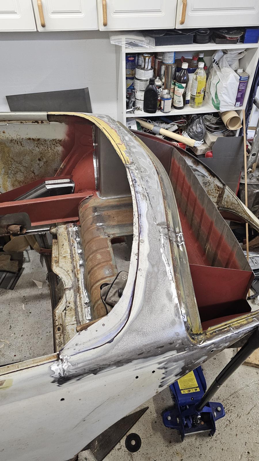

As my skills have evolved I could not live with my old rustrepairs on the rear luggage shelf front corners so I ended up cutting out the old and fabricate new patches..
These were a bit if a challenge to weld in as I had already welded the Hebmuller rearseat frame to the body...

At this point I'm fabricating the firewall supports and other details in and around the enginebay.
This was the short version of what have happened the past year. Now I'm busy with some other stuff for a week so no progress until February for now...

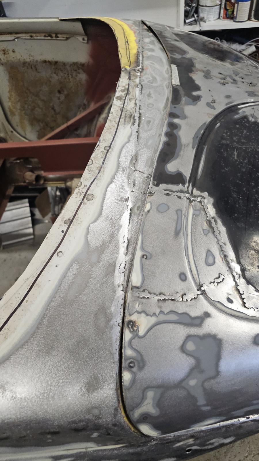

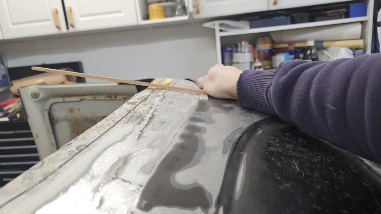

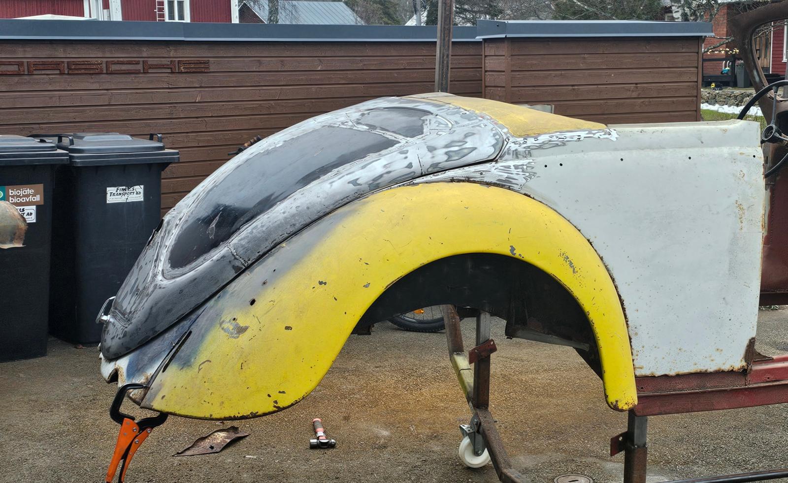

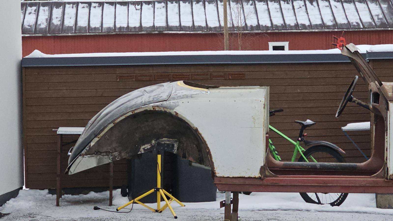

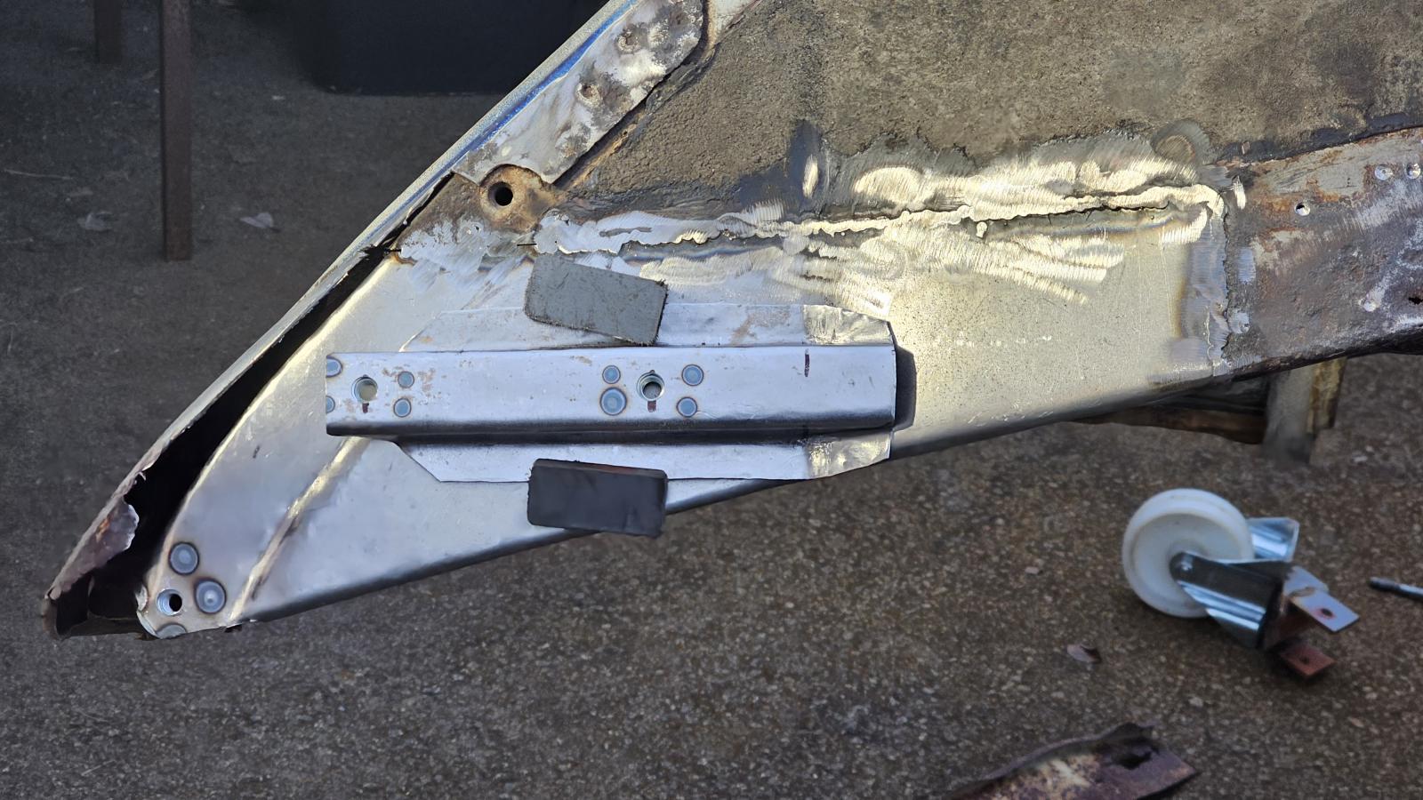

Was going to weld some today. Almost finished welding the 20y old tackwelded seams over the cowl. But ran out of welding gas before I could finish the cowl....
Just a few inches more....
Oh well... Starts to look so much better when the seams starts to vanish!

But why is it outside? Cleaning garage? :-)
Hebster
Posts: 305
Joined: Tue May 28, 2002 12:01 am
Re: My Hebster52
Post by Hebster »
Simple. I don't own a big shop to work in.
Just a small garage where I make all the parts and preparations. Then roll the body out when I need to weld the parts. I don't want to do the welding inside.

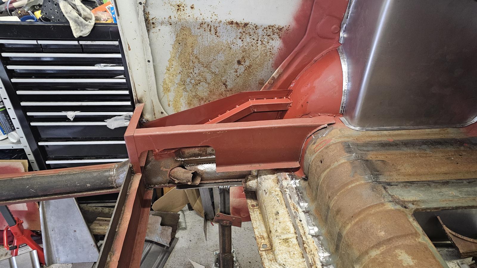

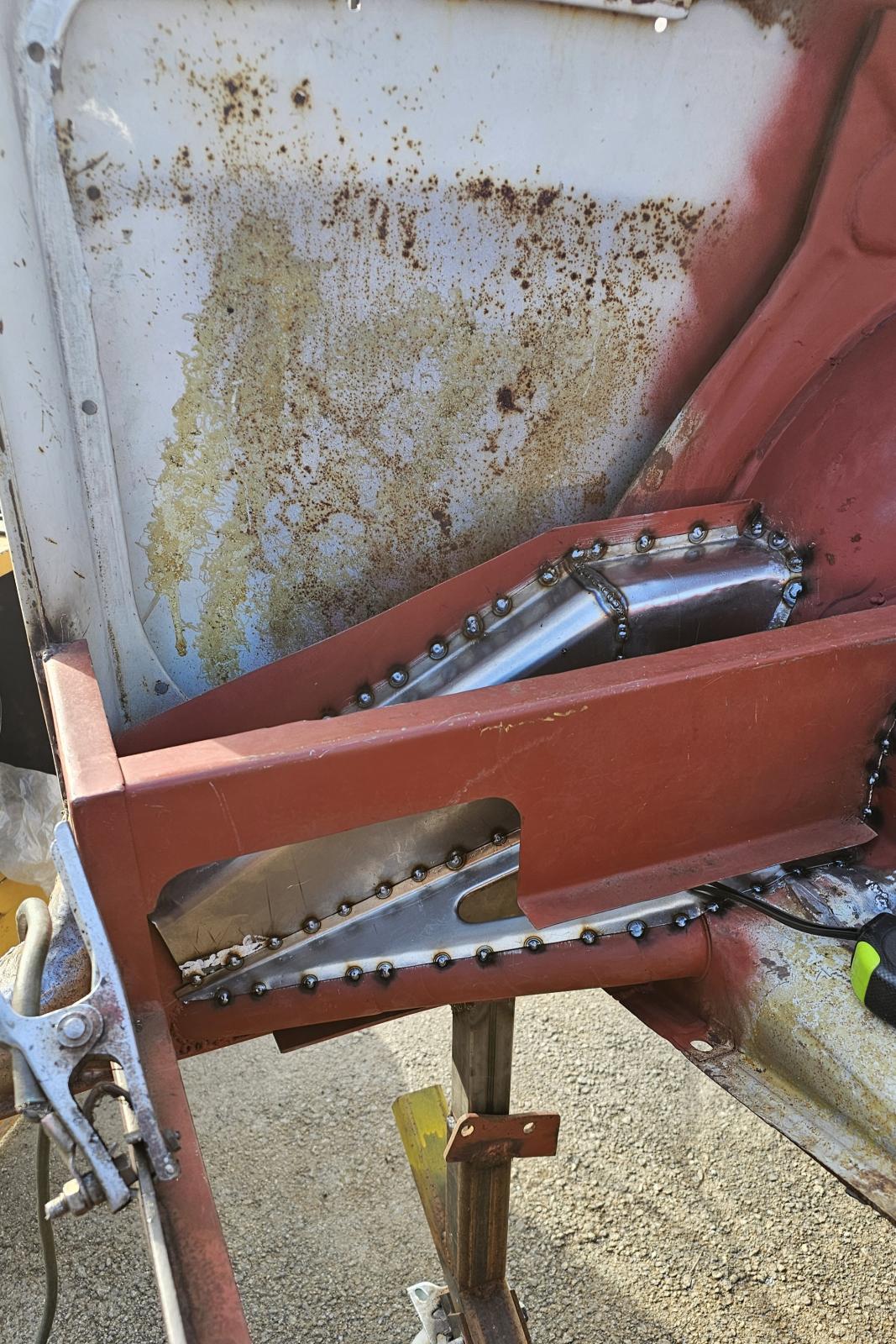

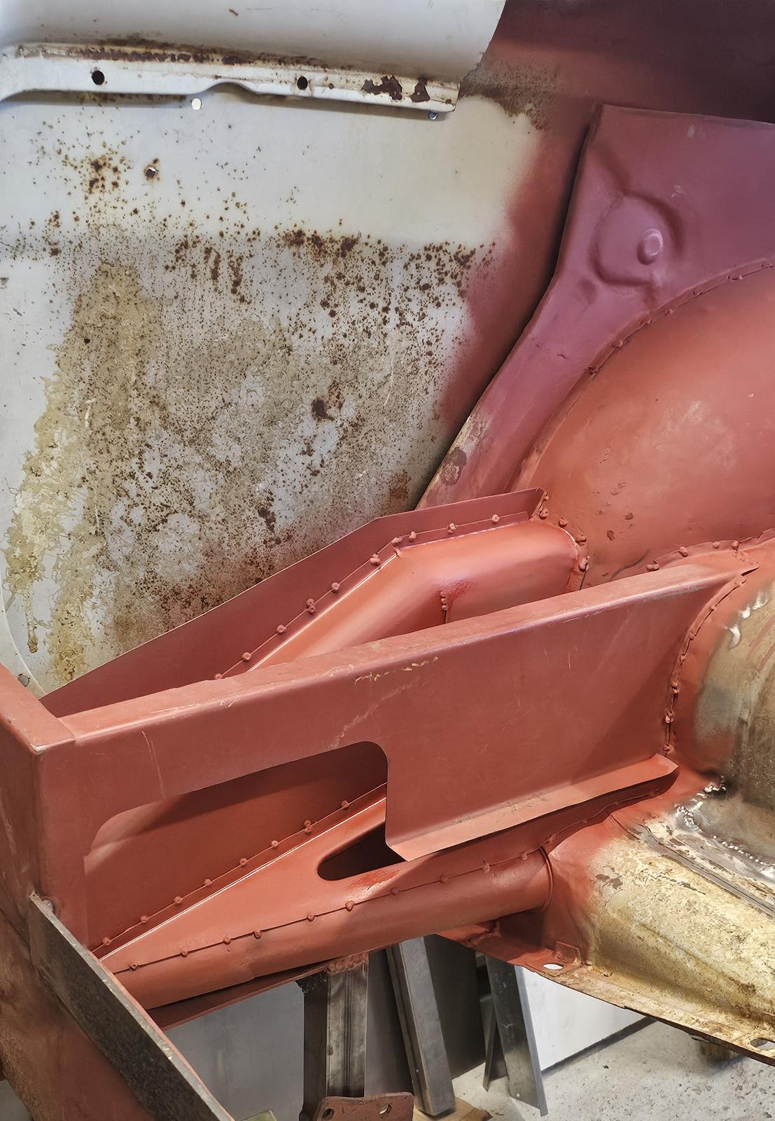

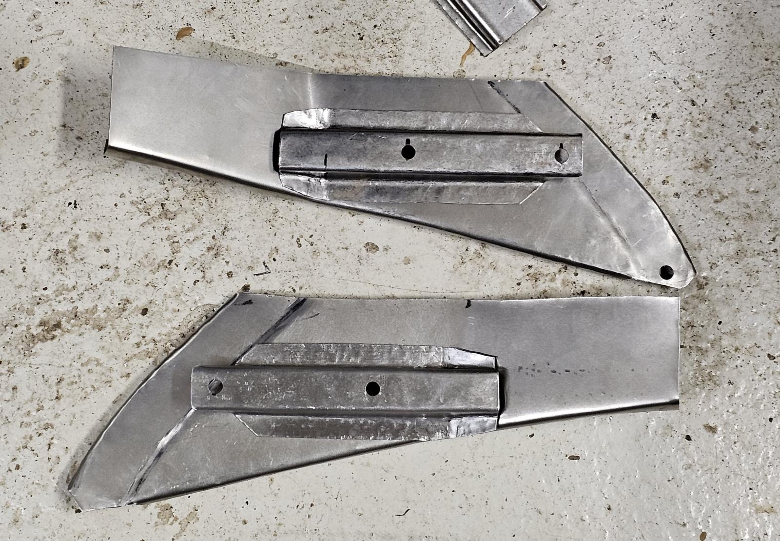

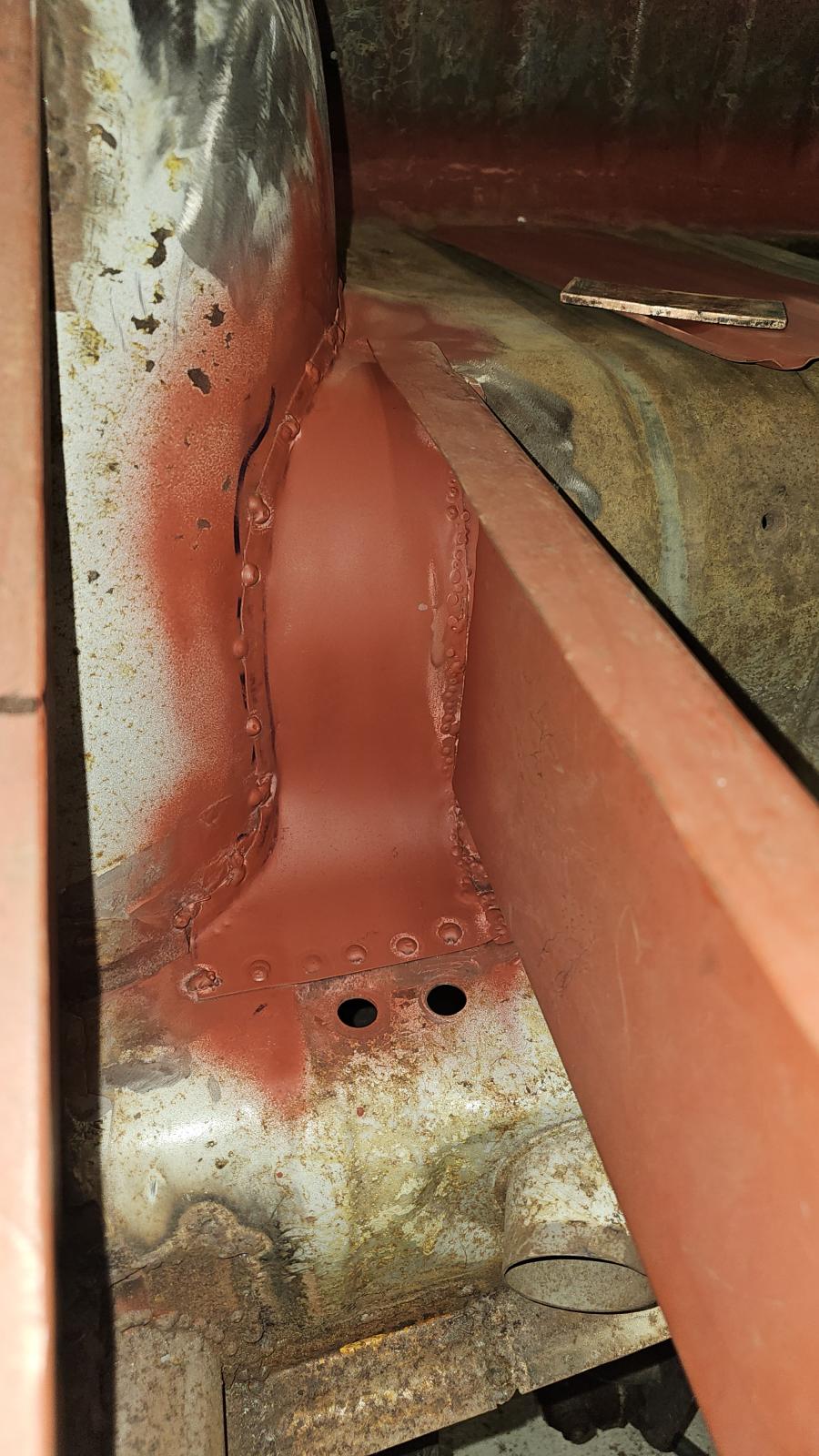

Yesterday I started fixing my old hackjob to delete/hide the square support tube with more hebmuller like box support. First welded in the backplate so i could cut the top of the square tube and angle it down so it fits inside the boxes.
Now I all I need to do is to adjust the panels before welding!
Also got the last welds finished on the top of the cowl

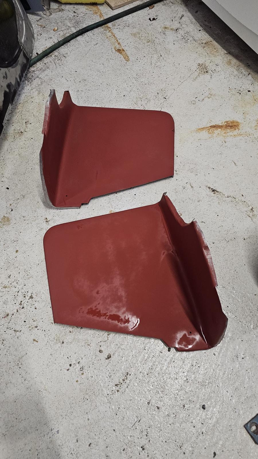

Also spent a few evenings to adjust the shapes of the top boxes for perfect fitment. Now they are done so I primed the insides ready for welding.

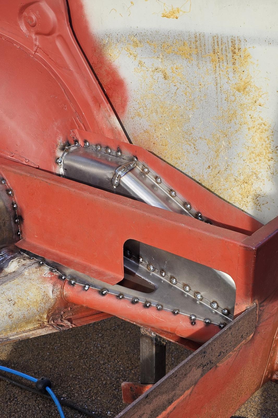

Major progress now closer to factory look when I got these assembled and fully welded!

Hebster wrote: Sun Mar 16, 2025 8:43 am Major progress now closer to factory look when I got these assembled and fully welded!
I love the detail here! Especially considering that a large amount of that work will be hidden behind upholstery later. Thanks for the updates!
