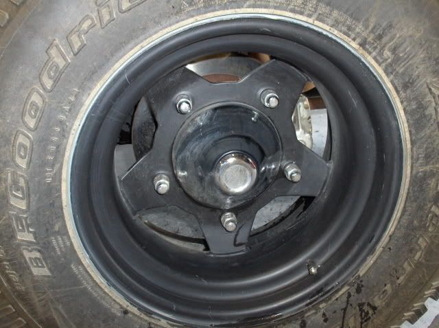

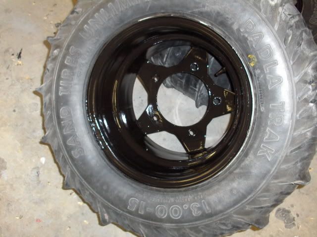

takotruckin
Posts: 3774
Joined: Tue Jul 18, 2006 6:40 pm
Post by takotruckin »
painted my paddle wheels this weekend. found out that if you thin the paint more, it will lay down real smooth. here is the freshly painted wheel(still wet, thats why its so shiny) compared to my beaten hard wheel that i painted over a year ago
