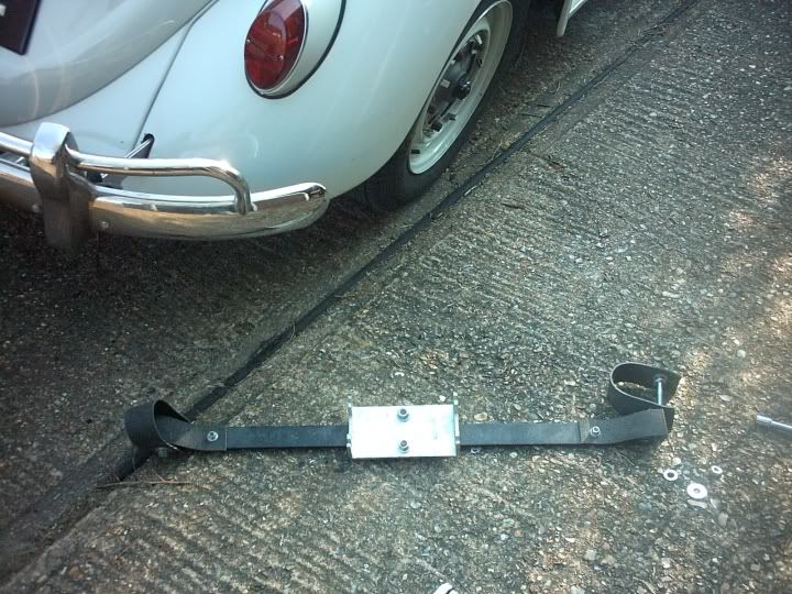

I bought it a few months ago, not new and fitted it yesterday. But how do I know if it's the correct one for my car? It's a '61 Bug with 1500 'box and short axles.
It bolted up with no problems by the way.
Gareth
It should work on any swing axle type car.

I tried one of those in the early 80's on my old swing axel and didn't like the feel so I ended up using a stock Z bar with flop stops to limit the wheel tuck.
As I recall the ends of my camber devise were diferent and rubbed through the axel tube paint quickly. Check yours in a month to see if the ends are rubbing the tubes or not.

The only difference would be the center mount , if yours bolted up ok to the trans , your good to go . The reproduction compensators may not have the different center mounts , for different models , like the original Empi one did .

One thing I'd change.... note that the mounts to the transaxle are "U" shaped - meaning you loosen the bolts, slide the mount in place and tighten the bolts. This will not stay on under repeated heavy usage - the brakcet WILL slide off the bolts no matter how well or how often you tighten them. I know that for a fact because I had one come off - causing a vehicle destroying off-road excursion at Willow Springs. I'd checked it before the session, and it took 5 laps for it to remove itself. When I built my next racer, a 64 Ghia, I had washers welded to the bracket just to make sure it couldn't slip out again.

ericsbracer wrote:I had washers welded to the bracket just to make sure it couldn't slip out again.
I hadn't thought about that :shock:
If I weld washers to the bracket it means I won't be able to take the camber compensator off, this could be a problem as it's covering the drain plug!
Do you think I can remove the studs from the gearbox and replace them with bolts?

Only have to do bolts on one side, you can leve the studs on the other side.
