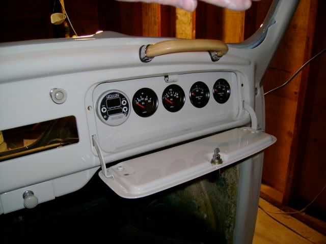

why not something like this, i didnt have to cut the radio brace

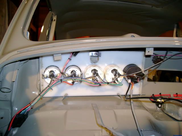

heres mine i just got done with.

Both are very clean installs. How did you mount the glovebox plate? I used two coil mounts (perfect fit for the gauges) and bolted one down without needing any additional mods to get a good fit. The other I bent the ears together to make it stand off of the trunk floor higher. I sandwiched an L-bracket in between the bent ears and bolted that down. I have oil temp at the top left and oil pressure at the bottom right side of the grill. Once I get the ears welded back on the grill and fire the camera up I take some pics. I did notice the taller bracket does vibrate so I'll have to dampen it somehow.

the bottom slides in between the little glove box "bracket" thingys and the top uses the stock screw and j-nut.
