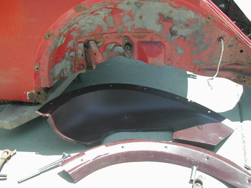

I'm using Jason's 1967 restoration project as a guide. His photos show he does a lot of lap welds with sheetmetal screws. I'm getting my nerve up to replace the wheelhouses on my 1967. The photo is of the good side. The other side it quite bad but I don't have a photo. My plan is to cut out much of the old wheelhouse with a jigsaw and lap weld the new piece in. How much overlap is recommended? Half inch, one inch, two inches? Do you weld both sides of the overlaped metal?

Usually, when you lap weld, you would use a flanging tool. This would eliminate that small step. Looking at your pieces, I think they were made to be butt welded.

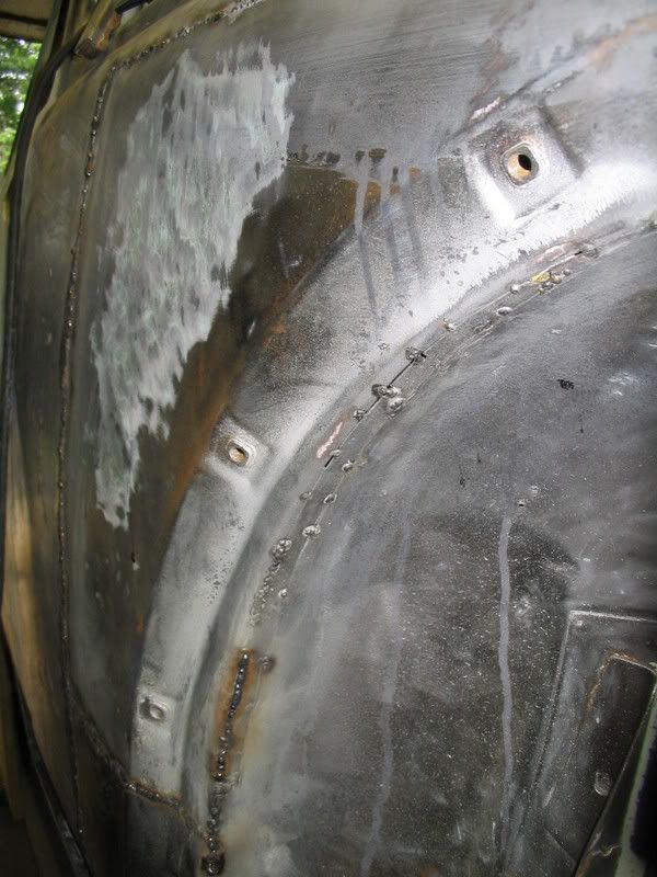

I did this section using butt welds...
You can see were I goofed, I had to add a 1/2" piece of metal because I cut to much away. It just gave me that much more practice
Also, remember to look for those sneaky spot welds. There are a few in the wheel housing.
I don't know if you have the capabilities, but, I used a 3", thin, cut-off, disc, mounted on my air die grinder, to cut out what you see above.
take your time, you'll get it
pete
