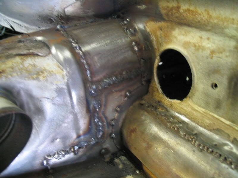

Post some pics of the bad areas. I recently did some repairs in that area, using just some metal I had laying around.

The area in your pic where you have the new metal welded in is about where my problem is. Right where the heater channel ends and is normally welded to the crossmember it is rusted through to the outside of the car. --through the wheel well. Both sides are the same, the crossmember is rusted out and possibly a piece in the wheel well on the outside ?

http://i77.photobucket.com/albums/j47/k ... CN2913.jpg
This is what I see after putting a new heater channel in. I assume the cross member is welded here. Pretty much needs to be a body-off job from what I can tell.
