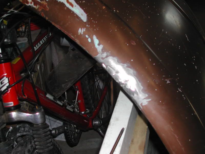

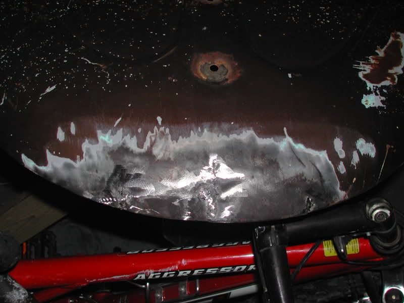

I can't guarantee I haven't screwed up the photos again. But here goes. I'm ready to chop off the old front clip and weld the new one on. I put the front hood back on to use as a guide fof alligning the clip. The old hood has deep cracks on either side 3/4 of the way down. I assume from the springs binding when trying to close the hood. I welded the cracks. The metal had been eaten away by rust. So I'm wondering what I could do to stiffen the hood. Maybe mold a bunch of bondo along the inside?

What you will need to do is cut yorself som metal strips and weld them on the inside of the hood where the cracks are. If you have 3" strips mark 1 1/2 and put that line where your crack is, that way it overlaps evenly for support. Bondo will give you no support at all and will pop out as soon as you close the hood. 73-87 chevy pickups also had this problem.

Thanks for the replies. What guage metal for the bracing? I've got a lot of leftover metal from items I removed, like the old luggage rack, but that metal seems soft. Also, what about the springs? I've owned over a dozen vws in the past 30 years and I don't remember any of them creaking so loudly whenever I tried to close their front lids.
