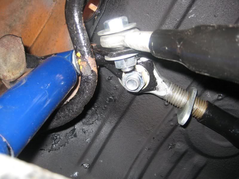

Post by MRRAGPICKER »

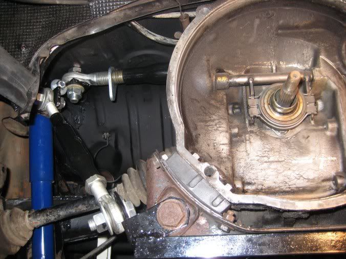

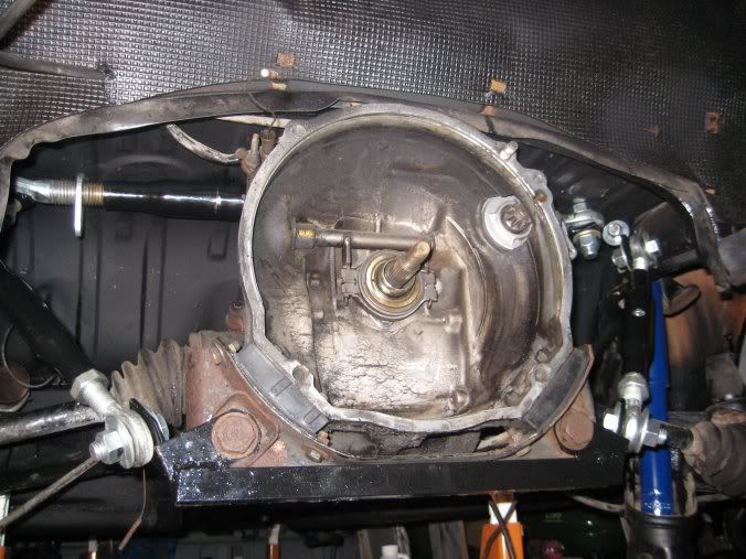

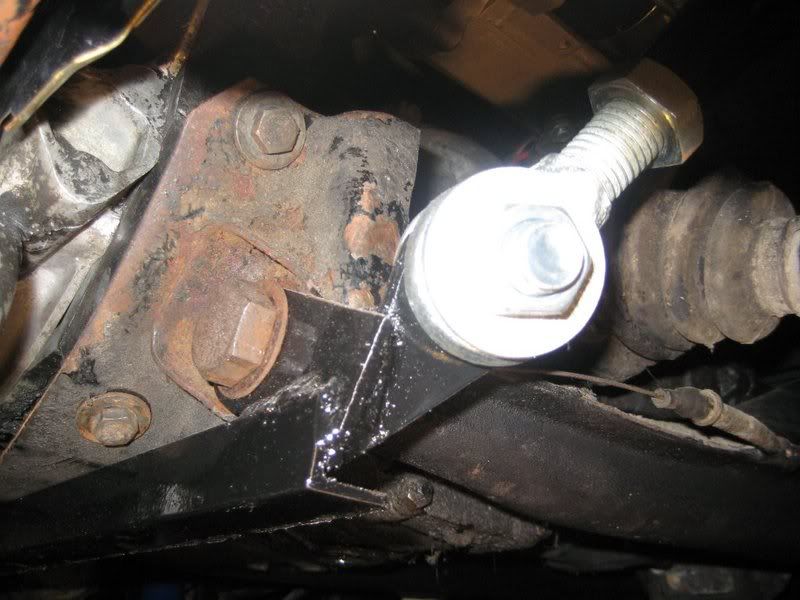

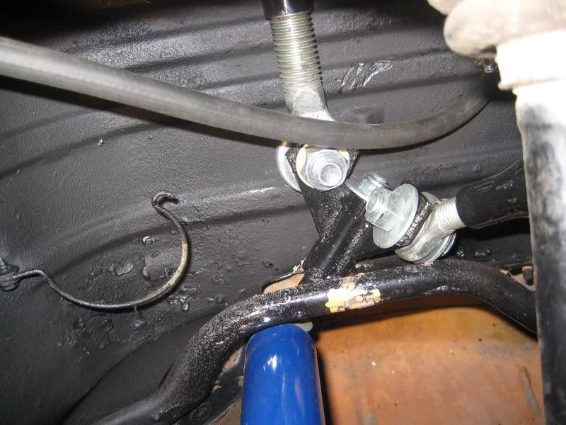

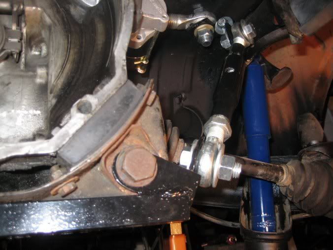

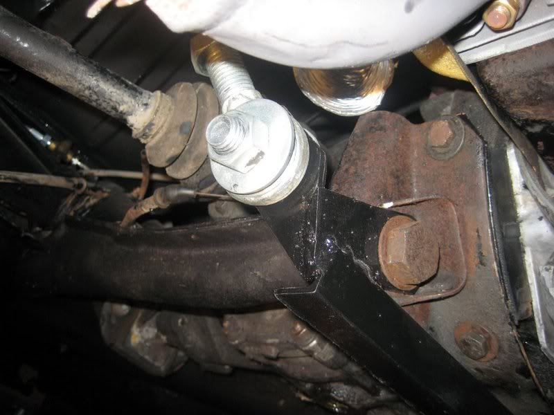

At the shock towers I used 3 x3 x 1/4 angle. I welded a section of 1/2" pipe
along the length of the angle, like this \o/. I then ran a 12mm x 6" long
bolt through the shock tower, the shock and through the 1/2" pipe and put a thick washer and nut on the back. (The passenger side shock bolt is 8 inches). I have one leg of the angle horizontal
and the other one vertical. I drilled a hole in each leg of the angle for the
link bolts to go through. At the trans mount I used 3/16" plate. I made four tabs & drilled a hole in each. Two of the tabs bolt onto the trans mount horns. The other two are welded to the first two for the links to bolt to.
I also welded a 1x1x1/8 angle between the two tabs on the trans horns, for added strength.
I have about 90 bucks in it.
