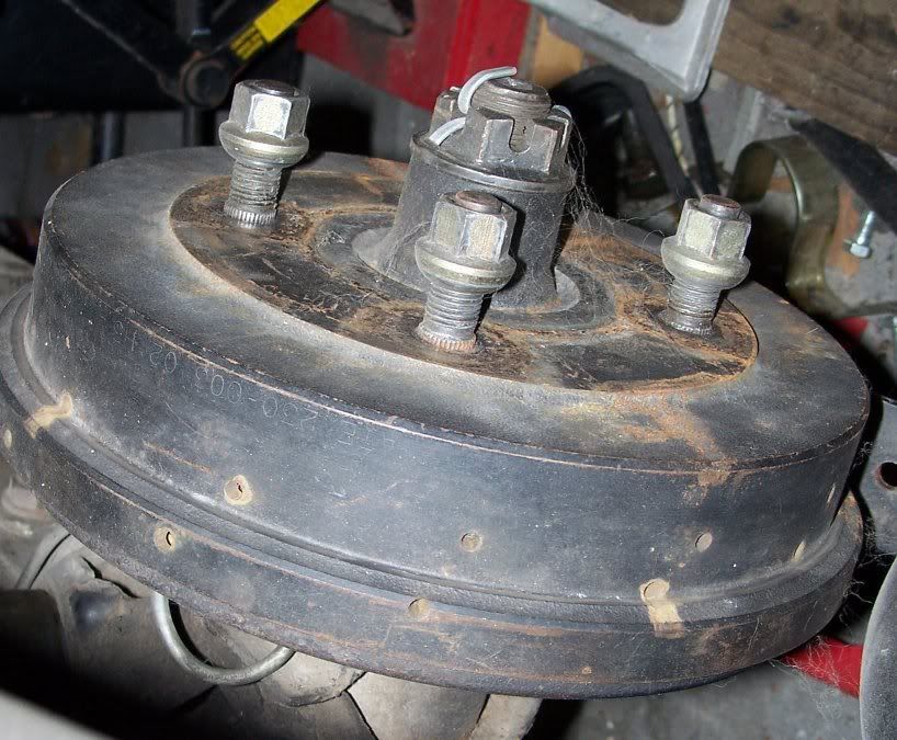

Disk brakes, racing pads, etc., are for hard sustained braking. The big trick is to have CH Topping http://www.chtopping.com/hotvws/ drill your front drums and you'll have sustained braking too.

Thanks FJCamper, I was hoping you would chime in on this. Ill look into the mintex shoes. About what does it cost to have your front drums drilled? Do you have a picture of one that has been drilled?

Drilled Drums
Hi Sbpickup,
Here's set of rears drilled by CH topping. About $50 to $75 for the pair, but check for the latest prices:
