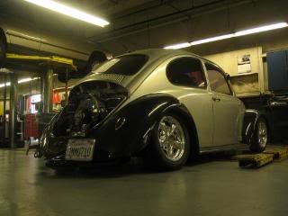

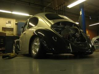

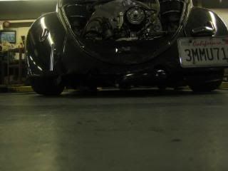

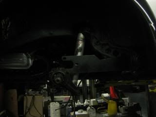

So I lowered the rear on my buddies 66. It sits too low for his liking. So I raised it one outter spline and it sits too high. He was thinking or running adjustable spring plates but was woundering if you have to notch them? never ran adjustable spring plates so I dont know. here are a few pics..

Setting preload
http://www.shoptalkforums.com/viewtopic ... ht=preload
VW recommends the following for stock bugs and Ghia’s:
17 degrees 30 minutes for short swing axle
20 degrees + 50’ for 67-68 long axle and IRS
The outer spline has 44 splines. Moving it 1 spline will move the axle approx. 2-3/8"
The inner spline has 40 splines. Moving it 1 spline will move the axle approx. 2-9/16"
Now we see that moving each spline in opposite directions, we can make a change of as small as 3/16" This is where the infinite amount of adjustability comes to light. You can "dial in" almost any ride height you wish (to a limit). Remember though, a change of 2-9/16 is a BIG difference, and the ride quality will suffer if taken to the extremes.
Info found here.
http://www.airheadparts.com/page.asp?recId=76
I thought this info would be good to know even though it is for lowering a stock bug.
