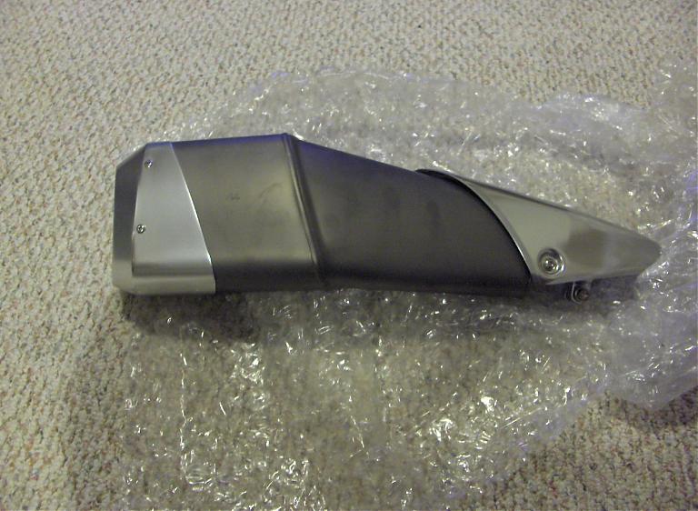

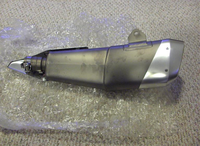

Well, the time has come where Dad and I can certainly agree the Monza style-exhaust has no place on the car, aka - the first substancial exhaust leak
So anyway, I'm preparing to play with an idea I've had for awhile. We've got some FI heat-exchangers & manifolds from my first `77 - and I'm planning on creating a 2-1 header with 1-5/8" leading to 2" oval-tubing routed under & around the engine to tuck a 750CC GSXR muffler under the appron somewhere. Thinking a 1600 w/stock cam is the largest engine it'll ever see. Stock photos:
