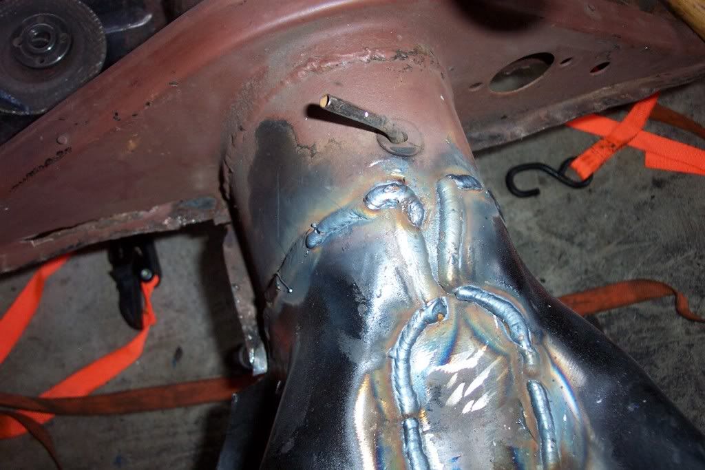

I welded on the new frame head. I had to split the back of the aftermarket thing just to get it to move down low enough to fit properly
It took forever to figure out that was the problem.

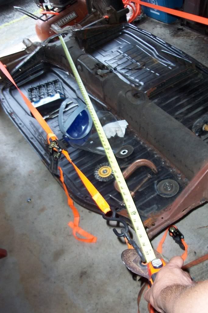

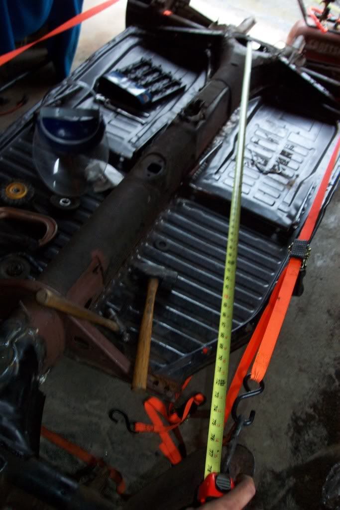

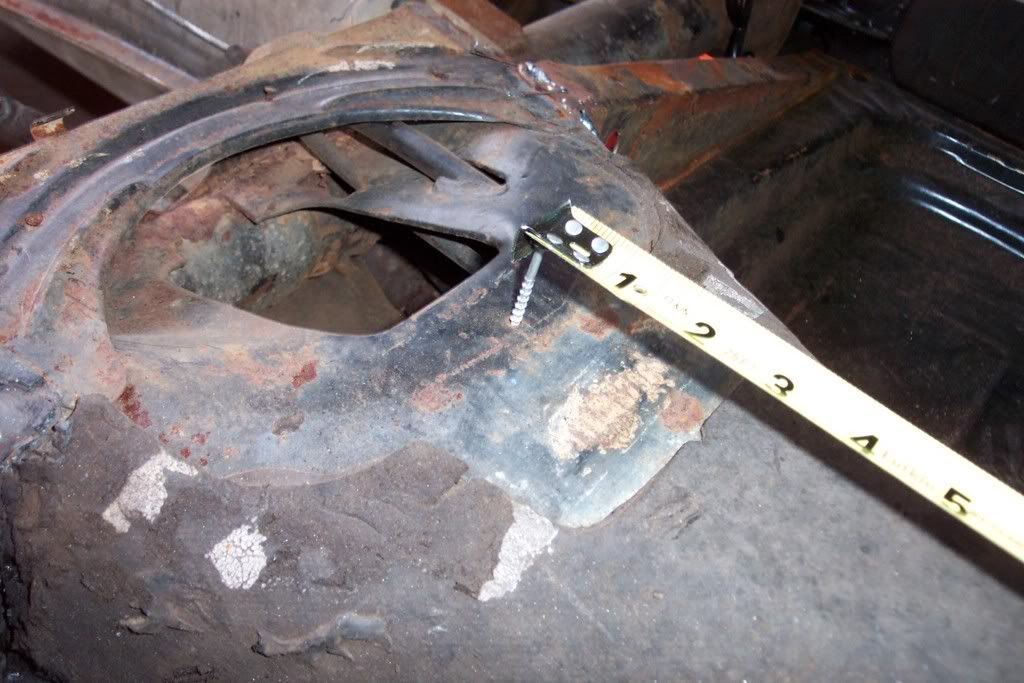

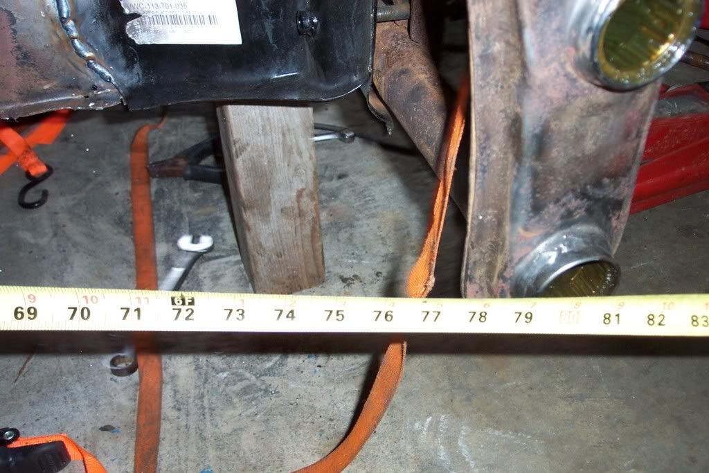

I took my measurements from a common point at the rear inspection plate
I measured to each shock tower
and then I measured to each tube
once all these measurements were correct, I put a level on the beam and welded it up
