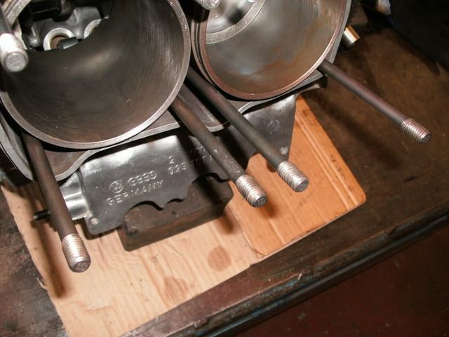

Here's a pic of the cylinders.

Cool... what engine? can they be machined in a lathe? spun cast normally cannot, has to be ground.... so I am told...

My part's pusher tolde Volvo truck or something . can check it out.
These are popoular cylinders used in some autocross engines here. and have not heard that they are a problem to machine??
almost all cast cylinders can be machined easily as far as i have heard.

fastback wrote:My part's pusher tolde Volvo truck or something . can check it out.
Hi. The jugs are probably from a Volvo TD70 Truck engine. Have been looking for someone selling used ones in Norway, but without any luck. Where did you get hold of yours, fastback? If you don`t mind to tell me that is :)

Its probably not TD 70 liners, since they are 104.7mm. These are regulary used in T4 autocross engines in Norway. TD 60 are 98.4mm. So its probably those in the picture. TD 50 have 95.25mm bore.

No problem machining these in a lathe with carbide tools. I have done it many times, both Volvo and Deutch liners.

yes it's the TD-60

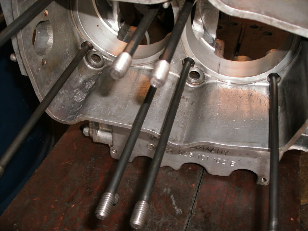

an old thread i know, but just seen it, here's the okrasa race kit studs as supplied for my 2500, these are 10mm, nos 8mm set as installed in my 2100 turbo for comparison.
Best regards, BBB.
