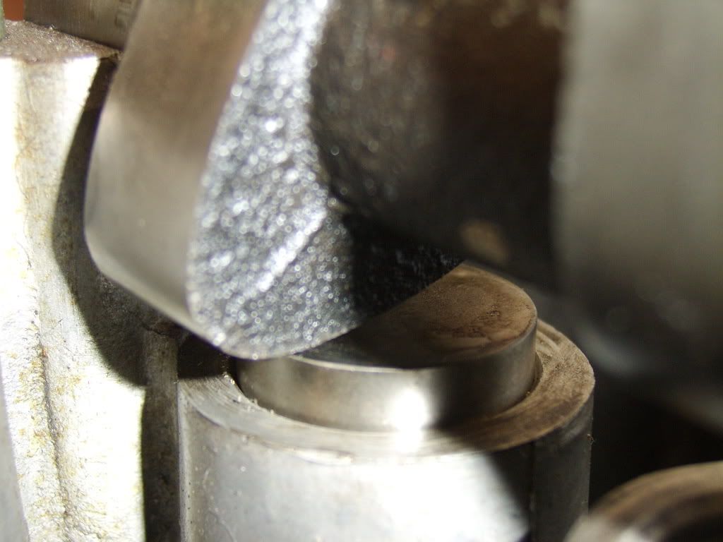

How does one get a replie even a sorry no experience with that would be Imageactually be gr8 :cry:
flag, here's a 120 on w/boxer lifter, not good..
and here's a C35 on a T1 lifter, i have run the C35 on solid w/boxer lifters, but in a turbo race car, i had no wear problems with that, and it did what i wanted it to do, but it had a dry sump system and oil jets etc, and only operated at high revs.

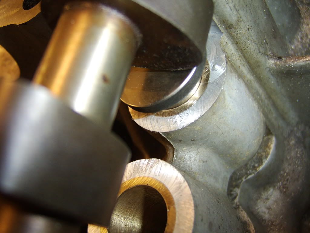

This is buildaBB's other pic. Really bad edge interference there, not a workable match by a long shot:

So the best would be to fit sleeves and use type 1 lifters
