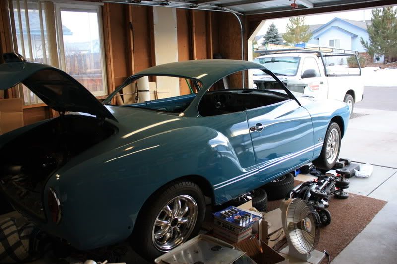

What Ghia's make up for with room in the engine bay, they really have so little room under the apron. I was laying under the car for close to 30 min trying to figure out how to fit all of the exhaust tubing up there and how to get it pointing in the right direction. Time to start ordering some tubing and collectors. Anyone know where to get some thick flanges for the heads??

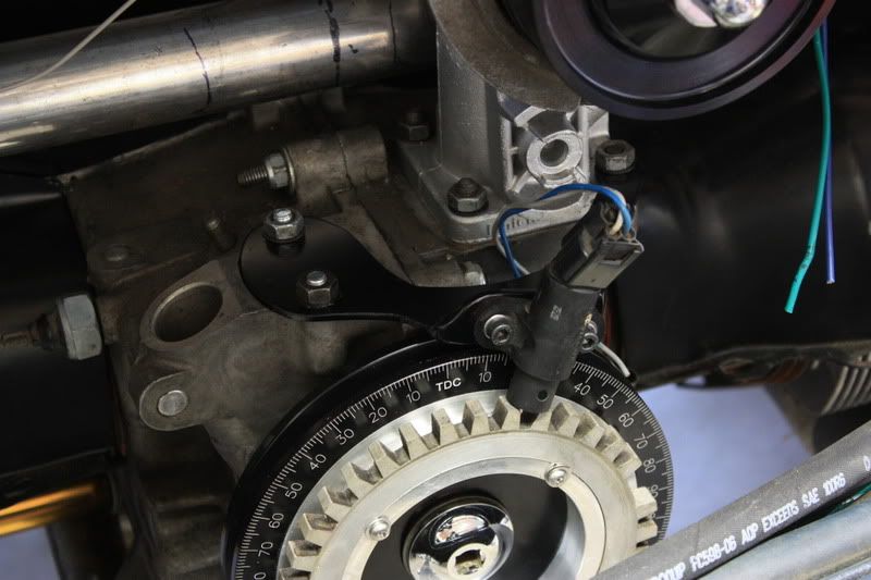

Made up a bracket for the crank sensor.

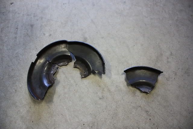

Decided to go with a billet aluminum pulley as this is what happened to my last steel one. Don't need this happening again.

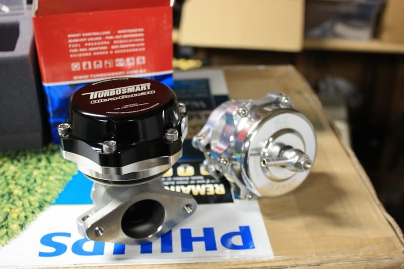

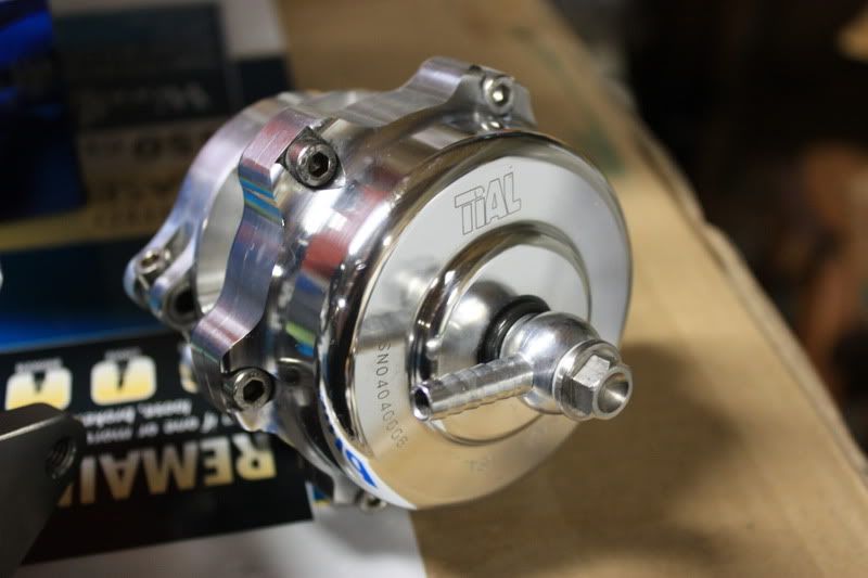

Special Thanks to Marty Staggs for the great deal on the wastegate. One of the best quality parts I have seen in a long time.

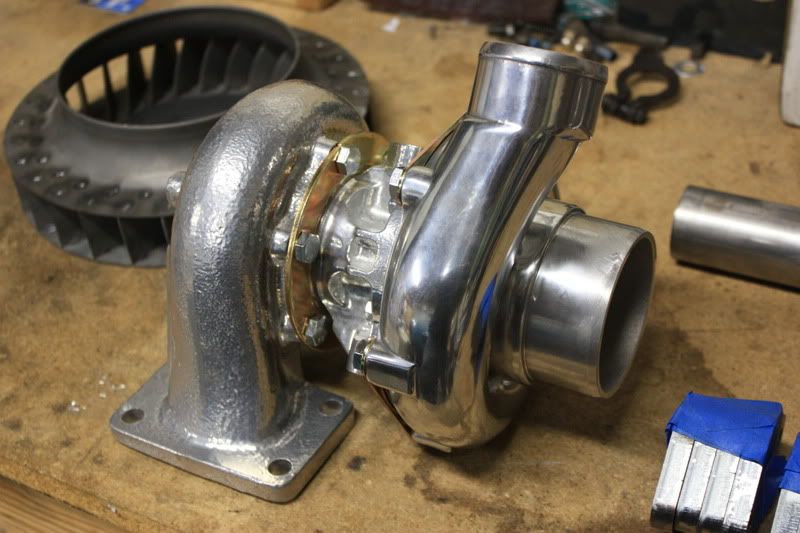

t3/t4 stg 3 V-trim

What's the trim?? Looks similar to mine.

WickedWagens wrote:t3/t4 stg 2 H-trim
Time for Lens Crafters, you been staring at too many hoses. :lol:
Naa, I just didn't dig back thru the pages.

Hotrodvw wrote:
Don't worry, I just added that after I saw your question. :D

It's a stg3 with a v trim :mrgreen:

I'm going to run a T3/T4 with a H trim exh. wheel, and a P trim comp wheel.
